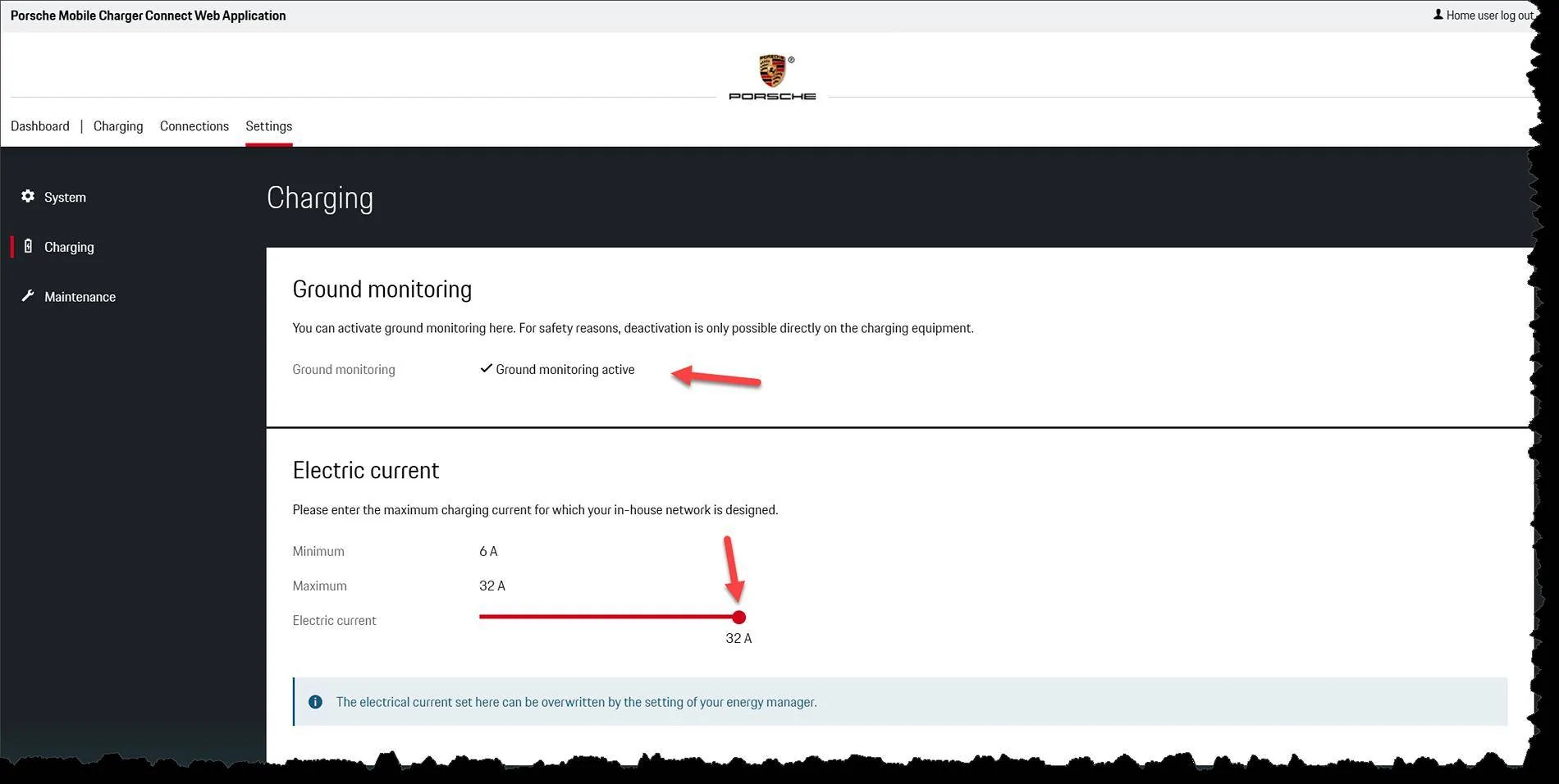

Thanks for all the replies guys. I changed the amps from 6 to 8 with the configuration on the charger. That did the trick. I got about 20 miles of range for that overnight charge. Obv not ideal but I needed a quick top off as I never charged the car yet. I will be looking into the emporia level 2 charger as recommended. I have an electrician that has done a few of these installs in people’s homes by me.
Is the consensus to use public chargers when possible like electrify America over any at home chargers?
Yes, I was going to say, all you need to do is up the amps to 8. It is a good emergency charger when 120 is all you have. And no, the best solution is a Level 2 home EVSE, 240V with 32 Amps minimum. That will do the trick overnight and is easy on the battery. You can use your $1200 Porsche one, or another plug-in one, as long as you have good quality 14-50 plug (Hubbell or Bryant, $80-$100). Even better is to hardwire a third party box. Grizzl-e, Chargepoint Flex, Evoria, Wallbox are good.

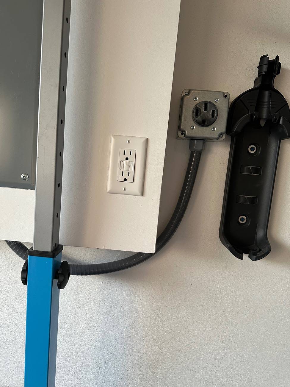

House is only 5 years old so should be up to code for all this. Pretty much every other house has an EV and a few taycans in the neighborhood as well. I have an electrician who’s done these installs for other people, but I’m not sure if he just buys some Home Depot off brand 14-50 outlet so I want to supply the correct one.
on the Hubble website they don’t seem to have any right now. Only selling Bryant. The Amazon reviews seem to say it’s a lot of fakes from China
thanks for all the advice

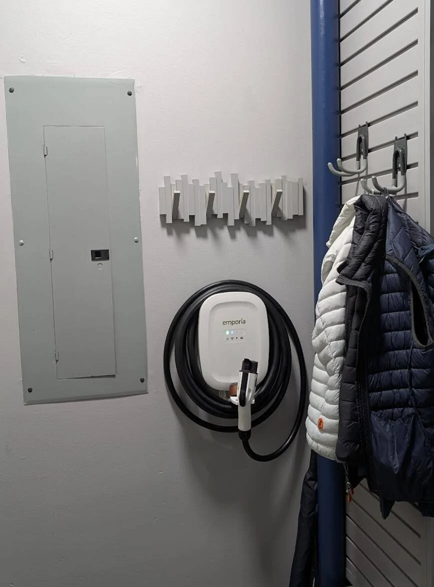

My direct wire was installed in no time by the electrician and for very low cost, since the copper is very short and goes directly from the panel behind the wall into the EVSE. No Hubble sockets or messy tubes and extra wires. 25ft cable can reach 2 cars parked next to each other.

I understand that and yes I prefer the clean setup like I have. $500 not worth of looking at a mess 100% of the time.

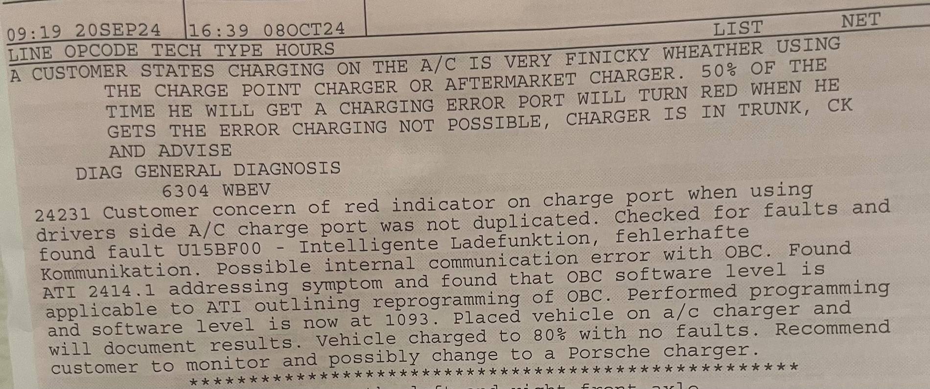

I use the same charger as the OP. I have a 22 RWD Taycan that I bought new in March of 2022. I had zero charging problems (I mostly charge at home given my solar panels that produce a lot) until a few months ago at 24K when I had the same "charging not possible error." I also btw have a Hubble outlet. I brought my vehicle in and it was fixed after a software upgrade documented here. Now at 28K miles and it's still charging beautifully at home.

Ok electrician coming Monday to install a Bryant 14-50 socket $450 cash.
he did my neighbors setup as well as many others around here.
also just had my calipers done figured I’d show them.
