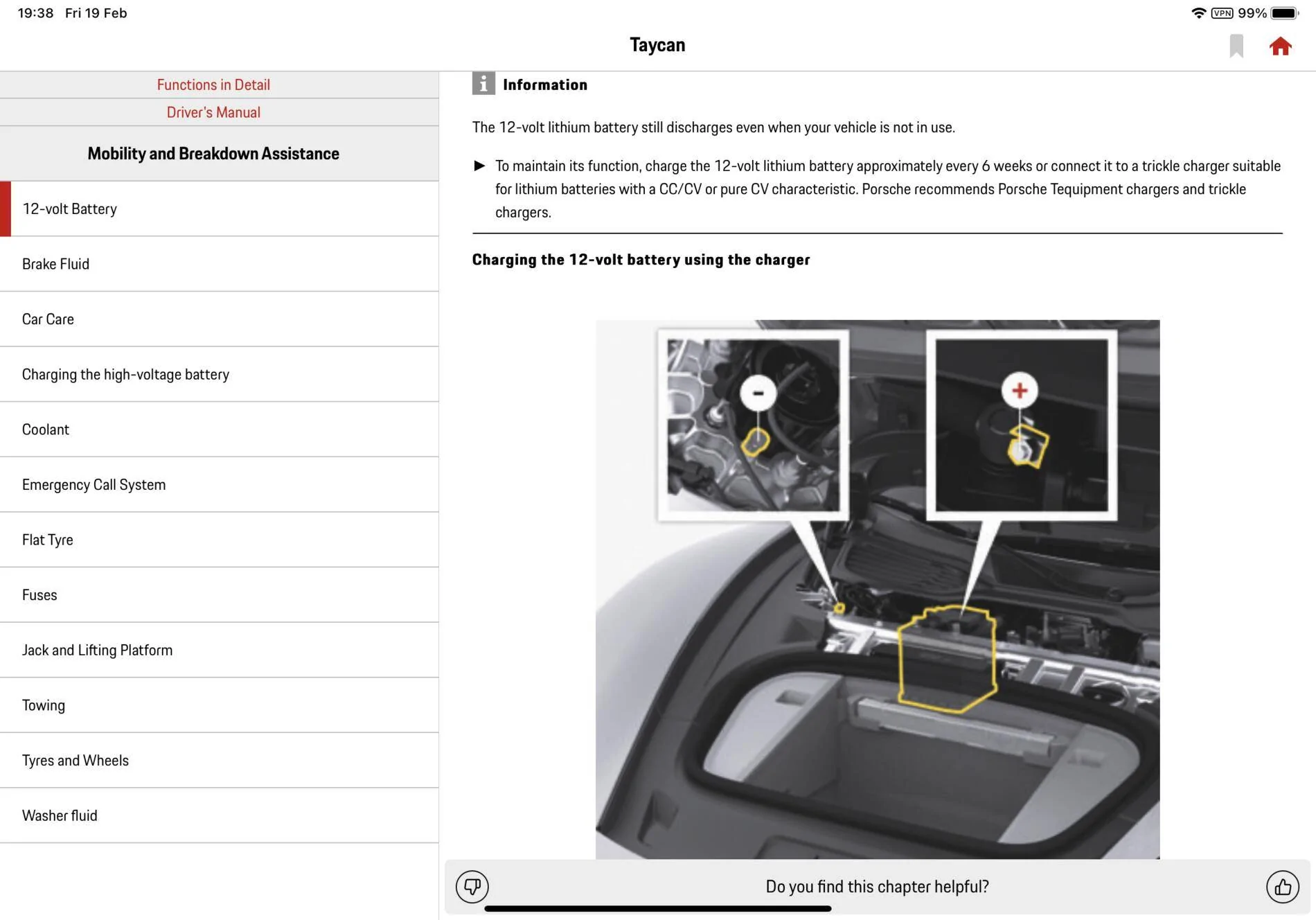

3,907
3,552
ummmmm - I seem to recall porsche specifcially recommends against using a trickle charger with the Taycan - but I can’t find the posting on this forum where a kind soul quoted chapter, verse, and screen shot from the manual.
Well the Porsche Good to know app says the following! For long term storage but can certainly be used otherwise as well
Porsche Taycan Dead 12v battery again BFEBFA52-978F-4845-B704-3D6979AC4D2F

Charge o mat i think is to keep the battery maintained and can’t be used to jump start a car
Yeah, I don’t see how that can be used to jump the car. Also does seem to solve the issue if you aren’t near an outlet. I live in a condo and don’t have an accessible plug for something like that. I have the Noco but heard it can be a safety hazard to use.
