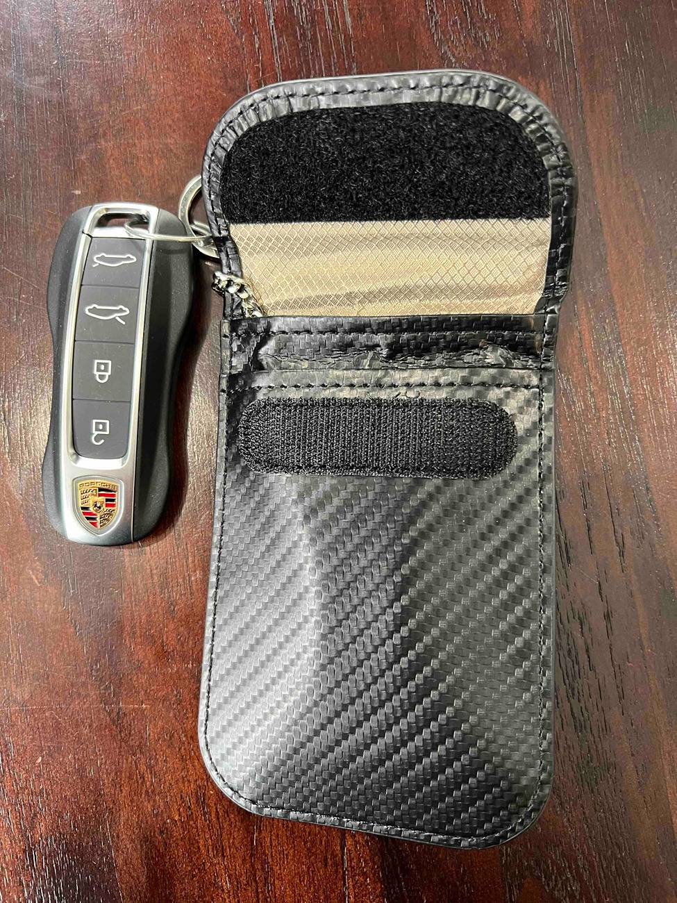

Your key fob will communicate with the Taycan periodically (0 to ~75 ft line of sight - no obstacles). I suggest storing your keyfob in a Faraday bag. A Faraday bag can be purchased on Amazon. The cheapest alternative is to completely cover your keyfob in aluminum foil (when not in use) since it will block the wireless communication signals between the keyfob and Taycan.

completely cover your keyfob in aluminum foil (when not in use) .
no need for a tinhat, nor a faraday cage. If you have to store your key within range of the car then hold down the top two buttons for a moment until the lights flash; the key is then disabled until you press a button.
But in any case I thought modern keys go to sleep if not moved for a while, to stop relay attacks?
Delayed sleep features on key fobs don’t provide uniform protection, as manufacturers set different sleep times. Forgetting to activate manual fob sleep can leave you vulnerable to relay attacks. To safeguard my car, I store my key fob in a Faraday bag after locking the doors. Before getting in, I take the key fob out of the bag. Be aware that an experienced thief can relay the signal from your key fob with just one transmission. Currently, there’s no foolproof method to prevent relay attacks. As a precaution, consider using a physical key to lock and unlock your car, then retrieve the key from the Faraday bag when in the locked car.
Here is a link to an article on the topic: https://www.whatcar.com/news/more-car-models-get-sleeping-key-fobs-to-combat-keyless-theft/n20439
