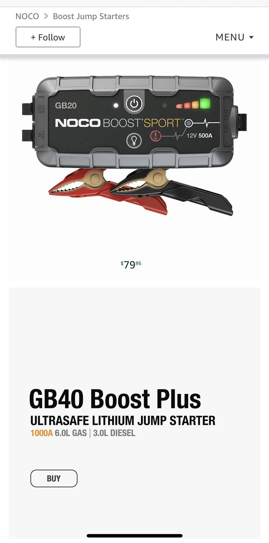

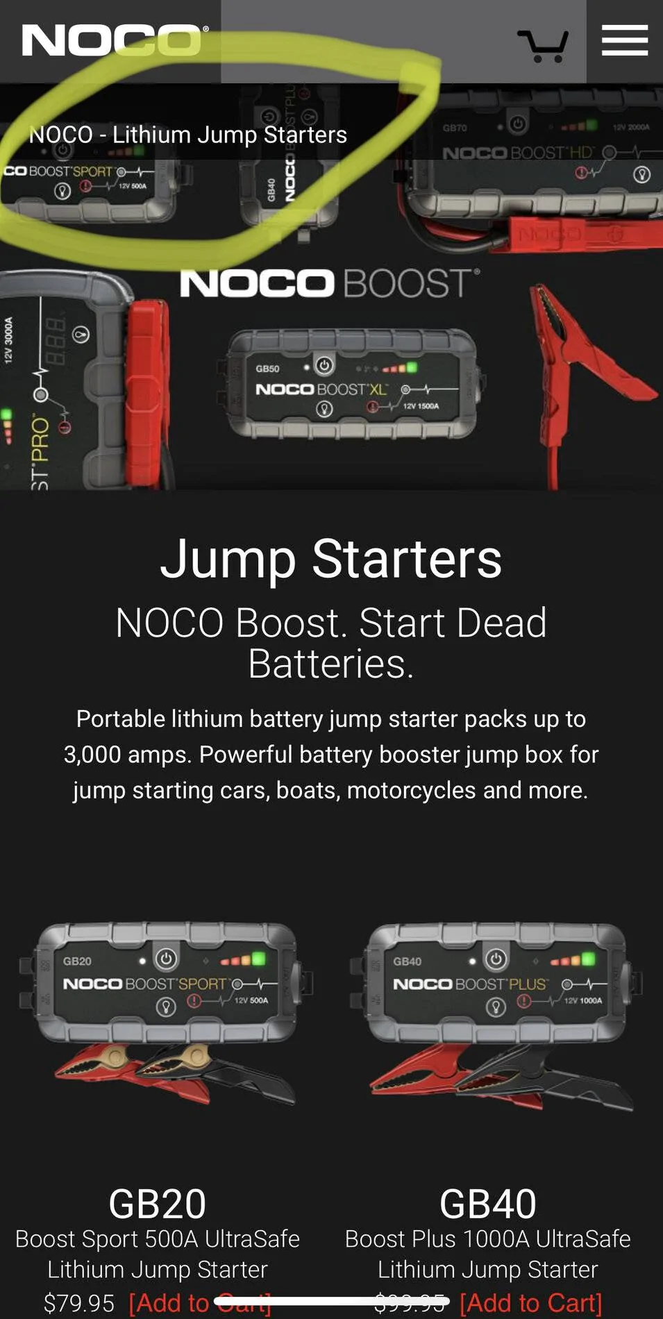

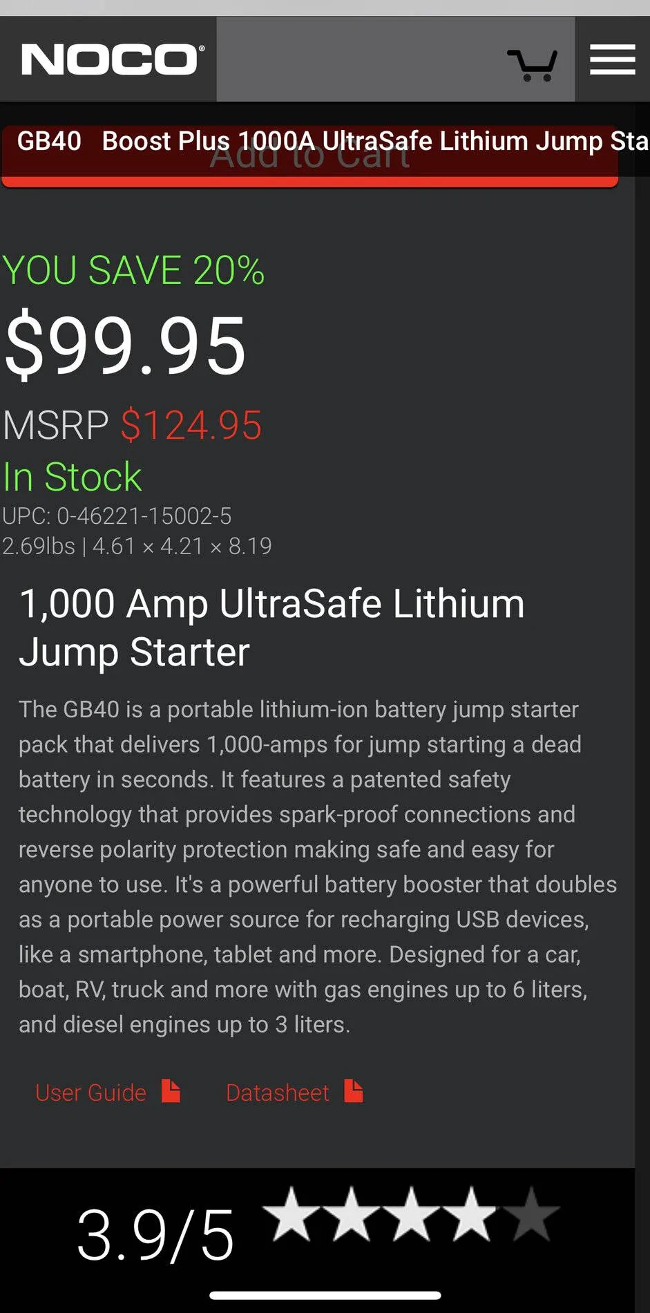

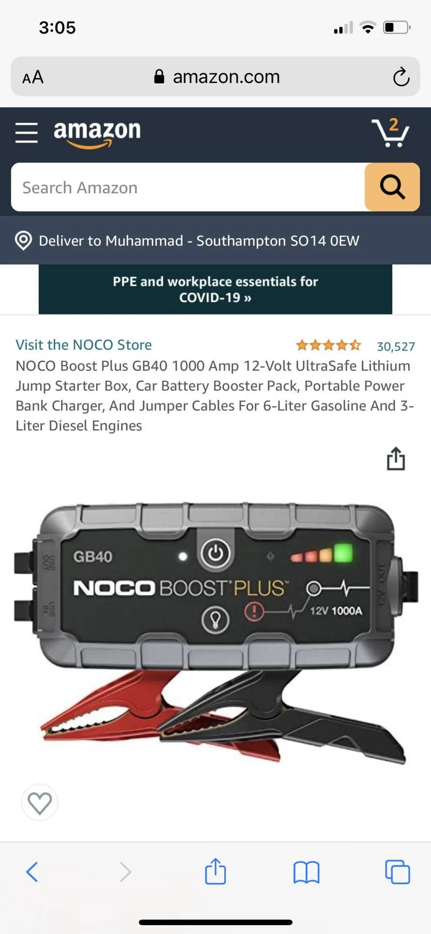

are you sure this one is the one to buy?
from their site
The GB40 is for jump starting 12-volt lead-acid batteries only
you scared me for a moment
I double checked

one of us is confused, the way I see it is that the noco unit IS A LITHIUM unit however according to their specs it is to be used only on lead acid batteries.
see page 5 of their user guide, note the caution part
https://no.co/media/nocodownloads/format/g/b/gb40_v3_userguide_01.11.2019_web_1.pdf
Hmm I guess your right and I purchased a wrong item unfortunately . To make it double sure just in case I have emailed the support team at noco
