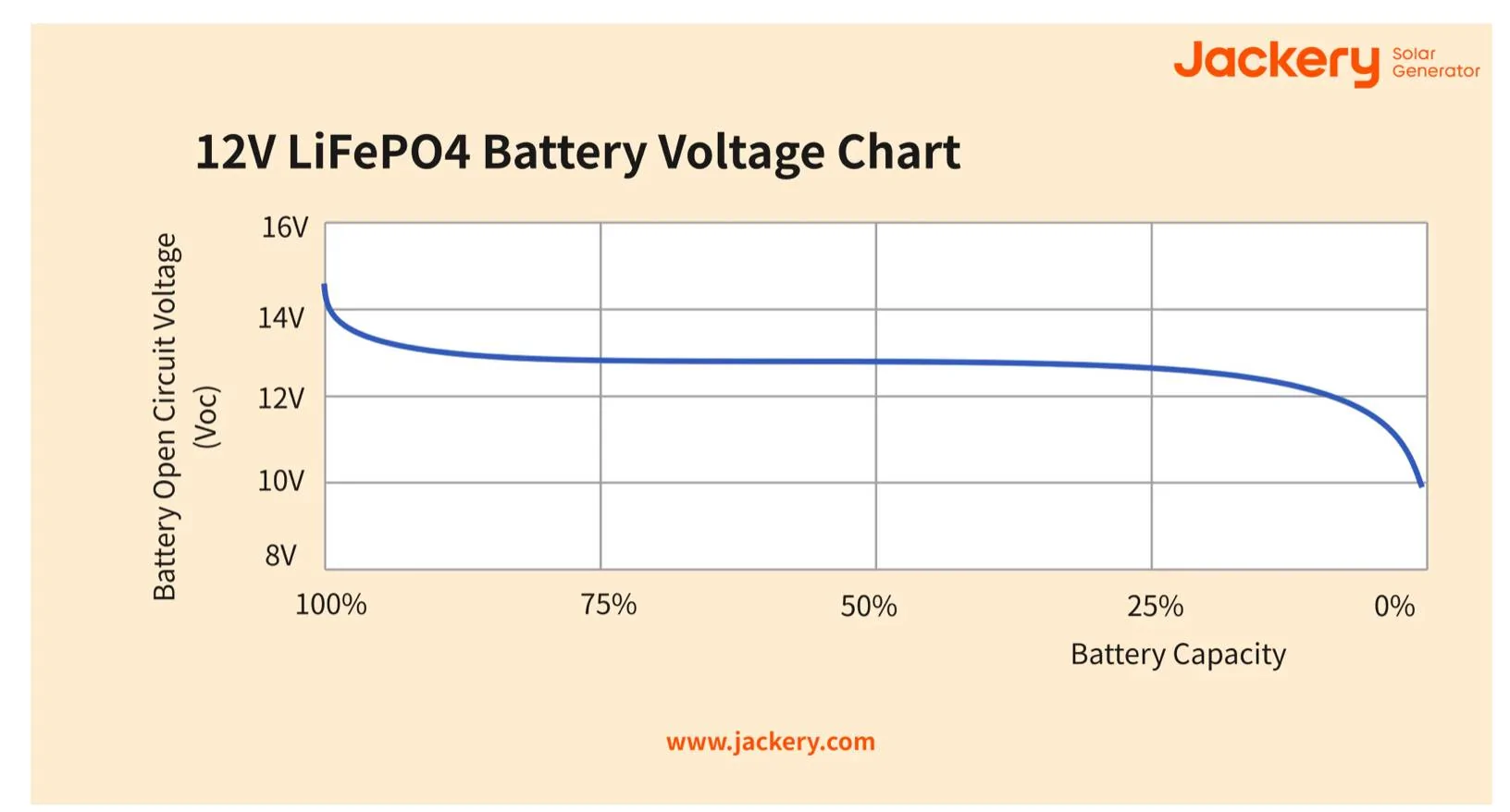

Back in the day, cars had a gauge to measure the battery voltage.
I think EVs should provide a very basic low voltage battery monitoring
allowing to prevent getting stranded without any warning.
There is a gauge in the settings for the instrument cluster, but obviously only working when the car is operational.
I think the warning can be a bit more tricky since the voltage curve is very flat for that Lithium battery. And then the question is how well the car’s system read the voltage and starts the charge cycle. Perhaps temperature also has a big effect.
Have a look at some published graphs for the voltage curve on this type of battery chemistry. Very flat curve and not much difference in voltage at 25% or 80 %?
