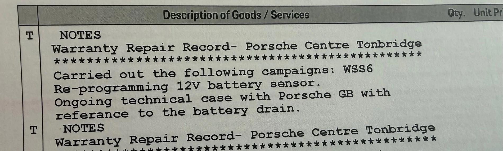

I had this problem for a long time but the software update to the 12V battery management system and 12 Volt switch has finally sorted it.
They also said I have a drain on the car when it is off and they have raised a ticket with Porsche to get a fix but say the latest 12 Volt software will keep it charged even with a drain. So far been perfect so do recommend anyone with this problem gets the latest 12 Volt switch software update.

I did - phoned them and explained that this winter I was getting the problem of low 12 Volt messages as I had in both the previous winters. They said a 12 Volt Switch firmware / software update was available and should sort the problem out. They kept the car over a weekend monitoring the 12 Volt and then let me know that they had updated the 12 Volt Switch but had discovered a larger drain than normal on 12 Volt over the weekend when it was off. They sent the car back saying the charging should take care of any drain but have raised a ticket with Porsche and will have it back when they know the solution. 12 Volt now working perfectly.
Hi I had the same kind of issue and Porsche Germany were able to identify the cause of the battery drain - something to do with the heater - and the problem never came back even though I don't use the car much. This was with Porsche Tonbridge too.
