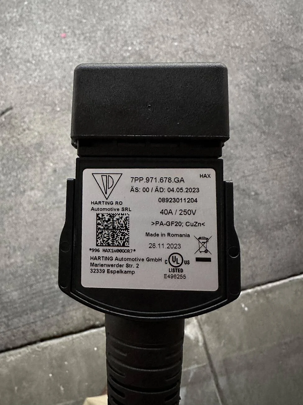

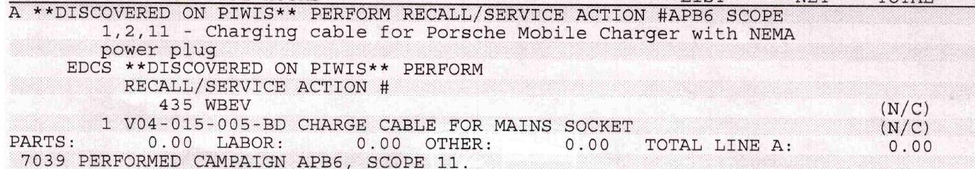

A couple of weeks ago I took the car in to the dealer for some HVAC warranty work and they proceeded with the APB6 recall work.
The cable below is the one that was supposedly replaced in my PMC+ charger pack in the trunk. Is it the correct replacement cable? Part number 7PP.971.678.GA
I am super confused because the invoice and related TSB's all report a new part number for the 14-50 replacement cable: V04.015.005.BD

@WattTurbo: Could I bother you to look at the replaced adapter and report the new part number here? Just want to make sure I got the correct replaced part. Thank you!

You got curious so I went up to the closet to check for you but since the sticker is on the inside and the dealer has already installed the cable I can't see it. They insisted that I bring the EVSE in even though I told them I am more than capable of installing the cable myself. Sorry...
