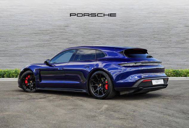

Thanks to everyone for the input, just put deposit down on a year old GTS!
Nice! - is that Gentian Blue? In the picture it looks darker.
What options does it have?
I agree. We need full spec sheet.
