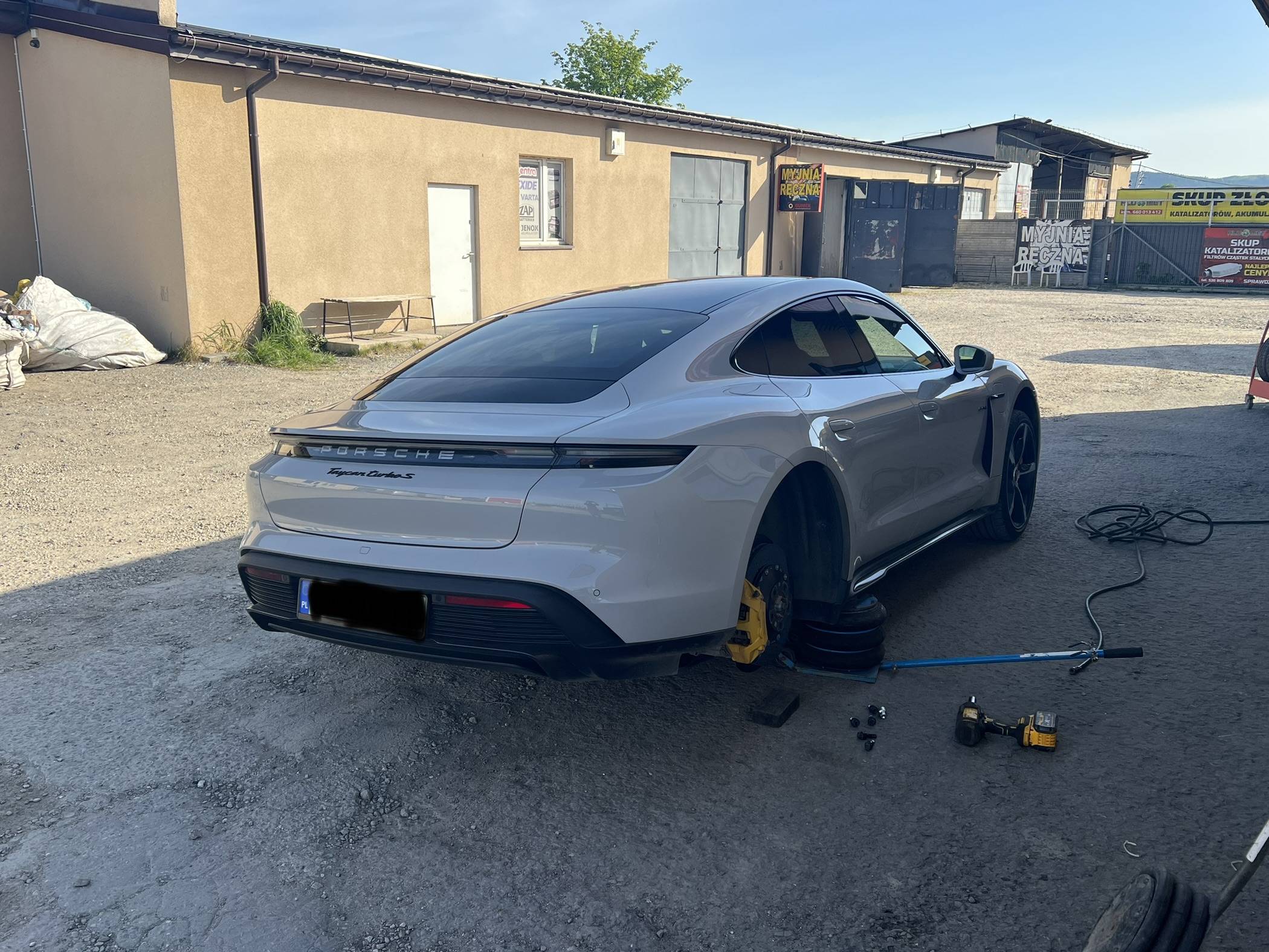

Changed wheels winter to summer twice on my drive. Just a normal hydraulic jack. For the second time I got a special Taycan jack pad , but I think tyre places have huge jacks that they put somewhere else

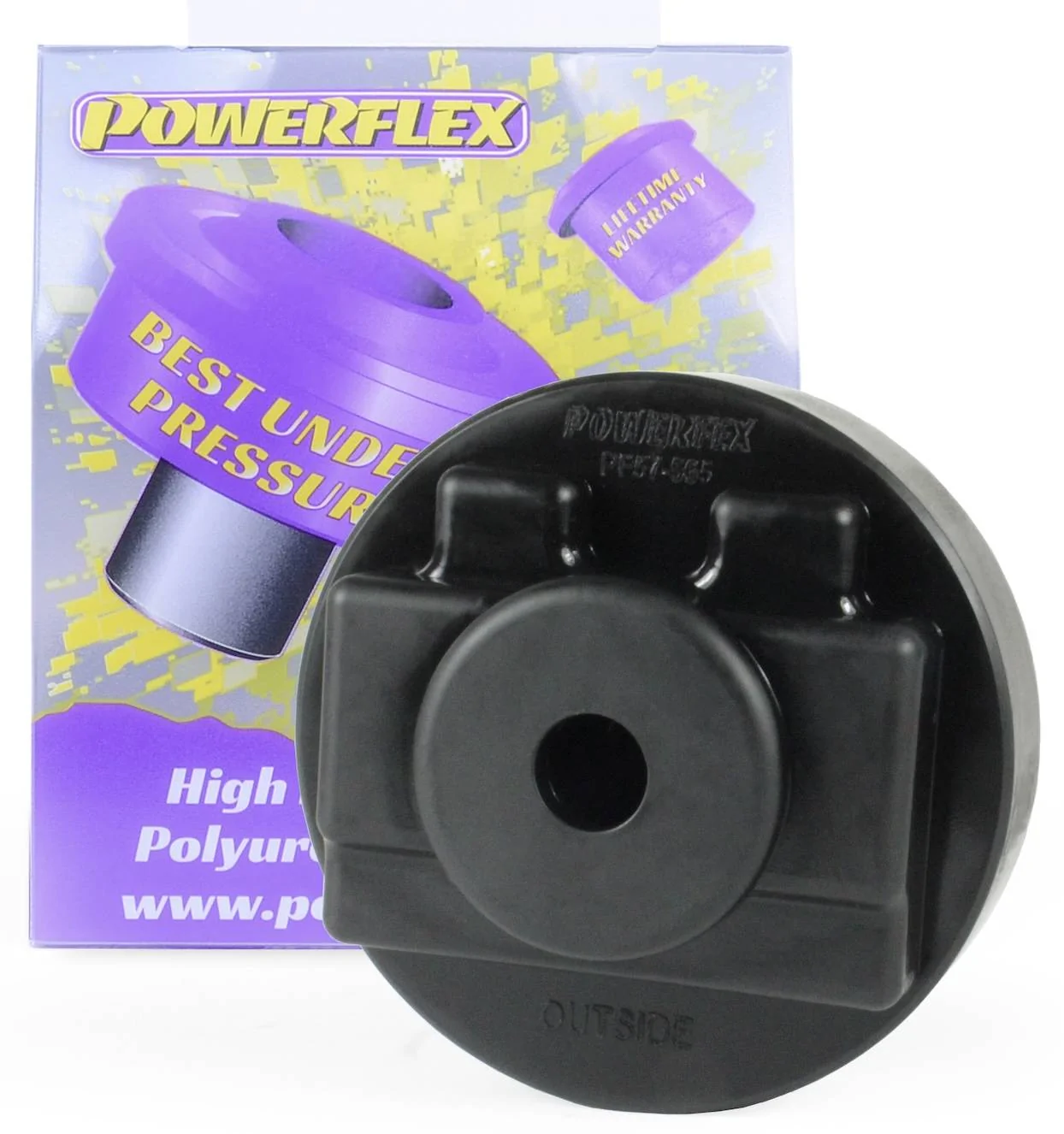

I recommend you buy at least one of these Taycan specific jack pads. I bought 4 as my fitter has a 4 arm lift.
Porsche Taycan Do you need a Special Lift for Tire Change? IMG_0707

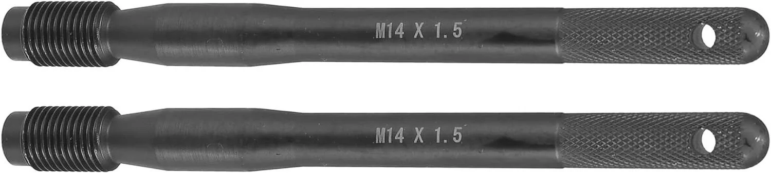

And these wheel hangers are essential if you have carbon ceramic brakes.
Porsche Taycan Do you need a Special Lift for Tire Change? IMG_0708

No special lift is needed. Check the manual for the jack points. If you have the air suspension put it in jack mode.
Yeah I bought the hangers for my second changeover- the first was a bit of nightmare trying to match a huge wheel with holes (my brakes are PSCB)

If I was having a local tire store do the work, I'd show up with four of the Taycan specific jack pads, and at least two of the standard Porsche wheel hanger studs and insist that they use them. I'd also teach them how to put the car in jack mode and insist that they do so. Bad things might not happen if they did it "their way" but why take a chance?
