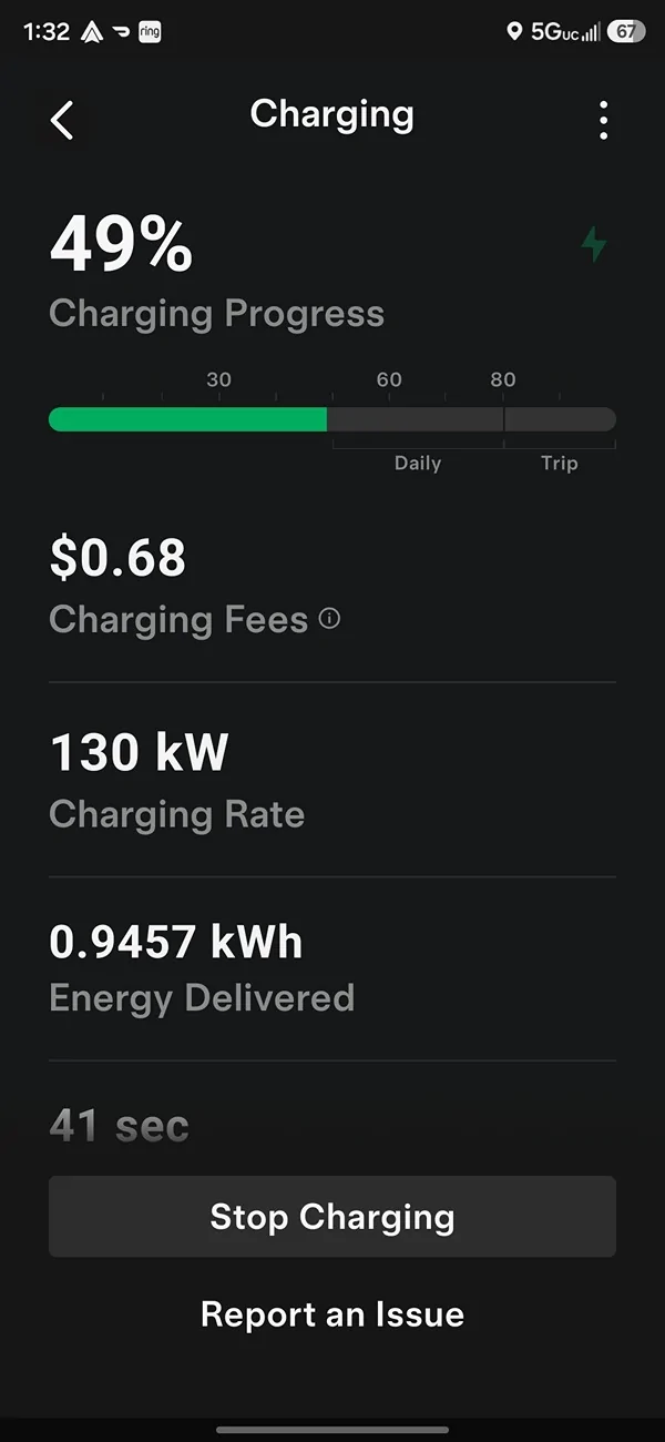

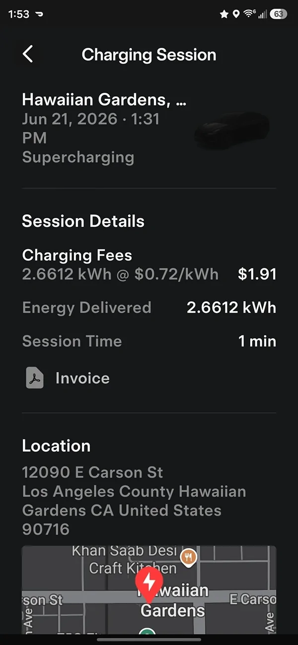

Update:
Turns out I was unable to charge in Tesla SC because of a charging code stored in the car. The code was probably caused by the Mobile Connect charger. The dealership cleared the code and gave me a new Mobile Connect charger, which is an updated version, and everything is fine now.
