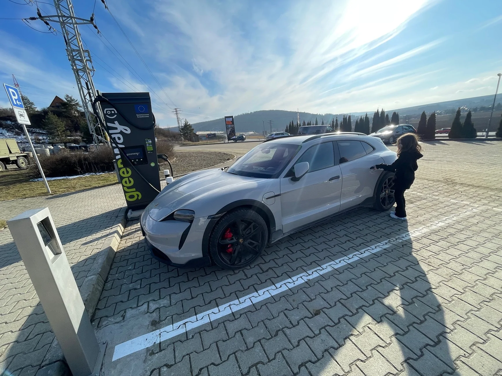

So, I just did a 600km road trip today.
I thank the goddess of maps - nav only failed for a short section - bloody distracting as it happened on the leg of the trip where I was to reach the next charger with only 6% battery.
Just when it happened I was passing the Debrecen BMW factory and I saw an iX3 in the flesh, driving by (not ugly for a modern beamer) - could not help think their software just works.
As the months of Taycan ownership stack up, the more I get the feeling this is a wonderful second or third car to have. Which is kind of sad, as it is such a wonderful grand tourer, such a nice place to be - when it works.

Has Porsche started adding the providers in Romania to their maps? Last trip I did to romania, last year, almost none of the charger were on the porsche map - and I had to add them manually via google search.
At least the map was running off the old API at the time, so no crashes 😅
