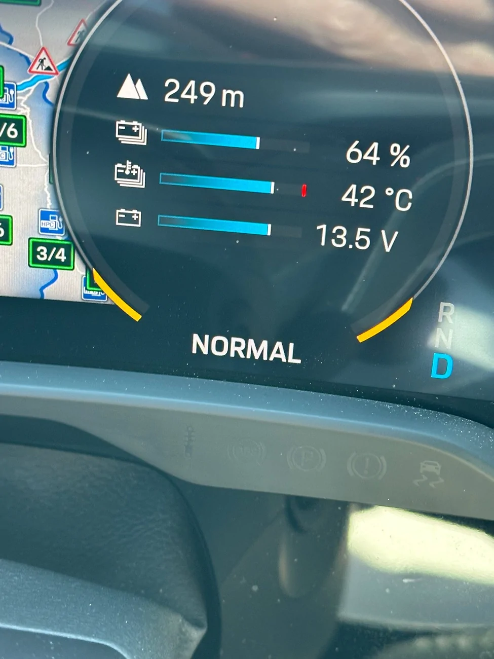

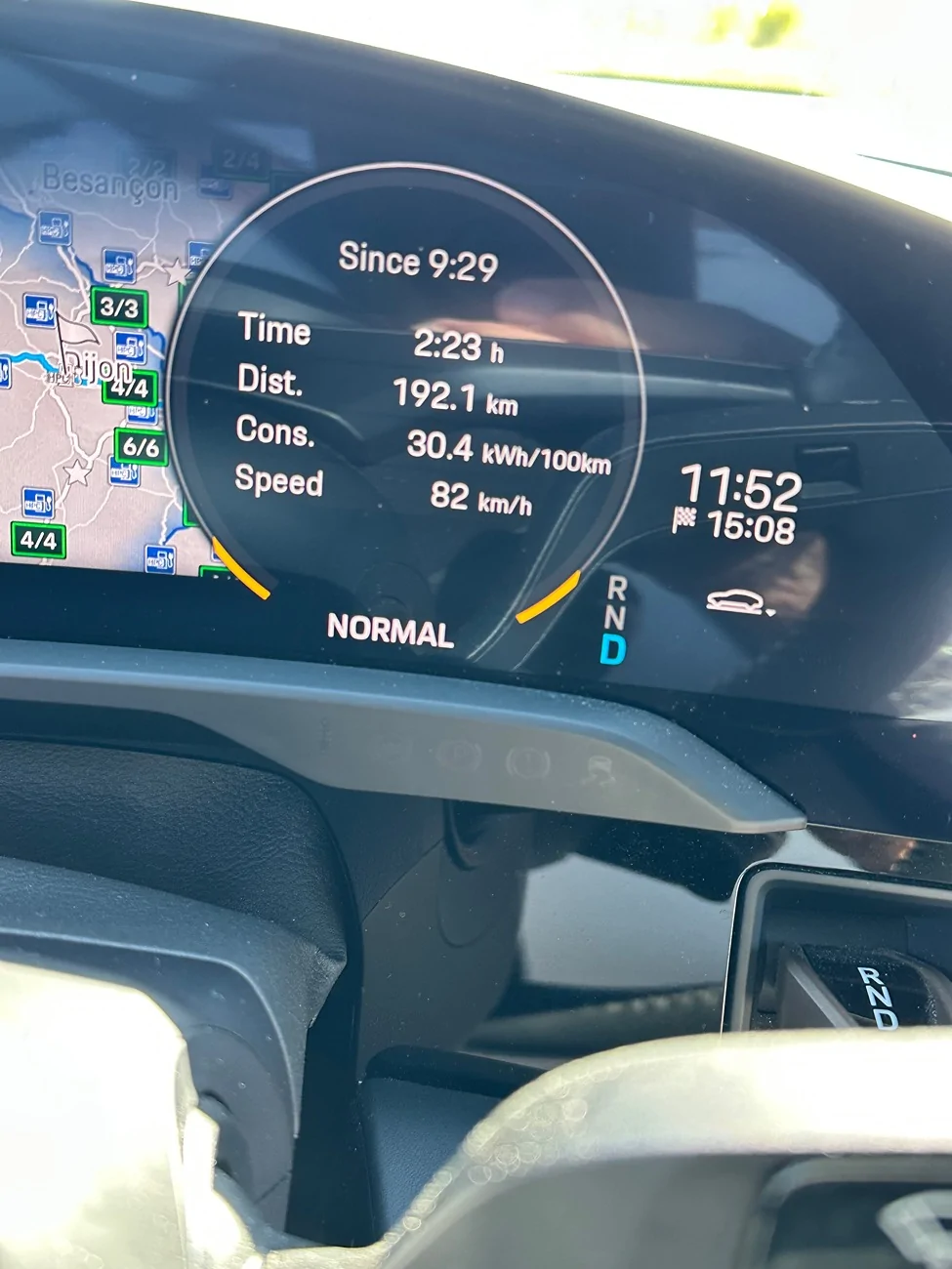

I did have exactly the same issue driving from Reims towards Marseille. The first planned charge stop stayed in the system for a long time.
Not only did it mess up my navigation, but worse was that it never switched off the preheating of the battery. My battery was 41 to 44 C during a 190 km trip. The overll consumption for that leg was close to 30 kWh/100 km, ie nearly 45% more than normal

After the needed charging stop I made a 12 V battery disconnect, which at least stop the preheating and battery temperature returned to the normal range around 31 C. Consumption also normalised.
There certainly has been a bug introduced in some PCM software.

I guess it is not the best for the battery, no. I do not remember what values the battery is in Sport or Sport Plus mode though.
I think I know the reason for this happening now though. When we navigated to the first charging stop, planned by the navigator, the battery did not reach the required temperature of bout 40 C. The Ionity station at Reims had also been extended quite a lot so I remember Seeing a white flag about 50 meters down the line, where the old stations were placed. We did not leave the car or locked either. That likely resulted in the preheating not shutting off. At the second charging stop we also did not lock or depart since there was nothing around at Troyes.
Maybe the simple action of leaving the car and locking it while charging will reset the pre conditioning of the battery?
The ideal temperature is 35, not 40, from what I remember for fast charging.
Also, plugging in a charger, of any speed, will turn off any pre-conditioning. So if it didn't do that, something is definitely wired.
I have seen my battery reach as much as 50 degrees on one occasion, but it was in summer south of Italy, when outside it was 45 and I was high speed charging. I am assuming there weren't 40 degrees outside in your case
