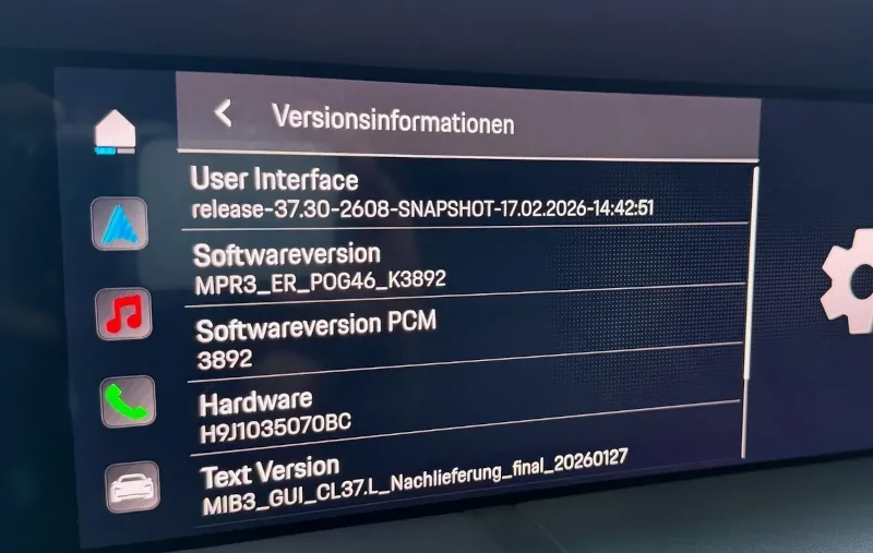

EU/UK: Ongoing navigation issues [Solved with PCM v3892]

My Porsche Centre here in the UK advised me it’s OTA
@ct14garage do you have any information on this?
Customers in Norway also got some information saying this will be OTA. If that is true this is NOT a new PCM version and just small fix for the navigation software.
I guess it's possible there's some room for misunderstanding...
Rodeo's post earlier noted:
"... They have advised that a WTG1 campaign has been launched, which involves the reprogramming of the over-the-air (OTA) software and the central computer. This update is expected to resolve the navigation-related concerns you have been experiencing. ..."
Which sounds like it's reprogramming of the OTA software...

Car comes up on their system today to come in for update! Booked in for a while-u-wait. Not sure if this is the fix or update to OTA so it can receive the fix, but will find out soon
Mine downloaded a whole load of PCM app updates yesterday so perhaps things are moving.

Text version is also newer, UI snapshot too. Did not see any update to these packages yet, mine are still the 2023 versions. Not sure what to expect

The work scheduled
Re-programming over-the-air (OTA) and central computer
Campaign number : WTG1

PPF forum shows new features (for j1.1, j1.2 already got these):
- blacklist and whitelist charging providers
- slider in the middle display to set target SoC
Curious if we get the battery info on the dashboard with charging speeds etc.
The guy said he didn’t see any changes in the dashboard when navigating to a charger, so safe to assume no changes there.
Also not 100% sure on the slider; j1.1 had a bar there delimiting the charging limit before. It could be just that
Still, ability to select preferred providers is great. And hopefully no more freeze
