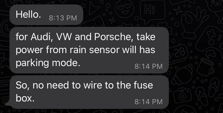

This was an unexpected update from my chat session with FitcamX support. They say there is no need to hardwire to the fuse box for parking mode. I put this out to the community as extra information. You should follow up with FitcamX to verify.

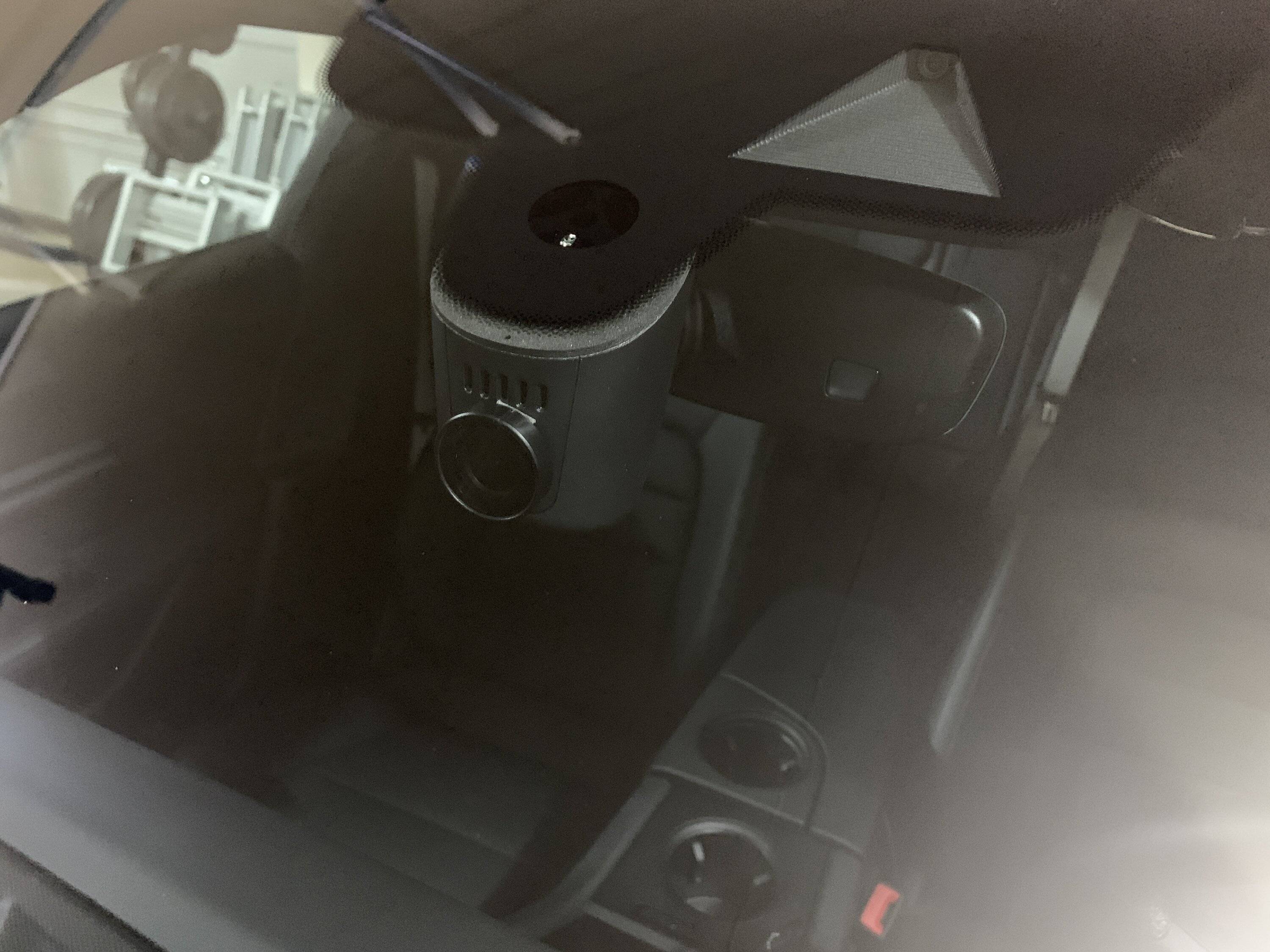

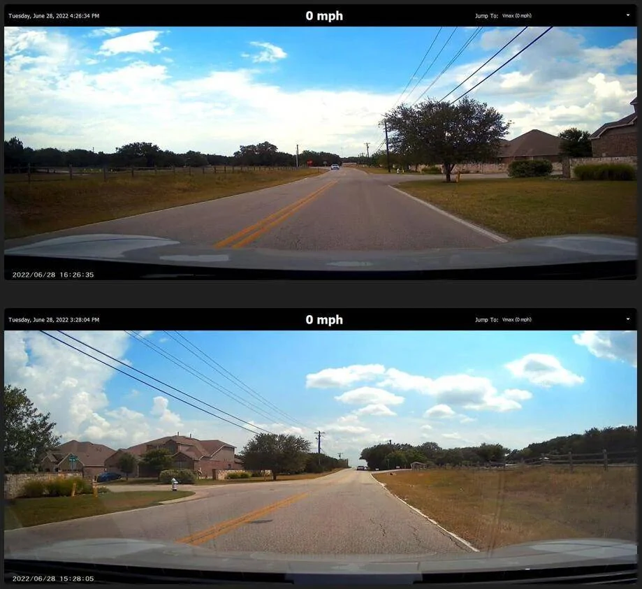

I asked the folks at FitcamX if there was a polarizing filter available since there are some serious dashboard reflections on the windscreen that show up in recordings. They don't have one specifically for this cam but they suggested a Garmin polarizing filter MIGHT work. I ordered the one they suggested and attached it using some thin double sided tape. Here are before and after screenshots from the dashcam recordings...
Porsche Taycan Fitcamx dashcam installation FitcamX Garmin Linear Polarizing Filter
I'll update this thread soon with pictures of the dashcam itself and a link to the polarizing filter in case anyone wants to add it to their setup.
Update:
Link to Garmin filter: Garmin Polarized Lens Cover for Dash Cam, (010-12530-18) https://a.co/fVLf5zH
Picture of filter on FitcamX:
Porsche Taycan Fitcamx dashcam installation FC21CD46-AECA-4487-9F1F-82A03ED93D30
You can see the tape poking out from behind the filter. This was a quick and dirty “in place” installation. When my next CT4 arrives in a month or two I will switch the Fitcam to the new car and redo this so the tape is not visible at all.
Thx for sharing - had a link to some polarizers in one of my threads that incredibly I have yet to test - might have been in teh Hill Country Trip report - I'll check!
Was looking for the most OEM (re FitCam lens size) I could get and did find one - BTW, I don't see the links to the Garmin lens you mentioned you had posted ... Ah, sorry just saw you're last comment :)!

I am not sure if removing reflection adds much value for its purpose.
Hirschaj
Jim
Sep 5, 2021
68
2,223
2,617
Austin TX
A judgement call for sure. I’m happy with the outcome.

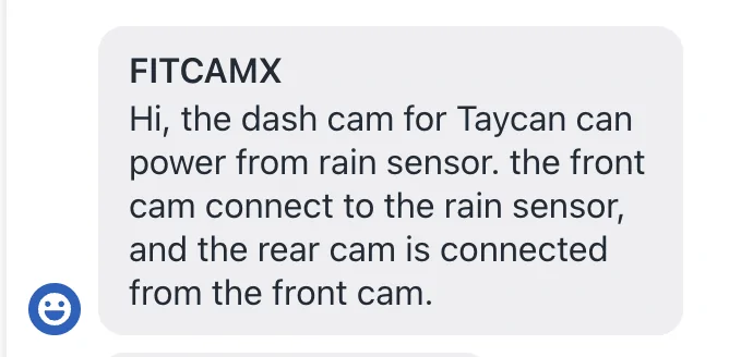

Heard back from Fitcamx about the rain sensor supplying power to both the front and rear cameras:
Porsche Taycan Fitcamx dashcam installation 1656459862204
