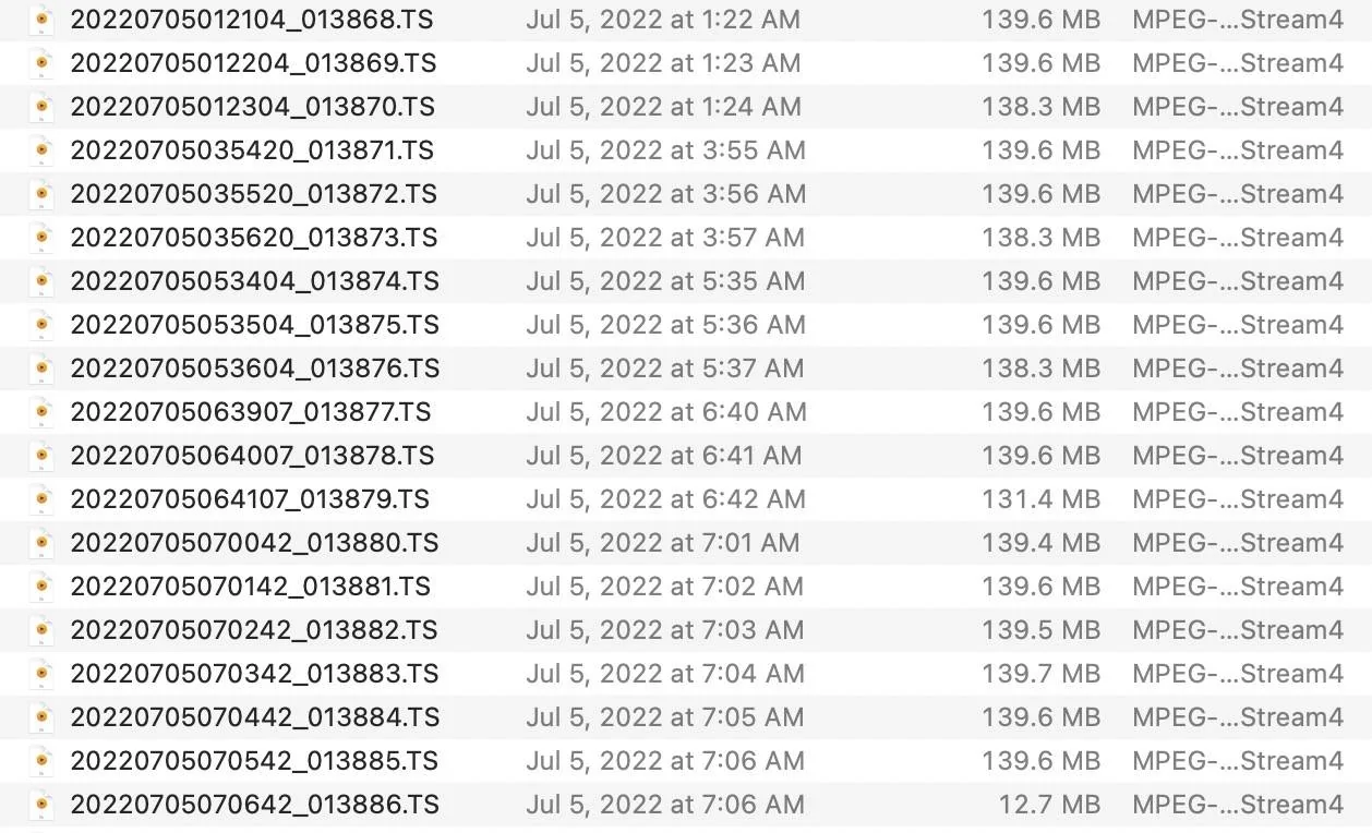

So my 12v just died after using the Fitcamx since last November 2021. I've never had issues.
So I pulled out the SD card, and apparently the cam keeps recording throughout the night. See time stamps below.
I'm not entirely clear if the cam was recording throughout the night in the first 5 months of use, but assuming that it wasn't, why would the cam suddenly start recording randomly at night and day when only parked in my garage? This is probably why my 12v died.

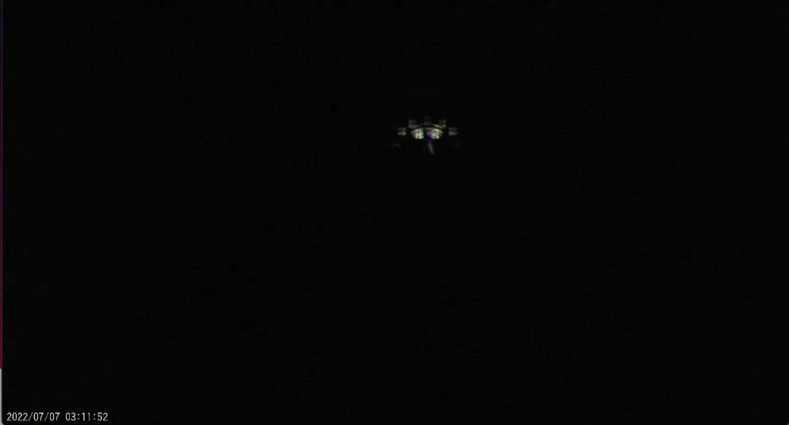

Here's the weird thing - prior to the car getting bricked, the Fitcamx would intermittently record a lit up and moving sport chrono clock reflection in my garage (see still image below). After I got the car back from Porsche and they did some warranty updates (WNA5), the recording just shows pitch black with no light from the clock. Question: Why was my chrono clock always lit up during recording before my car got bricked and not after? Is the lit clock why my 12v died? (...continued below)

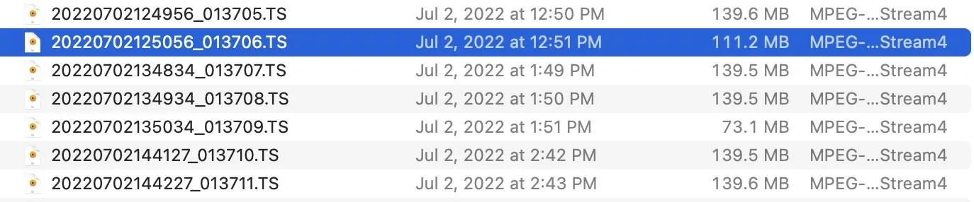

So I was at a mall and locked my car at 12:51pm and unlocked at 2:42pm. But even with the car locked, the cam woke up once to record at 1:49pm. You would assume with cars moving around within the two hour span it was parked, the cam would wake up more than once. And why does the cam even have power?!

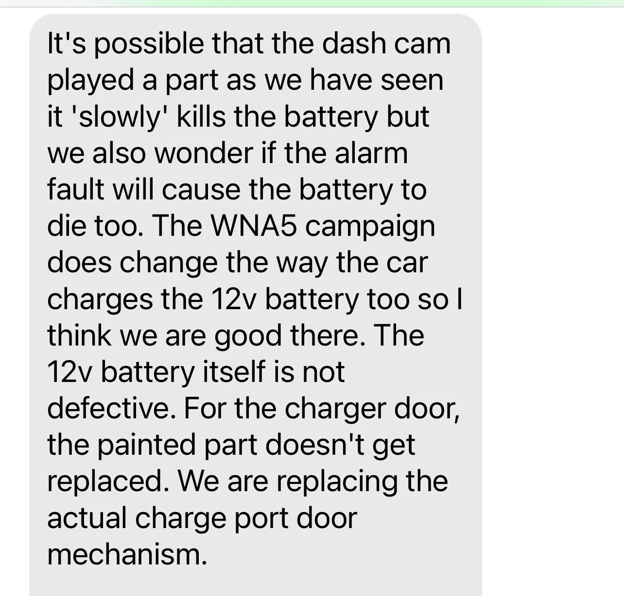

Porsche said my 12v is not defective (assuming they tested it). See their text to me below (names cropped for privacy):
