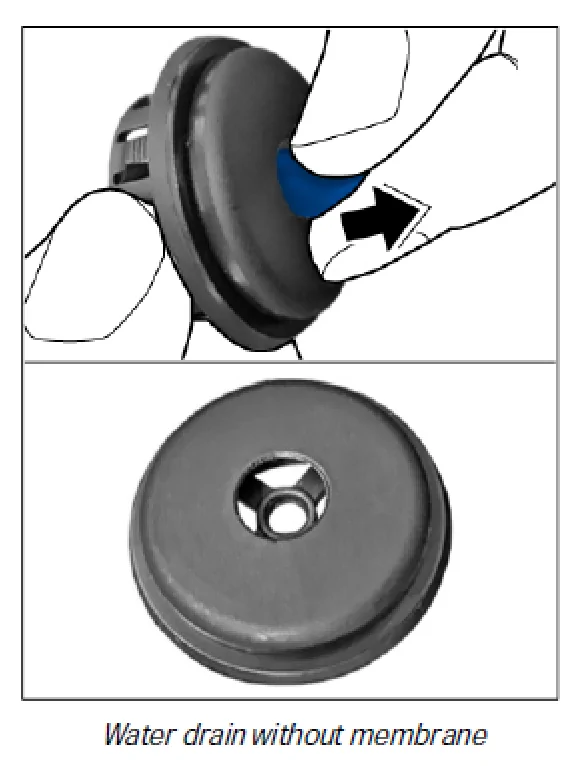

An advisory warning to everyone to have the service team at your Porsche dealership check your "High Voltage Protective Plate Water Drain Plugs" on a regular basis. 21,000 miles in my 4S+ Taycan, which has been a joy otherwise.
After a five hour, spectacular, 2 lane road adventure through the coastal Pacific Northwest Forest, during a light rain, I discovered about 1 ½ inches of water in the driver’s side rear “foot garage.” After getting as much of the water out as possible, I turned in for the evening, as I was headed back home the next morning where I could see my Porsche dealer. On the way back home, another inch of water showed up. I could not contact a technician by phone, as it was a Saturday, and could only schedule an online appointment one week out. Over the weekend I vacuumed out the water, pulled the carpet up as best as possible, and placed a high-speed fan and heater in the back seat until I could get it to the dealer Monday morning.
It turns out this is a known Taycan design defect. Regular road gunk plugging up the plug's membrane, not allowing it to drain. This defect is identified in the attached service advisory. (Thanks benver!) No known permanent fix to date, other than remove the plug’s membrane, pull the high voltage battery, and reseal the underside of the car. Think little critters going through the open plugs to build homes inside your car, without the membrane in place.
My powerful fan and low heat did most all the job, and the dealer pulled the back seats, carpet, and dried out any remaining moisture. No issues, but if I had not caught it quickly, I could imagine someone ending up with a moldy back passenger area.
Have your technician check those plugs on a regular basis. Porsche isn’t telling them to do it.
