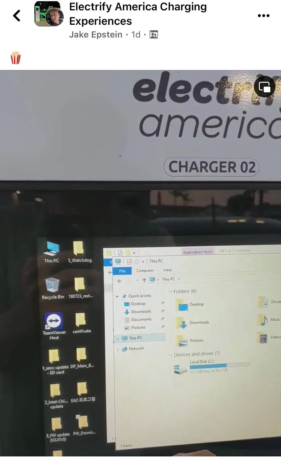

And here’s a screen capture from a video posted to the EA FB group showing how during a remote software update anyone could come up the screen and take control!
