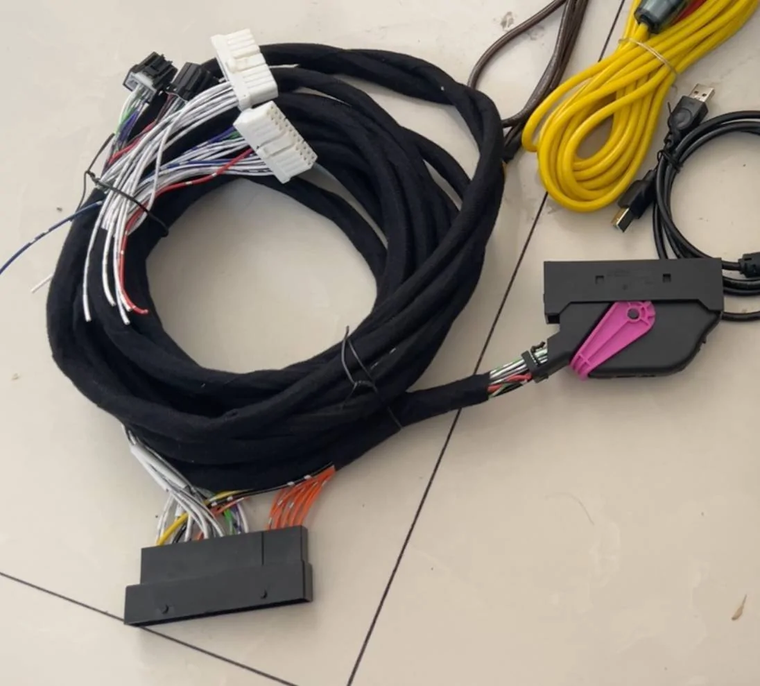

At no point did I say we take the signal after the BOSE DSP. It’s left in place purely to keep the system stock, no faults, no nothing. That’s how it’s done properly not the redneck way.
Porsche Taycan Helix + Audison audio upgrade IMG_6202
Take a look at that custom wiring harness, it’s all there. We tap the signal before it hits the BOSE amp and route it to the aftermarket DSP. The BOSE DSP still powers up thinking it’s doing everything, but in reality, it’s doing nothing. All done through a plug-and-play connector that mirrors the factory one. This is how high end audio installs are done. Specially on high end vehicles.

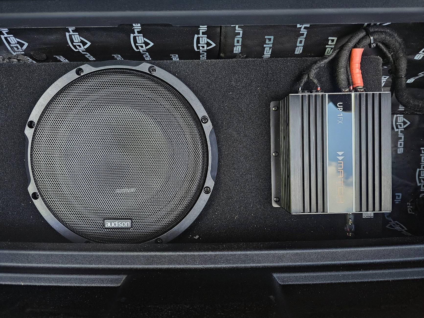

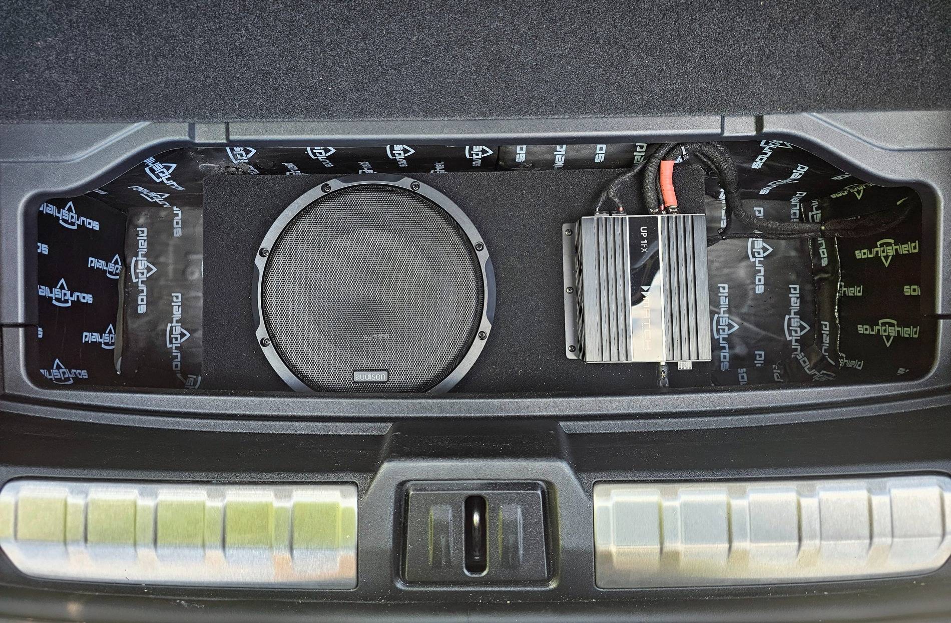

Finally got my Bose sound system upgraded. I started with a DSP amp upgrade just to see what a better signal and more power will do for the factory speakers. Also swapped out the Bose sub and enclosure with an Audison sub in a custom made box that is driven by a mono amplifier.
All I can say is that this upgrade is a night and day difference! The bass pounds nicely and the speakers are louder and clearer. I may still upgrade speakers in the future because this is an addictive hobby lol.
Its a pretty stealth install so not many pics. Here's a list of components:
Helix V12 DSP Amp
Nav-TV Zen-V to connect the DSP amp to the head unit
Audison APBX 10 S4S subwoofer box
Match UP1FX amp to drive the sub
Sound deadening in the floor of the trunk
