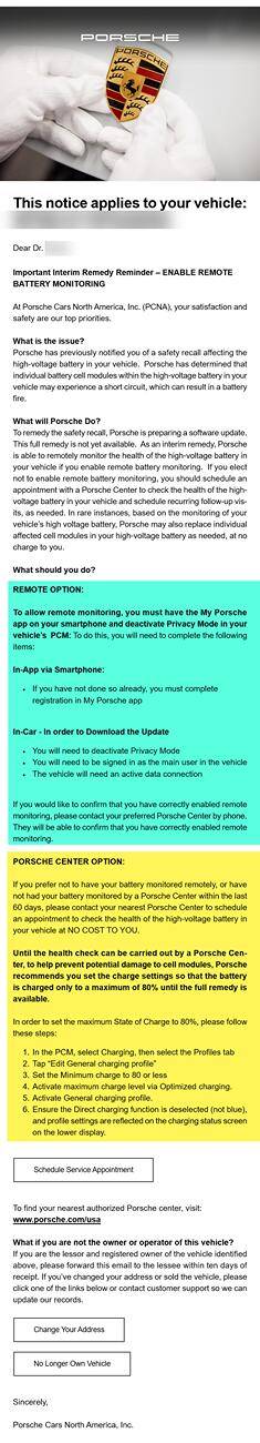

Although Porsche certainly could have structured that message more clearly, the 80% recommendation (which is definitely *NOT* a "limit") is only for those who have neither enabled remote monitoring:
"Until the health check can be carried out by a Porsche Center, to help prevent potential damage to cell modules, Porsche recommends you set the charge settings so that the battery is charged only to a maximum of 80% until the full remedy is available."​
That paragraph is under a section heading of:
" PORSCHE CENTER OPTION"
... which is clearly an alternative to remote monitoring (as it starts off with "If you prefer not to have your battery monitored remotely [...]").
Agree - though I am sure that if someone does charge their car to 100% and they do experience a short causing a fire - they will point to this language - Its probably worded that way to mitigate a lawsuit but the underlying message is to not charge your car to 100%. Since the software has been delayed another three months I surmise
that Porsche is having a very difficult
time coming up with an algorithm that sufficiently tests/monitors the battery with enough confidence that they can state your battery is ok to use to its full potential or is defective.

How is that the underlying message?
The recommendation to charge only to 80% is definitely only for a Taycan owner who has not enabled remote monitoring *and* has not had the battery inspected at the dealership.
Pointing to that letter/email would do nothing to absolve Porsche of responsibility.
And even for a Taycan whose battery condition is unknown (via either remote monitoring or on-site inspection), the wording is explicitly only a recommendation.
If anything, this wording would hurt Porsche from a liability perspective.
(Think about it from a jury perspective: did Porsche warn the Taycan owner not to charge to 100? No, just a mere recommendation.)
Sorry just disagree with you.. there is no remote monitoring as there is no software that does this...so yes to me this means the underlying message is dont charge to 100%.. unless I want bring my car in every 3 months to a dealer or whatever their 'recommendation is".. I do agree it probably won't hold up to a jury.
The language of the email, while lacking in simplicity, is clearly stating the recommendation (not a limit) of 80% is for cars which are not monitored remotely until they get inspected manually. Not even Elon's lawyers would be able to stretch the interpretation that if you charge above 80% after inspection, or if having the car remotely monitored, that it would not be Porsche's fault that your car burns down your house. Below is the email. As the user, you have two options, REMOTE OPTION or PORSCHE CENTER OPTION. Note there is nothing about charge limits in the REMOTE OPTION (highlighted in green).

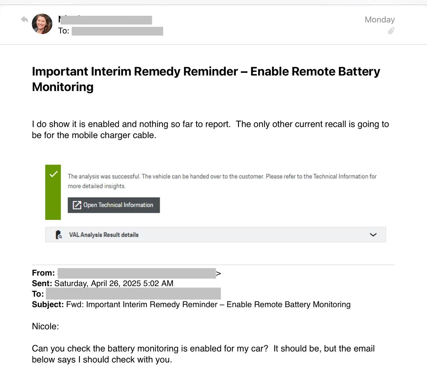

@whitex - I followed the steps in REMOTE OPTION and the process worked as advertised in the email. Here is the confirmation from my dealer.
That's great that they actually provided proof. Your dealership seems to be better managed than mine :))
I wonder how often these VALs are done and under what circumstances they are triggered - do you need to be driving, does it need to be parked with signal, does it need to play eminem music, etc, but great news that it actually works now once WRV1 was done.
I would assume that the final software coming in 2nd half of 2025 will try to take some action based on data from these VALs, along the lines of disabling specific modules or entire battery.
