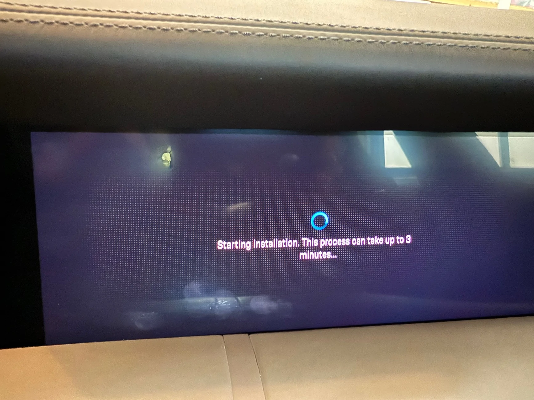

When I got back from a trip my 4s told me there was an OTA update available. I followed the instructions (I thought), but after 3 tries the install hadn’t worked. I would get this spinning disc view, but when I exited and locked the car nothing happened.
Porsche Taycan High Voltage Battery Recall EXPANDED - ARB6 & ARB7 img_7680-jpeg

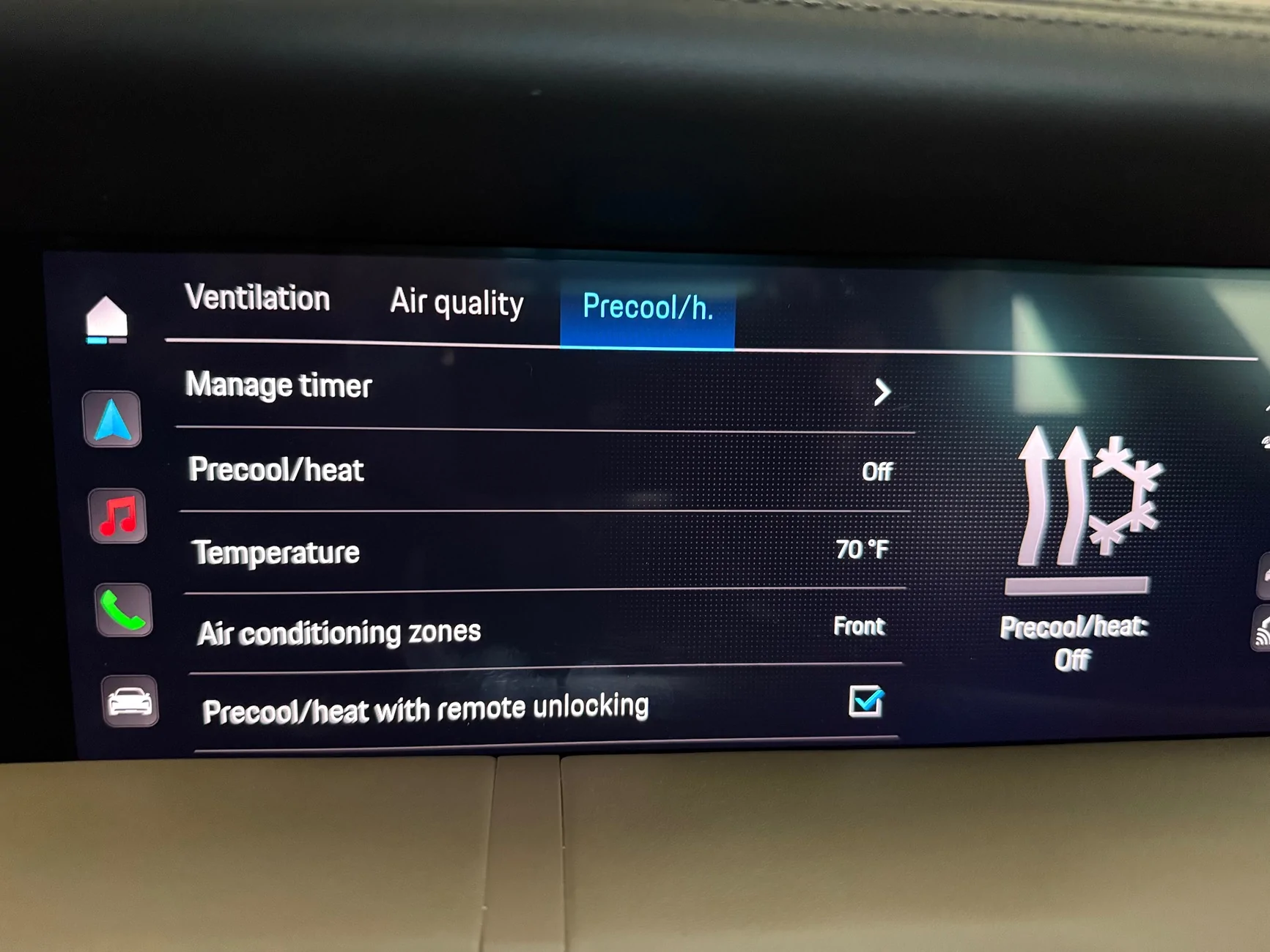

Finally, I went to the Settings > Air Conditioning and turned Precool/heat to OFF. This seems to have done the trick, and the update installed.
Porsche Taycan High Voltage Battery Recall EXPANDED - ARB6 & ARB7 img_7681-jpeg
Going to the NHTSA database I no longer see any recalls on my VIN.

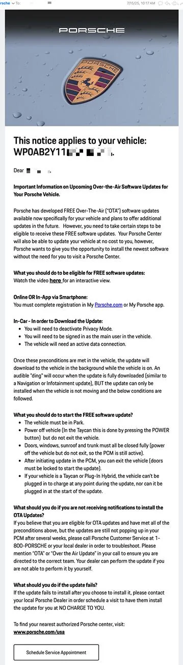

A good question, and I'm not sure if there is a way to "Pull" the update. In case you didn't see it, these are the instructions I received via email on 7/15/25.
Porsche Taycan High Voltage Battery Recall EXPANDED - ARB6 & ARB7 1753895552218-o5

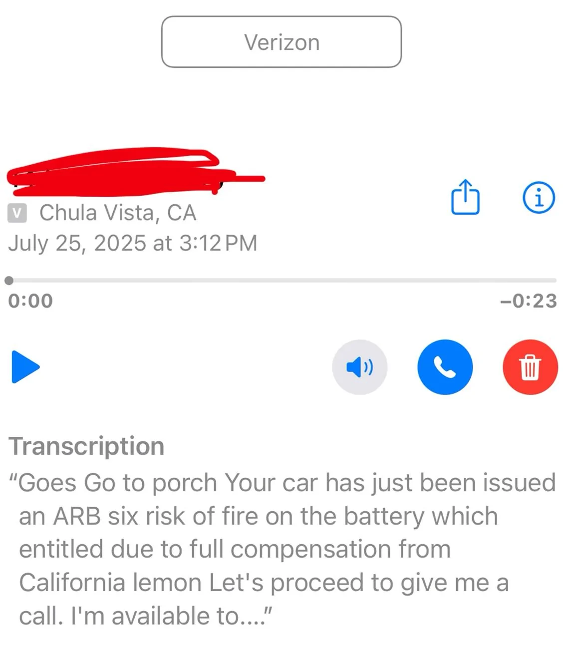

This is a long thread so I did not check every post, but figure I'd ask -- ya'll get to a lot of these?
I've gotten 2 voicemails and 2 emails over the past few months. I checked my VIN on porsche website and no recall.
Porsche Taycan High Voltage Battery Recall EXPANDED - ARB6 & ARB7 1753995449912-9q

Did you check NHTSA if it shows your car having the recall?
https://www.nhtsa.gov/recalls
Beware of scams too. Theoretically some scammers could identify Porsche owners (who likely have money, so present a good potential target) from recall databases, which are are public information.
