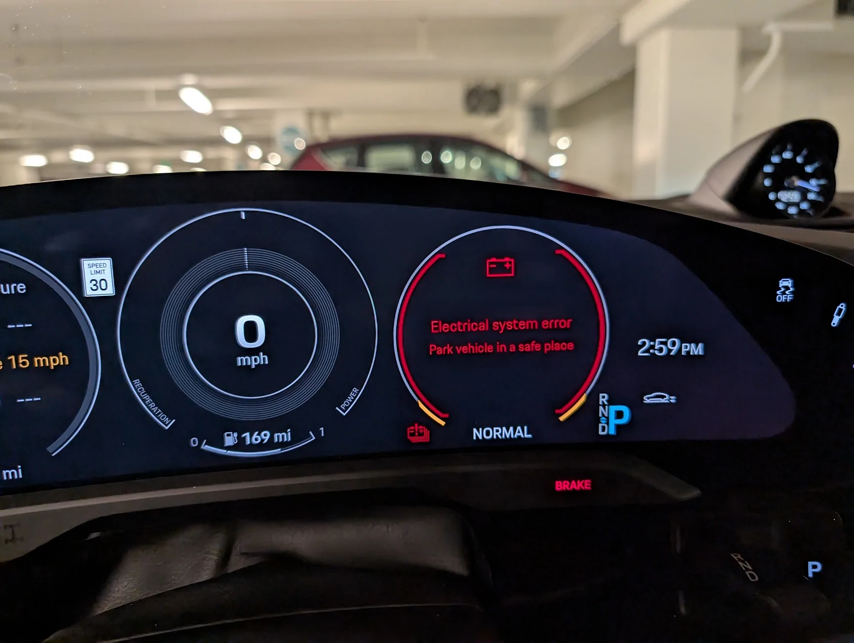

Who knows if it's related, but had ARB7 cleared just a couple weeks ago and this afternoon the dreaded red circle appeared. Glad it told me there was an issue I guess? 🤷‍♂️🤦‍♂️
So you couldn't even drive it? Letter just said if a fault occurs to contact your dealer for repairs and the the car will automatically only charge to 80%
Correct. I could go to neutral and park as my only options. But given this error has a long history on this forum I do not yet know if there is a relation or not to the 6/7 campaign. I was under the same impression regarding the alert as you. There was a 6/7-related action during my July service that noted something about software, and the campaign had been removed from the nhtsa site after that so I'm relatively sure I have the new software. I now only show ASA2 (passenger seat, for which there also is no fix at this time for my car).
Incidentally, when the SA called me it was a "the car shows nothing wrong, why is it here? What do you want us to do?" I've not worked with this SA before so I don't want to read into the tone too much but it gave me the impression of wanting me to just come get it. The error wasn't popping up for them that next morning. I sent over pictures and only then did it change to an "oh, ok. We can look into that."

Fun fact, the error was because "a cell was too warm" according to the SA. The car had been sitting in a parking garage for 8hrs at that point (not charging) at a 67% SoC. The SA asked permission to remove the 80% limit in my General Profile I'd set previously and charge to 100%. I asked if it was my profile or if the car had set the limit from detecting the error and he confirmed it was my profile. So I guess the ARB6/7 software did not trip here 🤷‍♂️

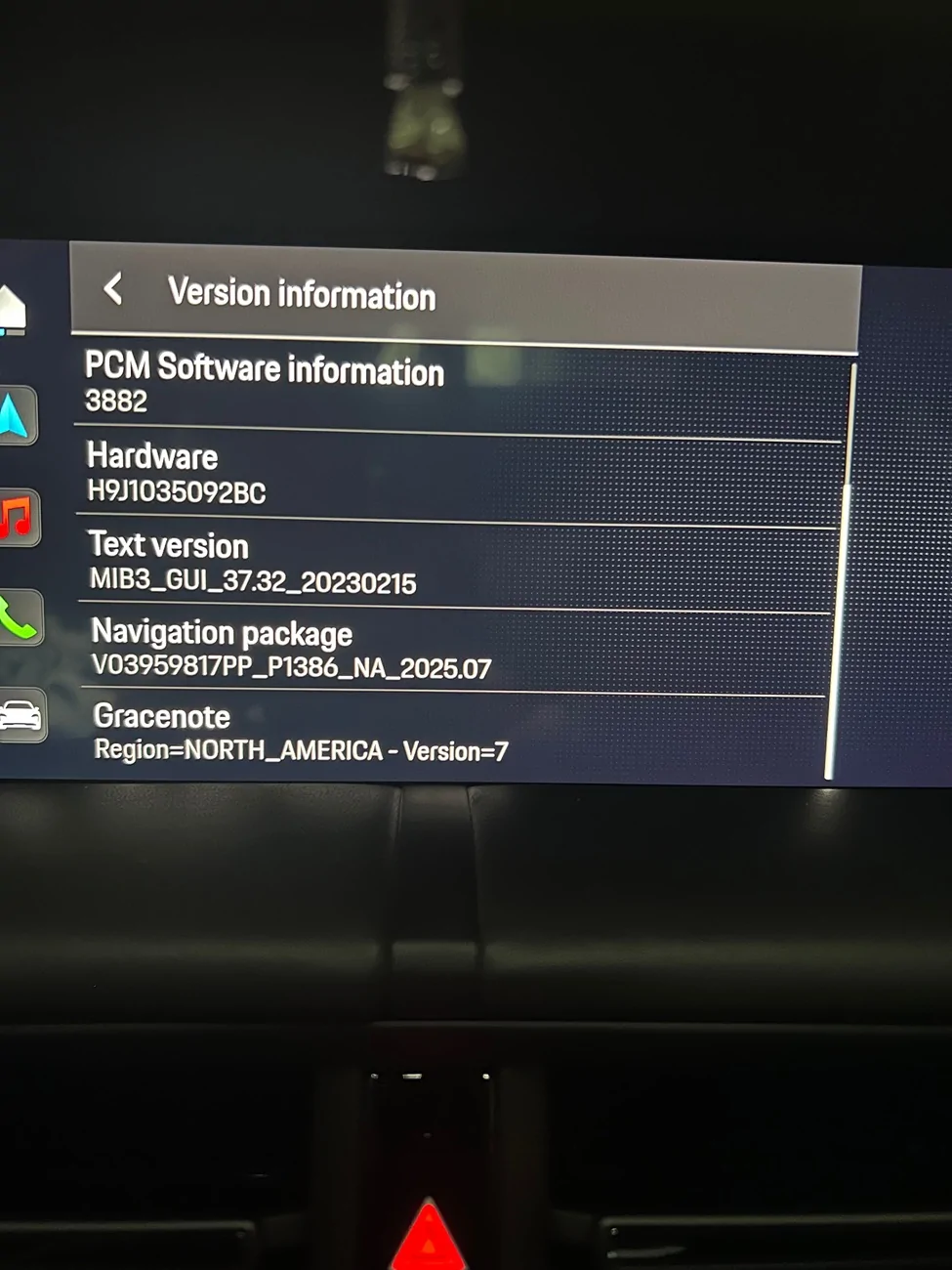

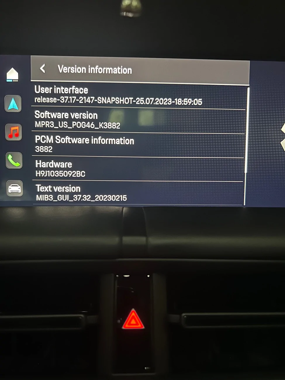

The following was completed today as part of the ARB7/6 recall. In/out of service within the same day. 15.4K miles.
  1. ARB7 - Completed. No issues found.
  2. ASA2 - Not completed. Parts not available.
  3. WRW1 - Completed. To address OTA to the external communication control unit.
  4. Multi-point inspection completed - Passed
