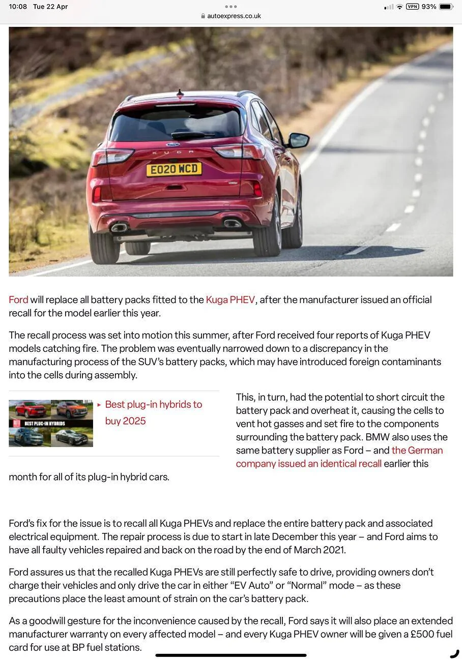

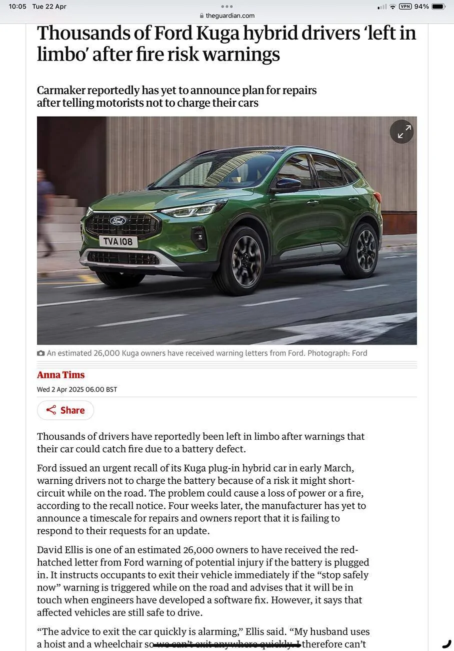

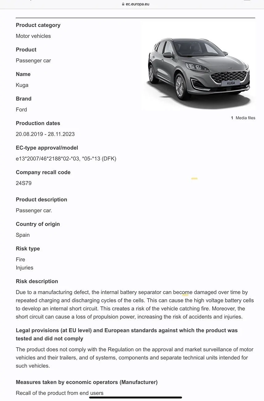

Ford Kuga Plug In Hybrid Recalls. Seems they do their own HV battery assembly and use Samsung/Panasonic cells.
First in 2020, full battery replacement recall:
Porsche Taycan High Voltage Battery Recall EXPANDED - ARB6 & ARB7 IMG_4096
Current 2025 recall, do not charge pending software update
Ford will compensate UK owners with a £500 fuel card and extend the warranty.
