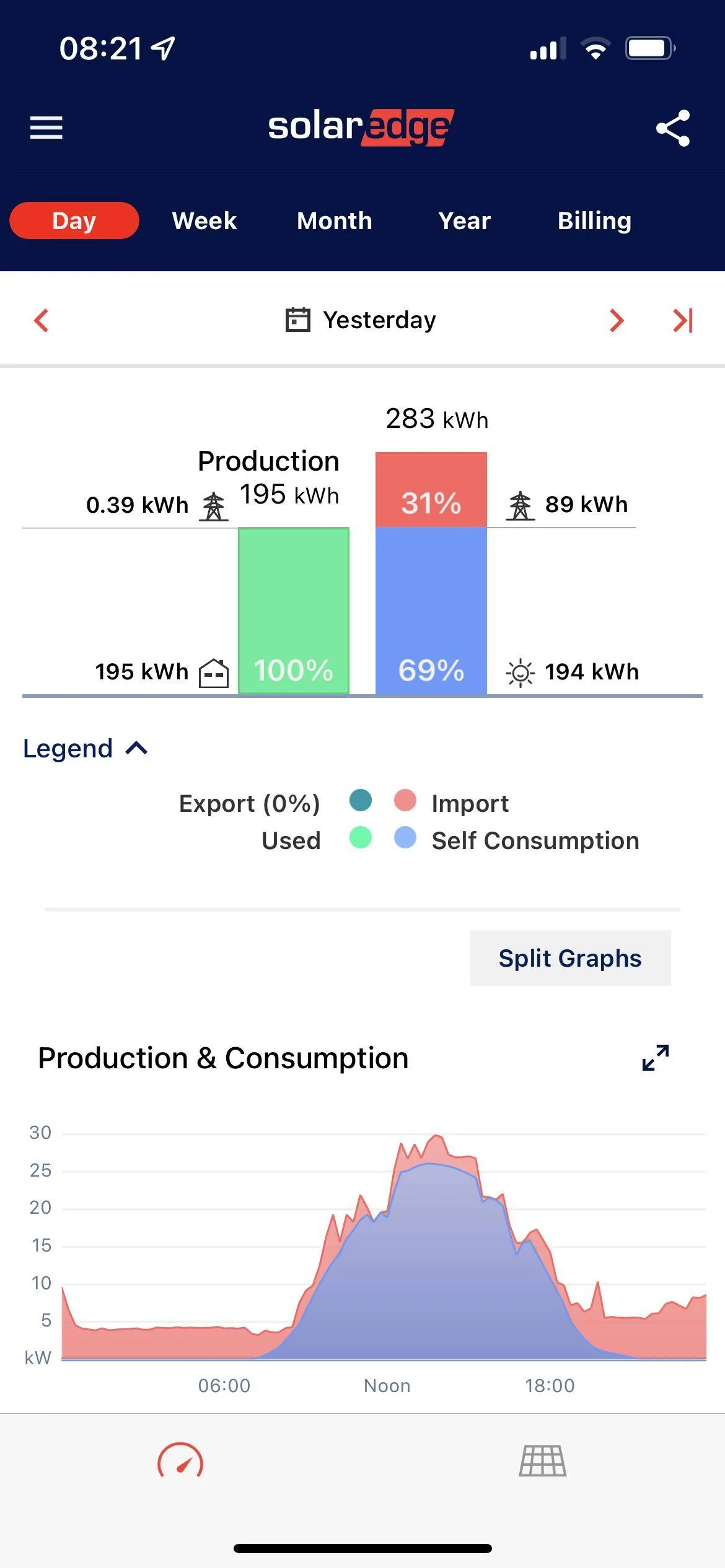

I do, have a HEM, yet I do not use it for preferred time. My use case is special as I use it in daytime when if I have enough solar capacity or at night or weekends if I don’t. My important function is so that the the charger together with my domestic usage never exceed the 17,2 kw maximum draw from the supply with the electrical company. If I exceed it, there is a penalty which increases the price of the whole month’s invoice in an exponential manner ! By the way, yesterday was my record for solar production 194kwh from a total consumption of 283kwh. I did charge the Taycan from 40% to 85%, albeit at 11kw because I have 22kw available at home, but the 22kw option was removed by Porsche when they built mine.

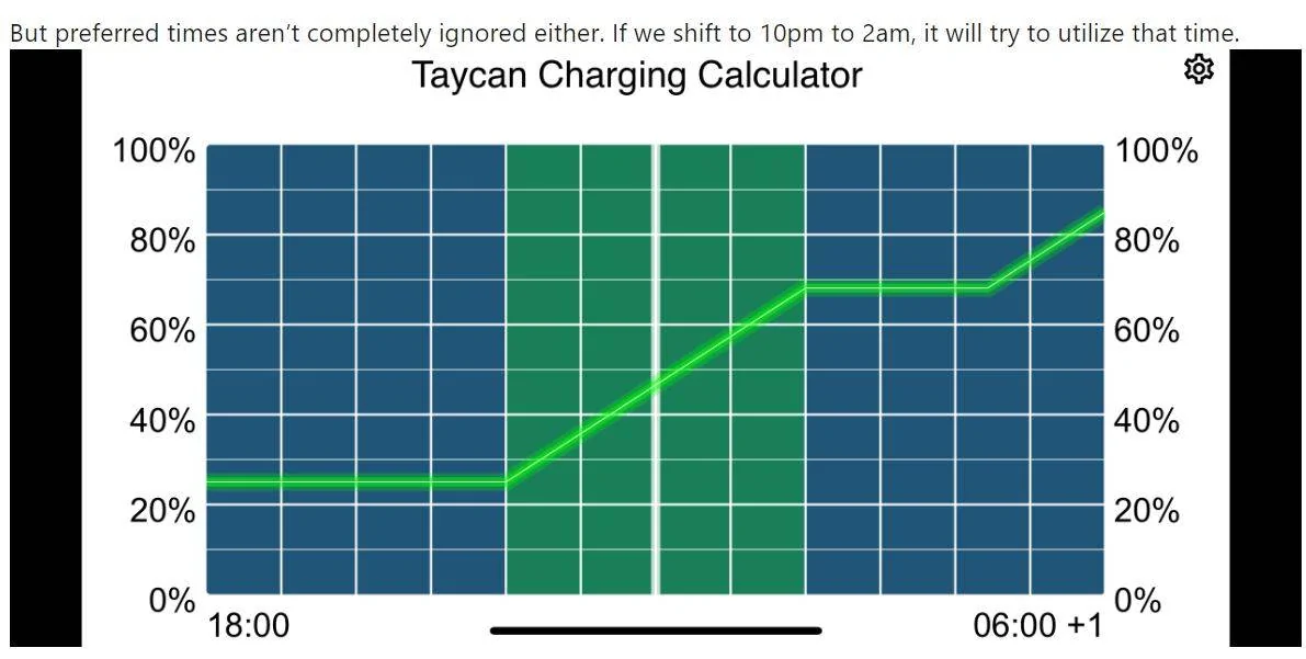

@JimBob @DerekS
Timers don’t completely ignore preferred times, but they are prioritized such that they allow charging outside of the preferred time if required.
For example: on Derek’s setup of a a timer at 85% at 6am with preferred times between 8pm and 3pm using a 9.6 kW EVSE, the timer can always charge within the preferred time.
However, if we change the preferred times to between 2am and 6am, it will start before the preferred times if plugged in below approximately 40%.
But preferred times aren’t completely ignored either. If we shift to 10pm to 2am, it will try to utilize that time.
And if we plug in with a higher SOC, it may reach the target within the preferred times, although note that it delays the start time as late as possible within the preferred time (added in orange)
This is a great explanation, thanks for taking the time to post it!
I now see what you mean, timers might cause "violation" of the time window, depending on when that window is and charging needs to be ready by the timer time.

@Jhenson29
Referring to your Charging Calculator.
This is the interesting case that shows the Timer had at least some smarts as it stops and restarts.
Porsche Taycan Home charging software limitations Charger
Can you confirm if this is what happens in the real world along with how the calculator shows it?
Jhenson29
Jeremy
Feb 9, 2021
3,016
4,656
St. Louis, MO
@Jhenson29
Yes. I’ve done lots of testing on the operation numerous times to confirm consistency so I’m relatively confident in these calculations. Or at least the general logic behind them. Exact start times may deviate just slightly.
However, Porsche could also update it at anytime through a non-existent OTA. ?
And, of course, if anyone disagrees or has a correction, I’ll be happy to recheck if provided some settings and observed outcome.
