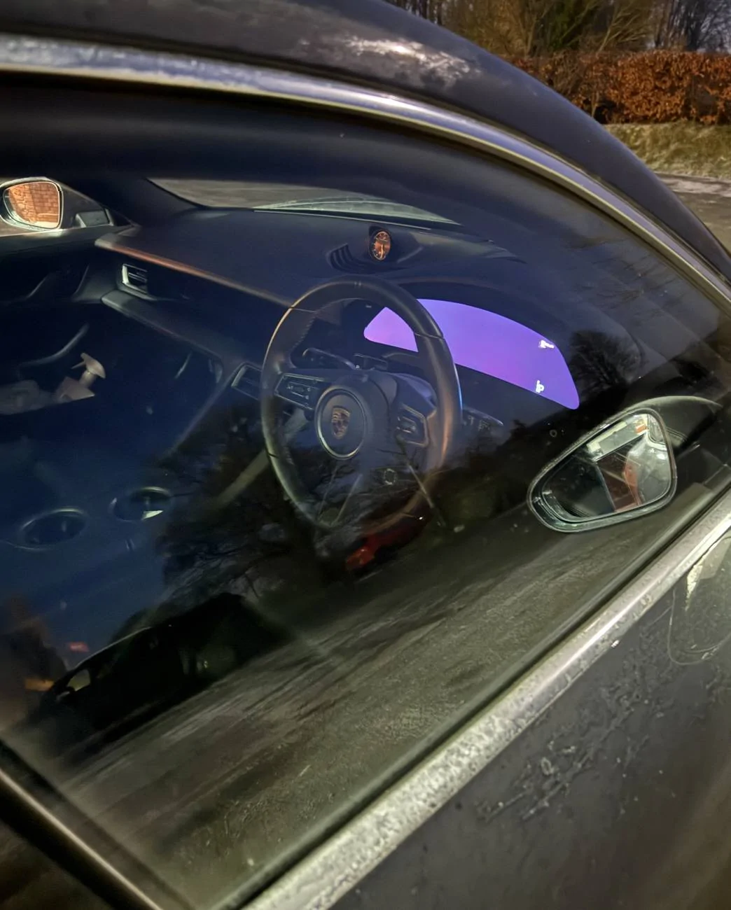

Out of interest, if your car is locked and your turn on the preconditioning / cabin heating via the app, does your instrument binnacle partially light up?
yeah, does the same thing.
