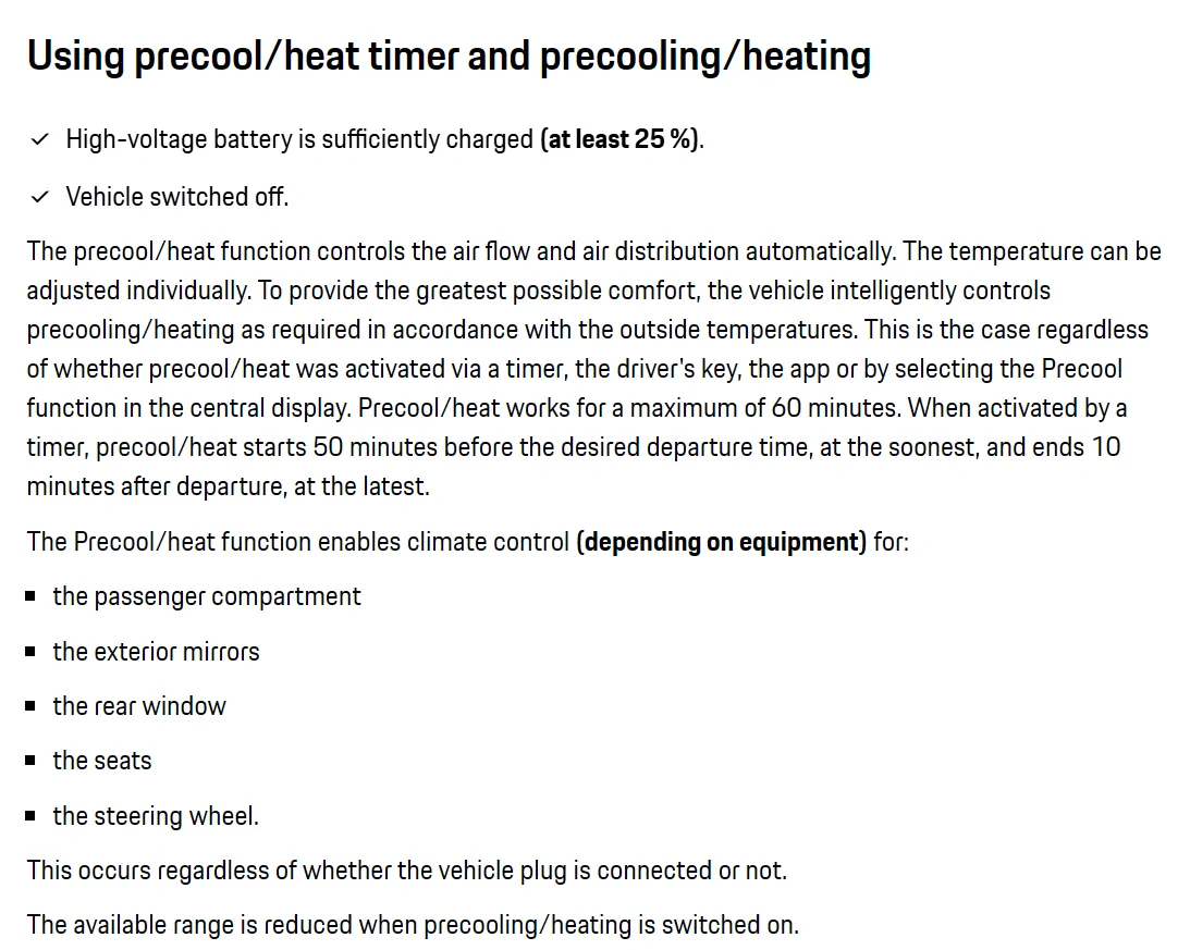

That's not correct in my experience (J1.1). The rear demister will automatically be turned on (and therefore the mirrors too) when in preheat assuming the ambient temp / detected moisture meets the pre-set criteria. Mine often came on in winter - rear window, mirrors, wheel) during a pre-heat.
I only ever pre-heated for 20 mins or so if the car was outside / work car park - everything demisted and interior toasty (21C).
It would be useful to have the interior temp but if 5C outside then there's a good chance the interior of the car will be similar if parked outside.
From the manual:
From the manual:
That's good to know.
I was simply going off what I can see in the app, where I can set a cabin temp and individual seat heating, and the heated wheel is linked to the dirver's seat setting.
I had no idea it intelligently did the rear window.
