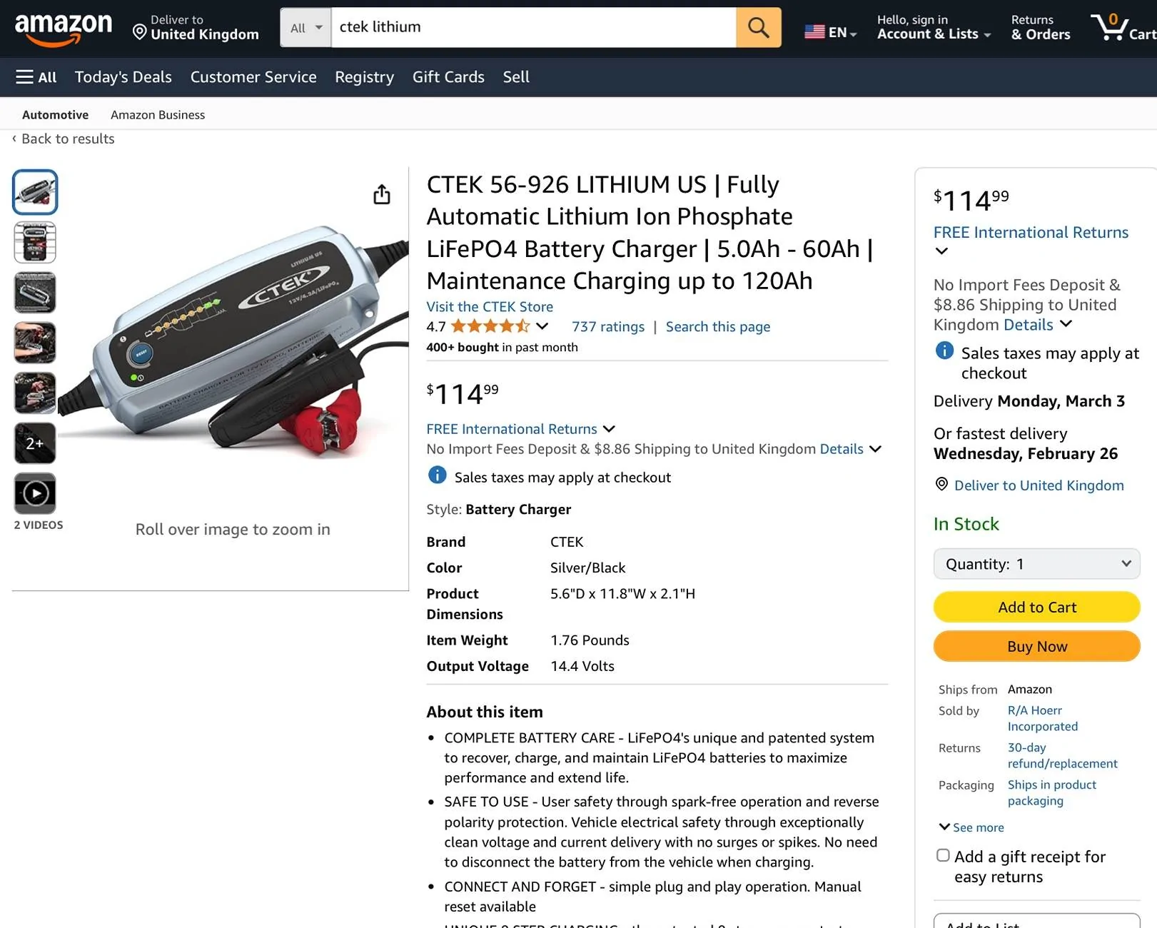

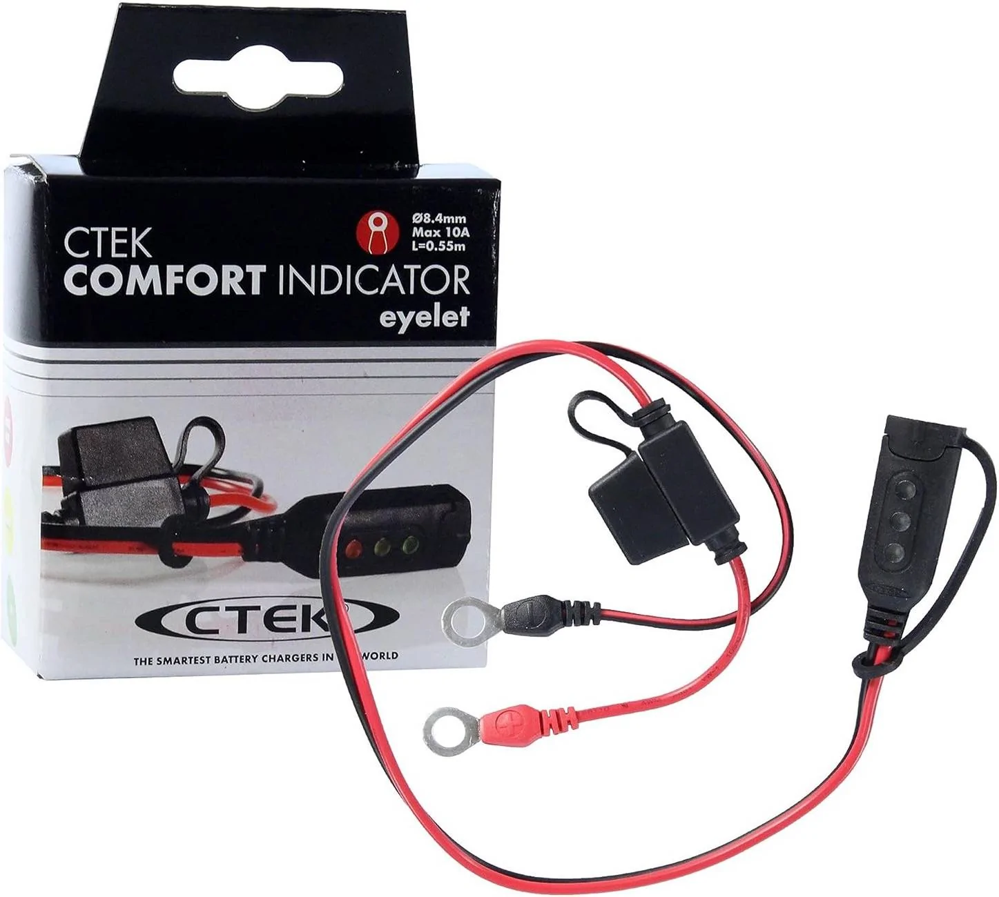

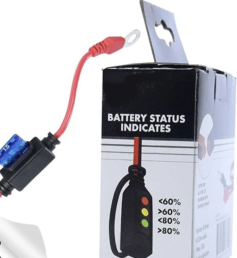

Will be interesting to hear your experience with this battery indicator.
I thought these were designed for Lead acid batteries and have a green indication at full Lead acid battery, ie 12.7 volt.
Since the Taycan is equipped with a LFP battery with a very narrow difference between 20 to approx 80% SoC at 13.x volt, I wonder how it will work. LFP batteries are not easy to measure SoC from.
Or is this unit as described designed for Lithium batteries?
I think that it is only for 12V lead acid batteries1
