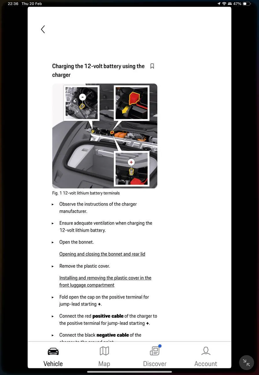

Even the user guide shows how to charge the 12 Volt in detail - no suggestion of disconnecting battery from car. They even suggest it for long term use if away from car for extended time - if that was going to have the consequences you suggest I don’t think it would be a recommendation.
I respect your view but it flys in the face of documented recommendations from Porsche.

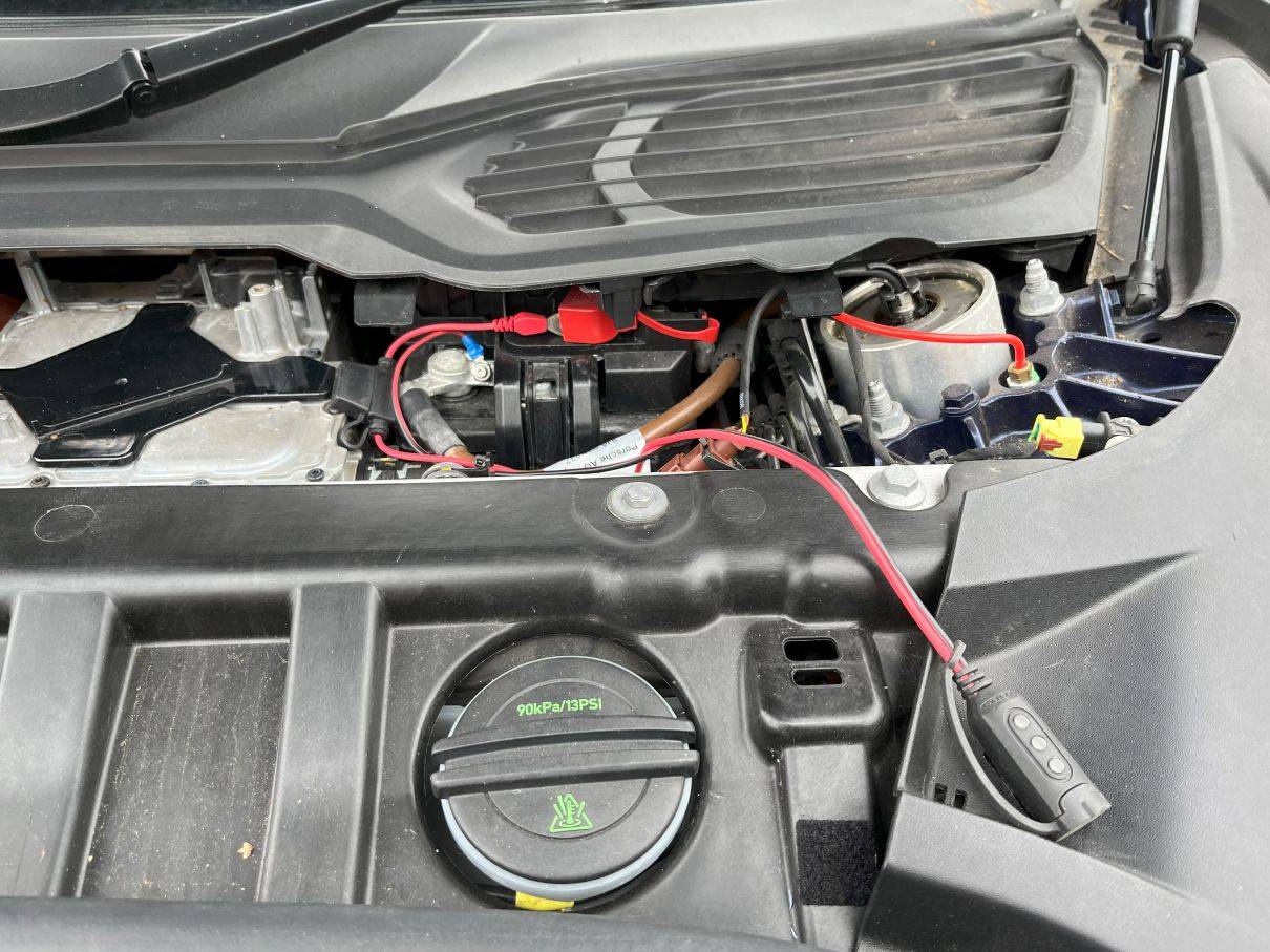

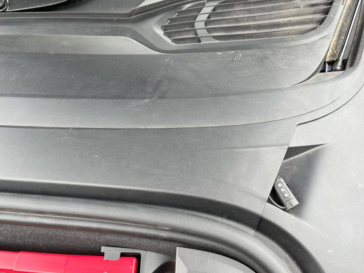

This was my wiring job for the CTEK connection
Porsche Taycan How to avoid 12v battery anxiety IMG_2025
Porsche Taycan How to avoid 12v battery anxiety IMG_2026
Yes I copied your method for the CTEK connection and it has made it very easy to connect without having to take the plastic cover off.

  • Use the CTEK eyelet connecter to hard wire the charger to the battery in the froot. It really isn't obvious where to connect it because you can only see the front half of the battery when you take the plastic cover off. I went to the Porsche dealer seeking their advice and they very kindly installed the cable for free. I turns out that you need to also remove the second plastic cover to expose the rest of the battery and appropriate connectors. You need to remove the windscreen wiper to do this but is was a small job. I do have a CTEK extension cable but the standard cable is long enough to hang out past the main plastic cover. However, the extension cable could be useful if you don't have a garage, allowing you to route the cable to somewhere accessible from the outside so you can shut the froot/frunk.
