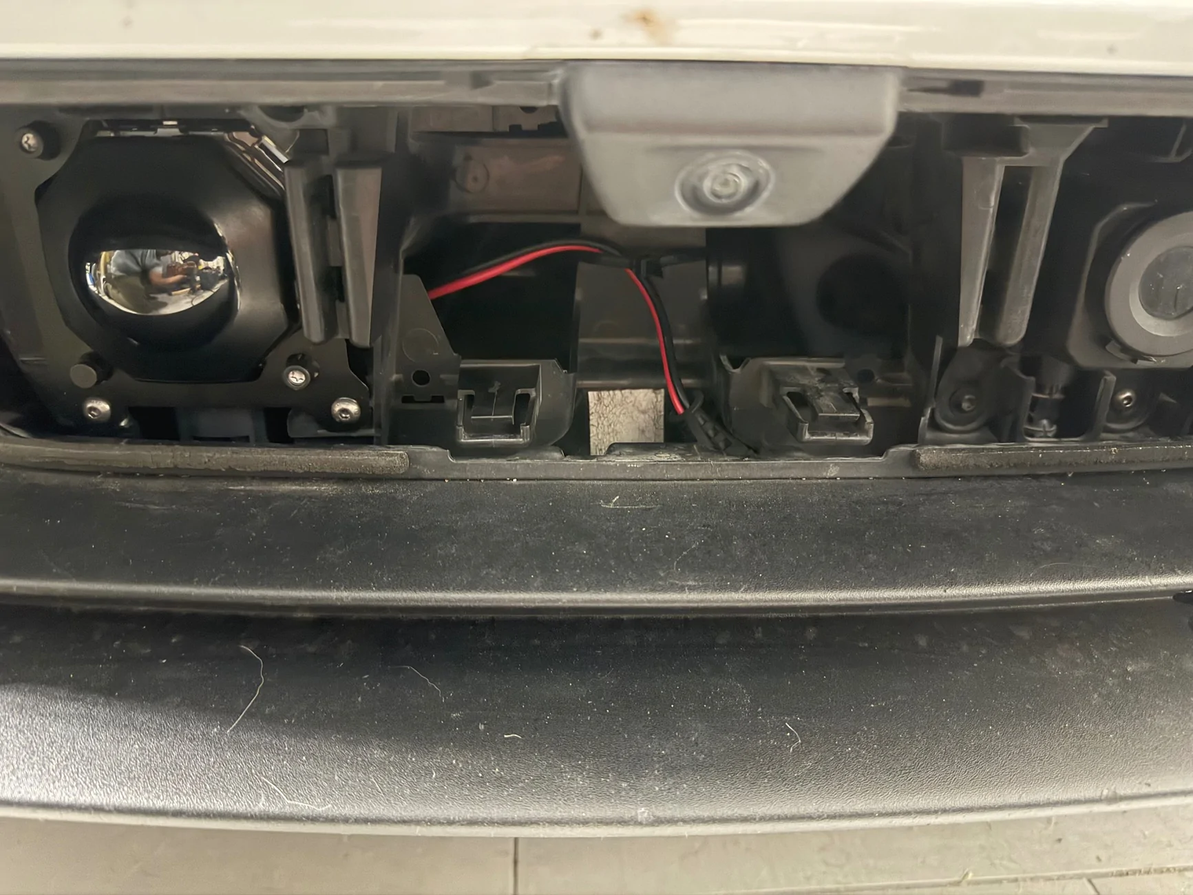

Sounds like this is what you’re talking about. About a month ago I ran a NOCO lead from the battery behind the ACC/NV grille that pops off.

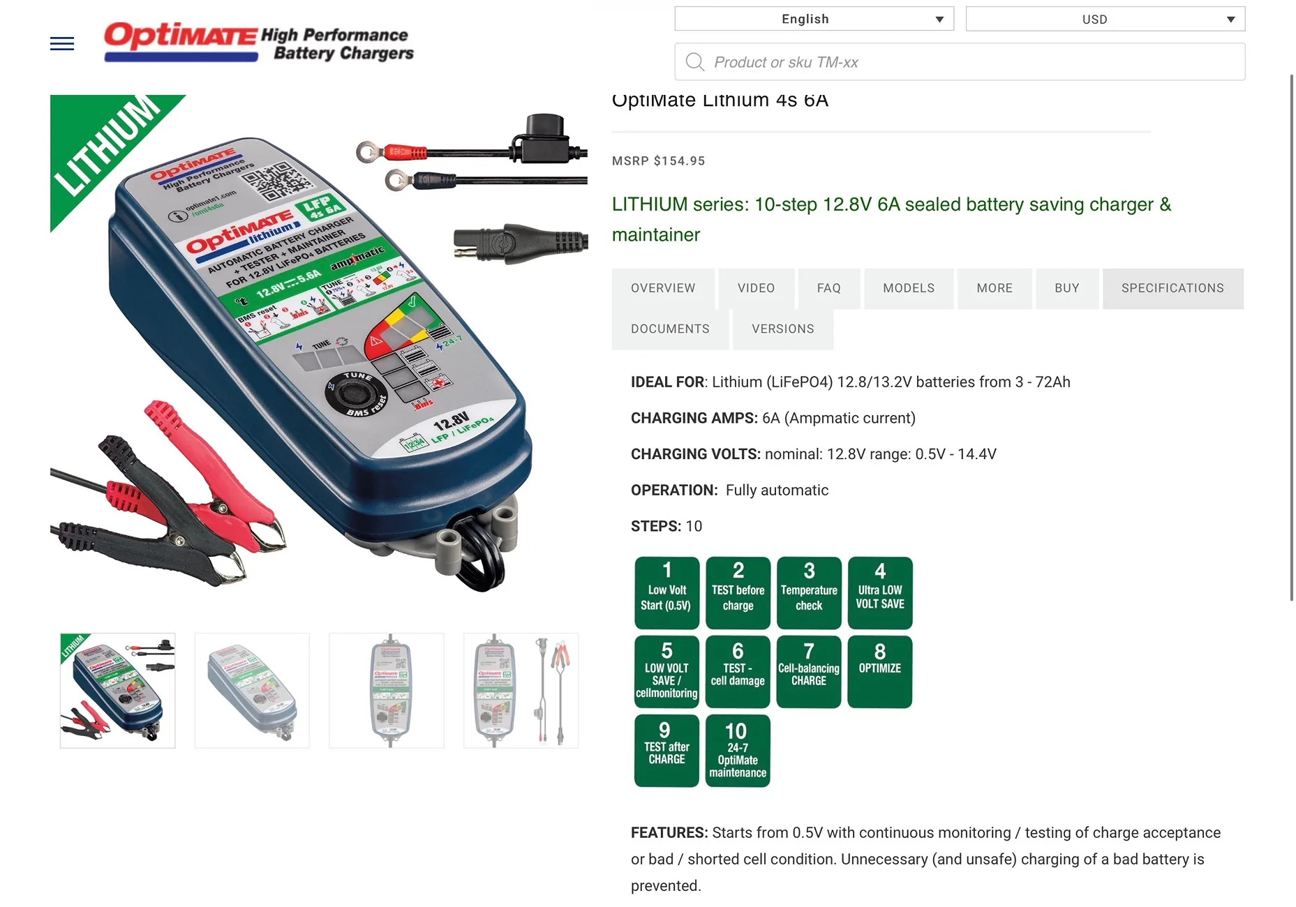

I would install Optimate..
I could be mistaken, but I don’t think Optimate makes one that can charge to the nominal voltage of the LFP in the Taycan. Last I checked Optimate’s LFP charges to around 12.8V nominal while the LFP in the Taycan and programmed to the gateway looks for a ~13.5V nominal.
I like something like the NOCO that can kick that LFP up to 14.6V.
