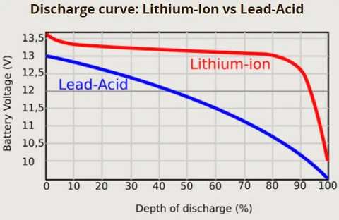

My car is also 6 years old and has had the 12 volt battery replaced at least once before. But still have issues when leaving the car for more than a few weeks. The main battery does not seem to recharge the 12 volt battery as it should. I suspect this is due to the 12 volt battery being a LiFePO, which seem to have a very shallow voltage curve between 20% and 80% SoC. Seems the Porsche BMS can not detect the correct level of discharge until it is too late?
https://cdn.shopify.com/s/files/1/0746/0415/1079/files/12v-lifepo4-volttage-chart.jpg?v=1724395687
It is now dead on my driveway after 8 weeks standing and no way to get into the car at all. The emergency key in the drivers door does nothing, it turns but there is no mechanical linkage. Only way now for me would be a crowbar to get into the frunk or open the door. But I will let Porsche handle that.
