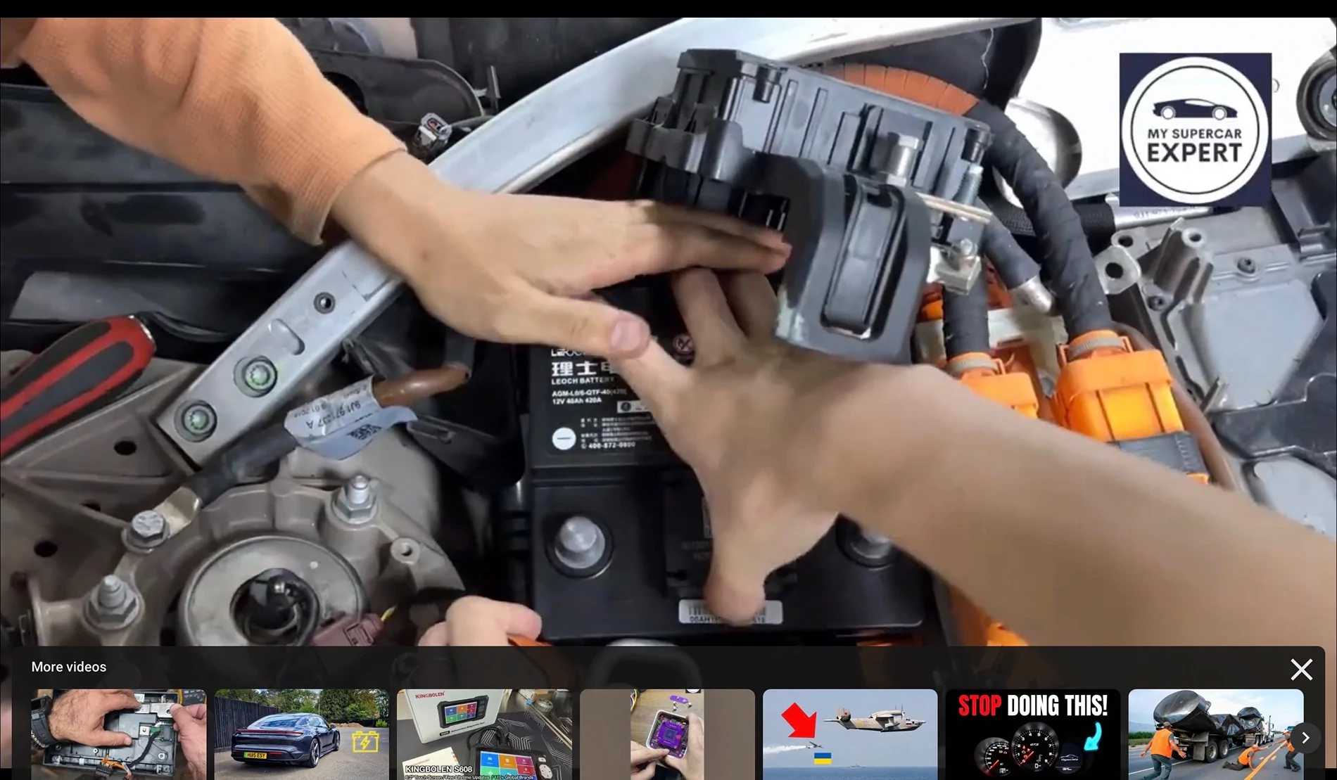

The video shows a 40ah AGM battery same as the Taycan lithium. Who knows if that’s accurate though, I’m still contemplating some 80,000 lumen reverse lights.
If the AGM battery is the same size/volume in cubic inches to fit in the existing area the Lithium ion battery is located then there is no way the AGM battery has the same capacity.
Lithium-ion batteries are dramatically more energy-dense than AGM batteries of the same size—typically 3× to 10× more, depending on the specific chemistry.
There is no problem swapping out the Li-ion battery with an AGM battery of the same dimensions but the capacity of the AGM battery will be significantly lower in capacity due to it’s much lower energy density.
Regardless the useable capacity is about 50% of the lithium.

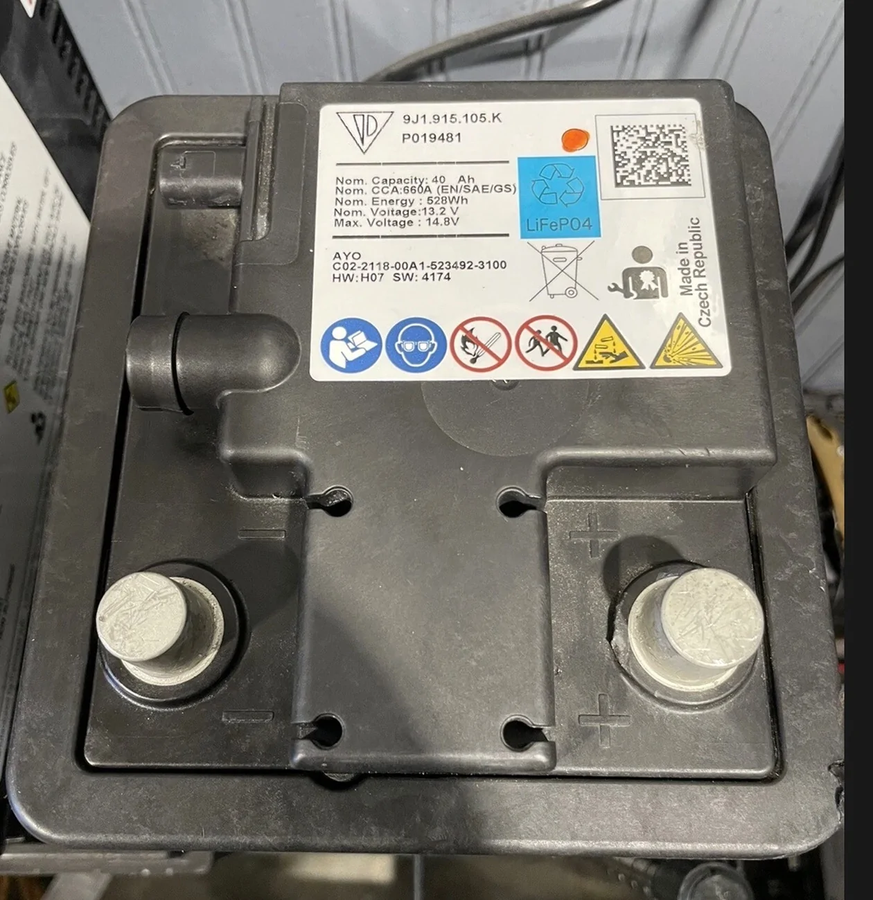

Porsche Taycan 12V battery: convert to a cheap alternative? IMG_8781
Porsche Taycan 12V battery: convert to a cheap alternative? IMG_8741
Easily 50% less capacity if the rated capacity of 40Kwh was available in the same size.
I’ve had to double the size of my AGMs to avoid deeply discharging them to get 5-7 years lifetime. Every time you drive an AGM battery below 20% you take years off its life. The Li-ion doesn’t get damaged from deep discharge.
Yes, we hear what you’re saying and I tend to agree if they had managed to wedge a 100Ah H3 battery in there but the use case in this example doesn’t hold true.
Like someone mentioned, this may be an area where Porsche didn’t opt for the better engineering or supplier because H3/LN0 AGM batteries definitely have the same, or higher, 40 Ah rated capacity as the stock lithium battery.
