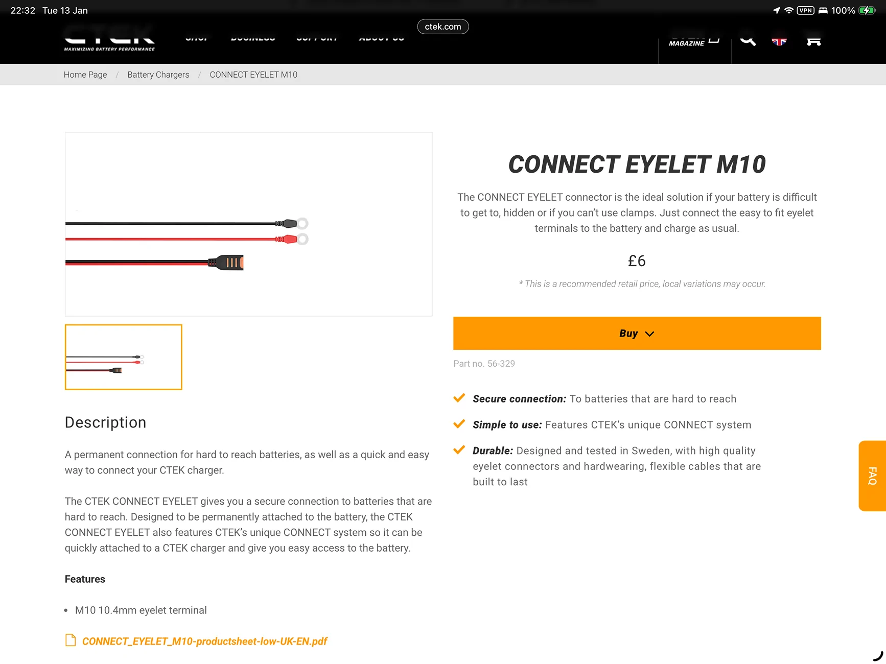

I have for some time been thinking of installing one of these CTEK cables on the 12 volt battery. And then hide the plug somewhere accessible without requiring to open the bonnet. However I have earlier not done so, since Porsche could void the warranty due non approved accessories ??
After the latest episode I will however ask Porsche to install this cable. Lets see what the response will be. It is far to complicated to open the bonnet otherwise.
What do you think?
Porsche Taycan 12V battery: convert to a cheap alternative? IMG_2899
edited to include photo. It was late after a long day.
