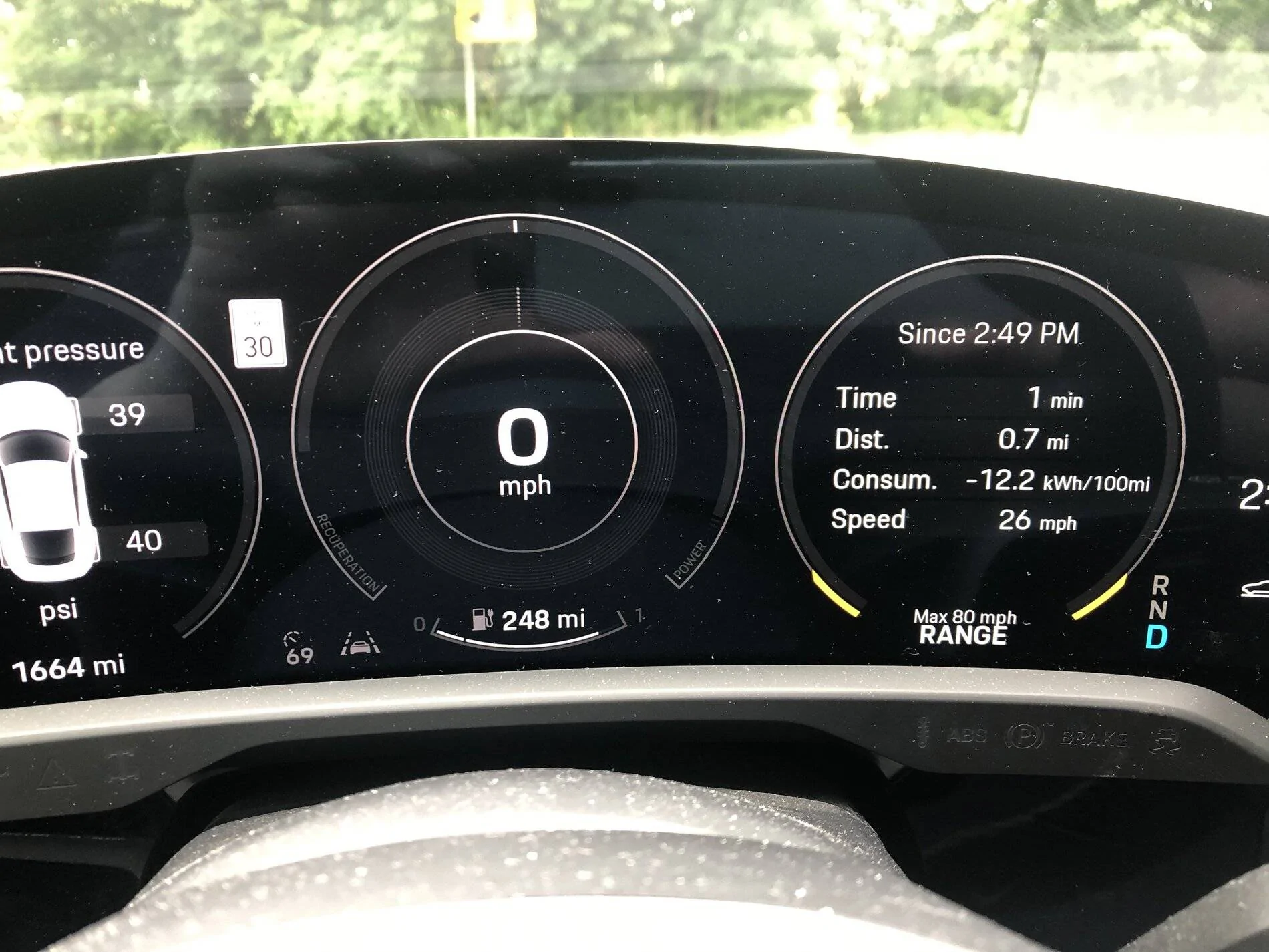

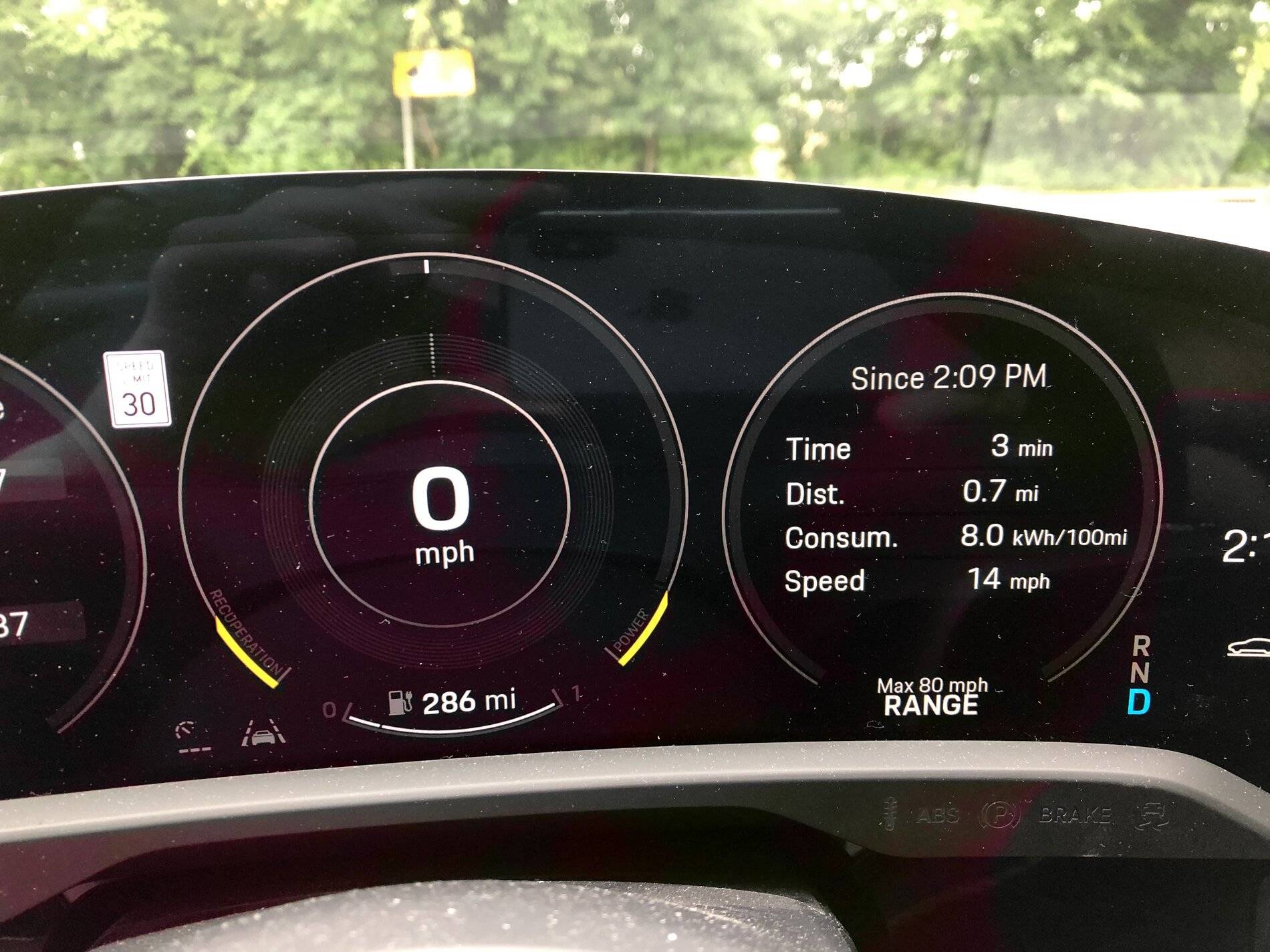

I will do an experiment - downslope at 100% and see consumption at the bottom of the road vs downslope at 85%. If I am correct, the usage will be significantly higher when starting 100%. Will let you guys know.
So here are the results of today - mind you, it is a short distance, so errors could be significant. I drove downhill trying to keep constant 30 mph speed. Just paying more attention than usual to the green regen bar, I noted that at 100% charge, there is a wimpy green bar when braking. At 88 % charge there is a much larger green bar. The two runs are in the same day, probably one hour apart. The time difference on the clock (3 minutes vs one minute) is because I sat in the car for couple minutes during the first run - trying to get my SIM card to work - to no avail.....
Conclusion: regen is reduced to very little (if any) at 100% charge - meaning there is little (if any) buffer above 100%.
Bottom of slope starting 100% : usage 8 kWh/100 miles
Bottom of slope starting 88%: consumption -12.2 kWh/100 miles
Porsche Taycan How to set to profile to only charge to 85% IMG_2623

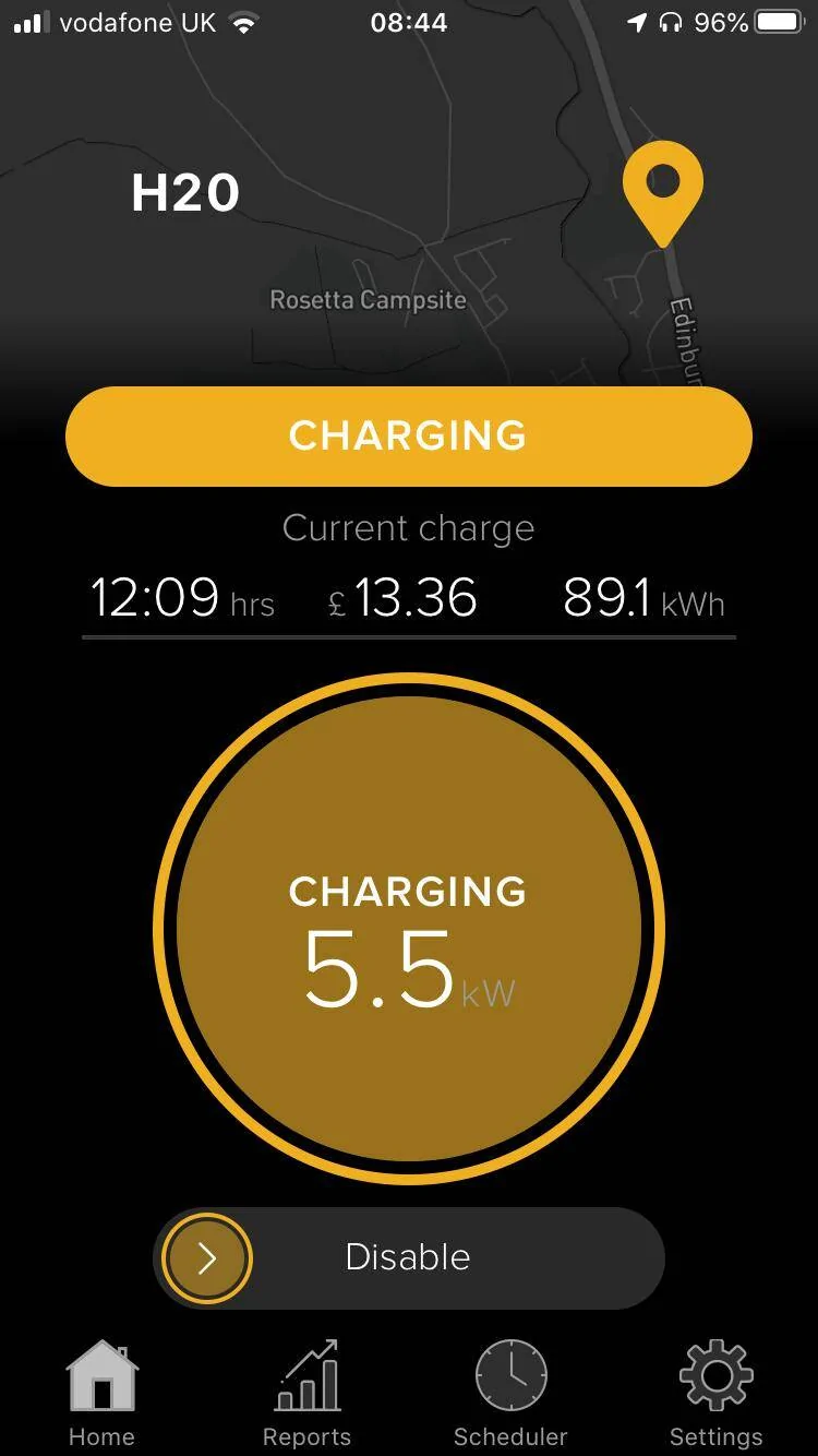

Morning All
First post for me.
I haven't seen the timer setting but not sure why I would want to stop at 85%?
I was advised that it would take 8 hours to fully charge but it is taking 12 hours and my theory is that the 8 hour time is based on the supply to the property being 100 amp hour cable. My cable is 80 amp hour and so it must restrict the supply.
Not really a problem but if I arrive home at 9:00 pm the car isn't fully charged for an early start the following day. Liveable with but a little frustrating.
Any comments?
