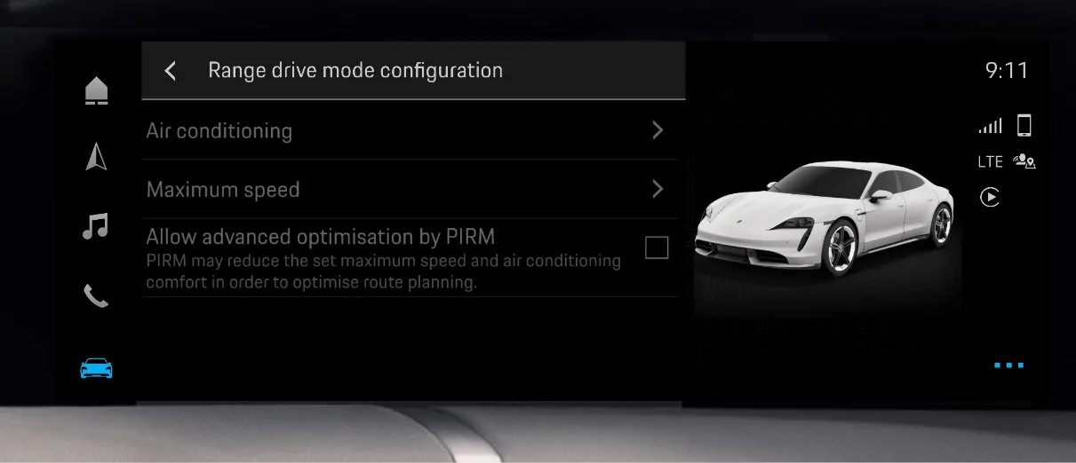

Just curious: is the Range mode 140/150kph bug gone?
Now, without nav destination, the max speed in Range mode is 140kph.
With nav destination it's 150kph.
Can someone check if that bug is gone with the new update?
What is the max speed in Range mode now?
Porsche Taycan Latest Taycan Software Update Findings and Reviews Thread Screenshot_20220814-201948
Pic for attention.
