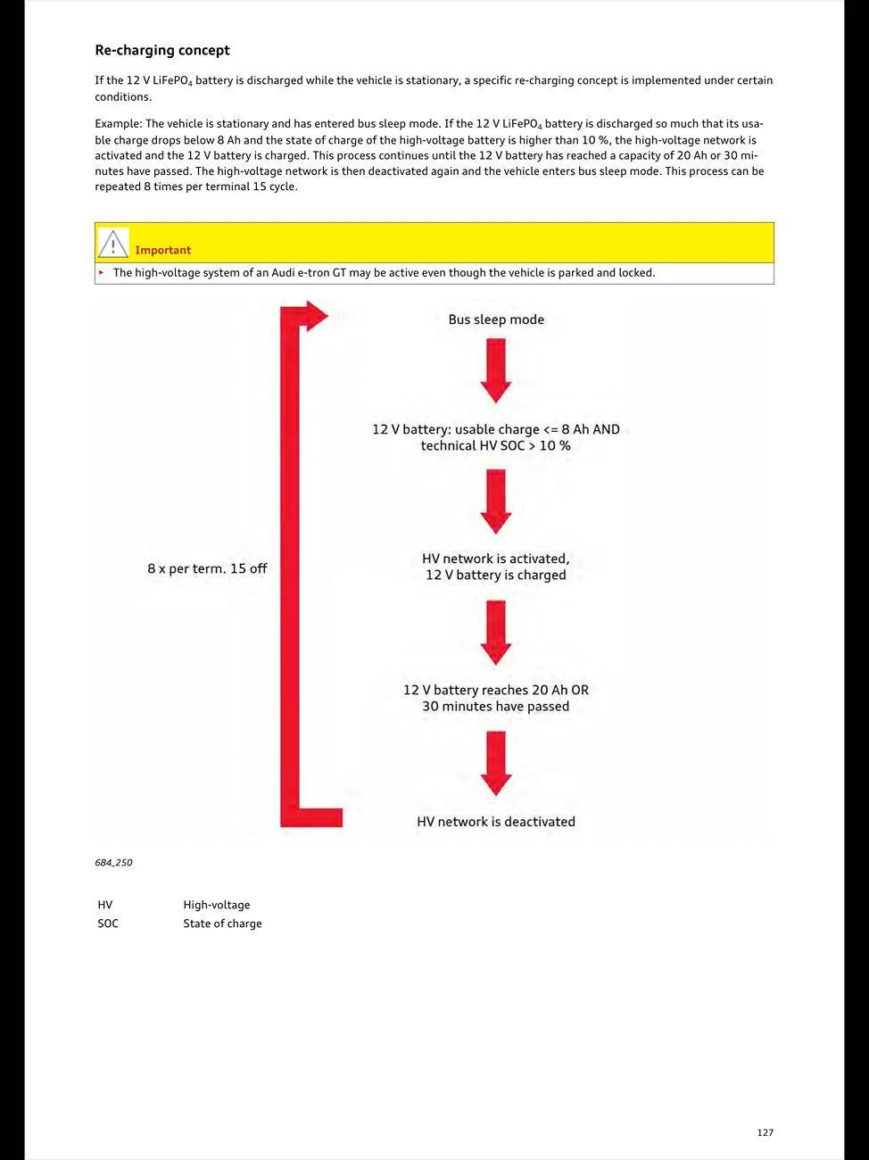

Hey all,
I couldn't find any technical specs like I did with the E-tron GT, but according to the technical documentation (and I believe we share the exact same electric architecture, every last bit aside from invertor differences on the "S")...
" If the vehicle is parked for a long period, the charge level of the high-voltage battery is reduced because the 12 Volt battery is automatically recharged. If the charge level of the high-voltage battery goes below 10%, the 12 Volt battery is no longer recharged "
Another good reason to not drop below 10% SoC when storing the vehicle or have it hover near it to avoid the potential of not recharging the 12v.
if the 12v is drained, the recharge proceedure isn't terrible. On the drivers side of the dash, there is a cover access to the "+", you remove the plastic cover on to gain access to the fuse box, and there is a red plastic cover "+," you plug in the "+" to it, and the "-" of the charger to the door latch. At least according to the e-Tron Manual. In other words, the frunk isn't the only way to access the "+" to charge in the event of a completely drained 12v.
Apologies in advance if the above does not apply to the Taycan^
