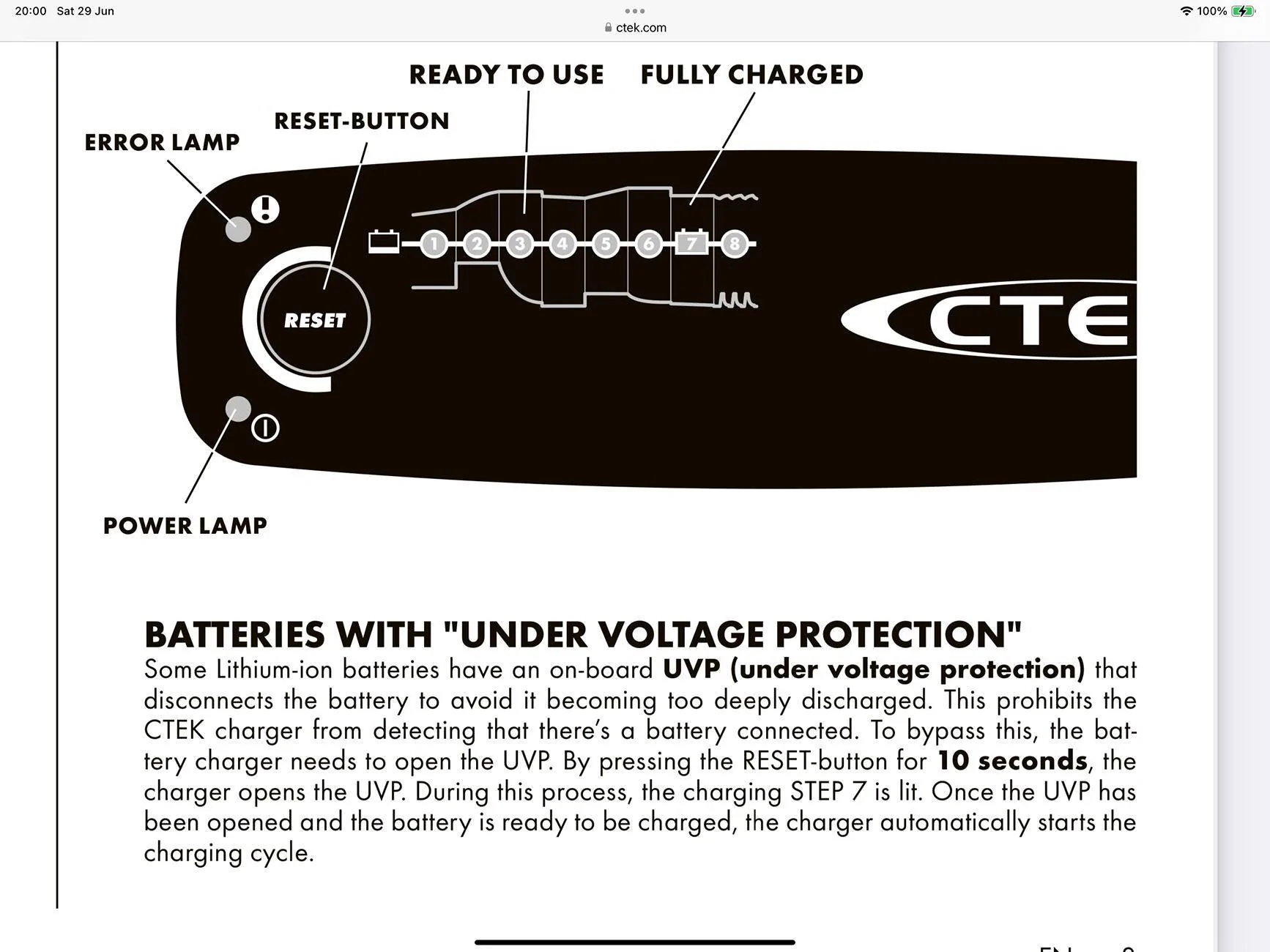

I had my 12v battery go flat after only 3 weeks. I use a Litium Ion CTEK to maintain the battery but this wasn't connected. I had to follow the procedure of providing power to the frunk lock. When I got to the 12v battery it would not accept any charge. I had to get Porsche Breakdown who use a high power jumper and it came to life. So I now always leave the car on the CTEK when left for anything more than 2 weeks and always leave the frunk open. I've also bought a rechargeable battery booster. Don't want to be stranded again.
3,904
3,549
Did you press the reset button for 10 second to start the charging as per manual? I thought that would do the trick without a booster ?
Porsche Taycan Leaving Hood Unlocked While on Vacation IMG_2121
