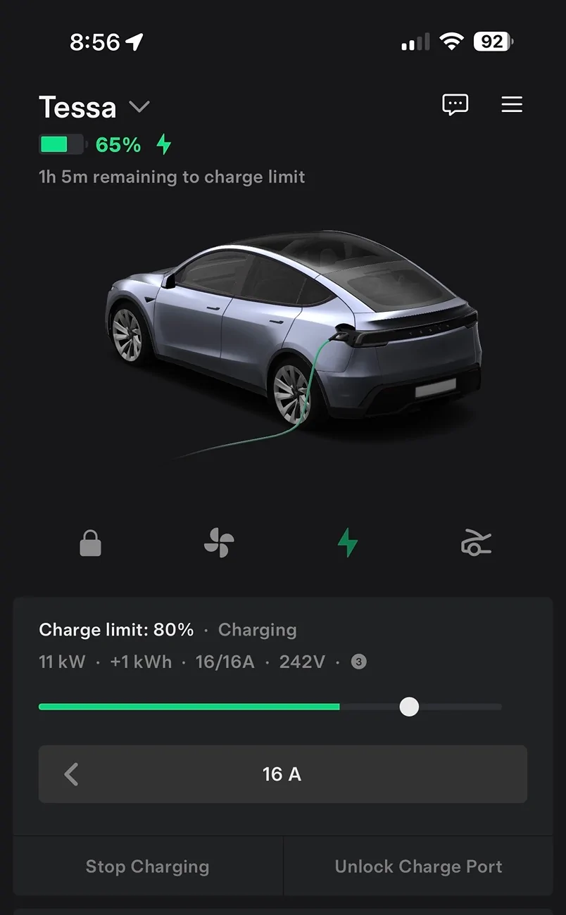

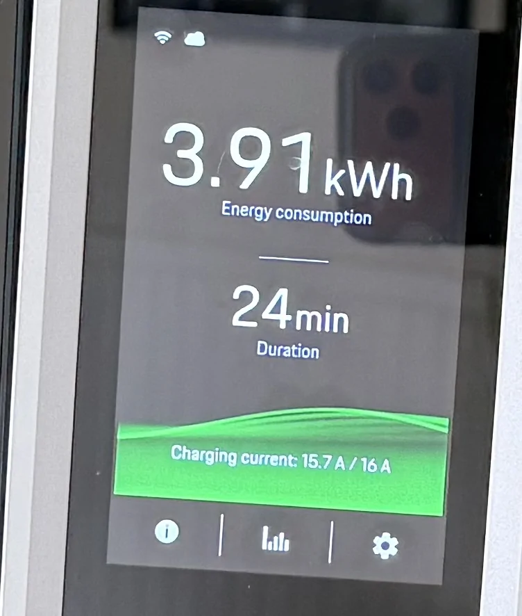

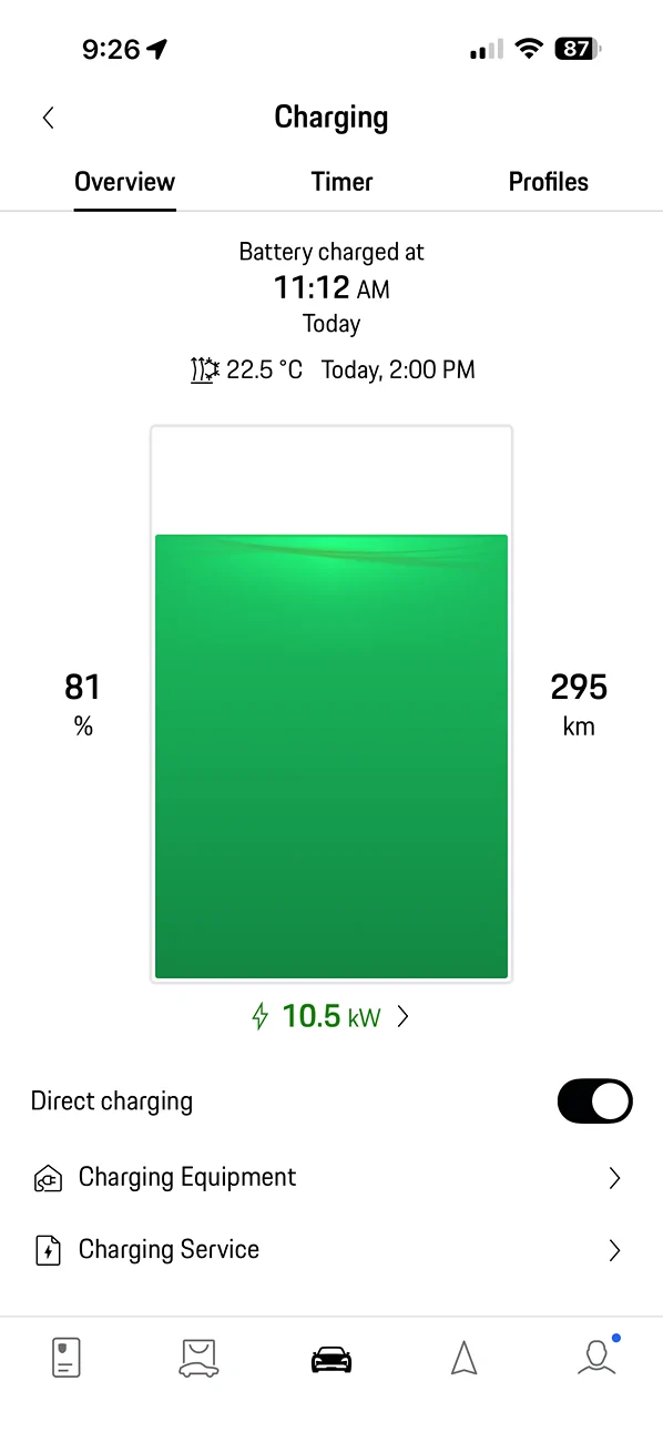

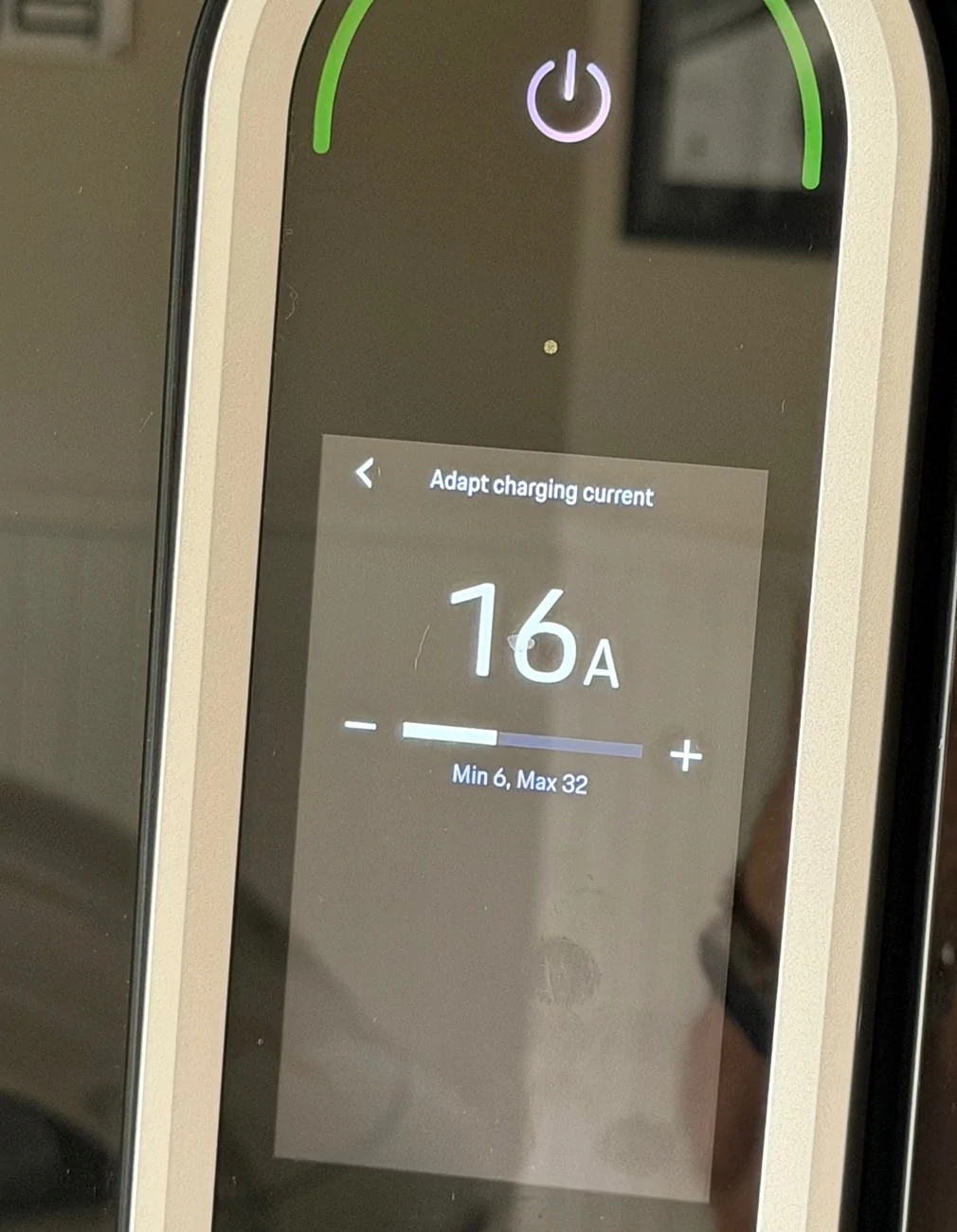

who's EVSE are you using achieve teh 10.4 kW charge rate? pics would help…
what the circuit breaker rating "feeding" the EVSE
Standard Porsche home wall charger. 3 phase power. Charger set to 16A. Turning it up to 32A doesn’t change the actual charging rate at the car. Its stays at 10.5 kW.
Interestingly my wife’s new Model Y 2026 LR charges slightly faster off the same exact Porsche charger at 11kW.
