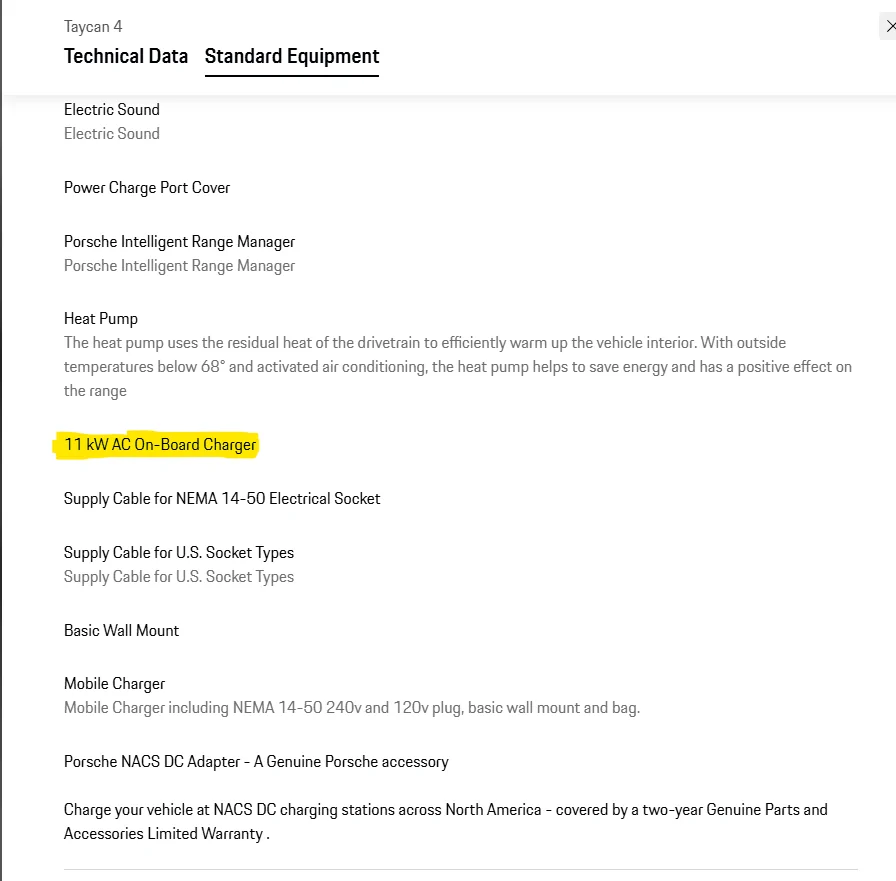

Porsche's website continues to list the 11kW onboard AC charger as standard equipment in the build configuration for the Taycan.
Porsche Taycan Level 2 charging rate with a 50 amp capacity Screenshot 2025-09-25 073820
