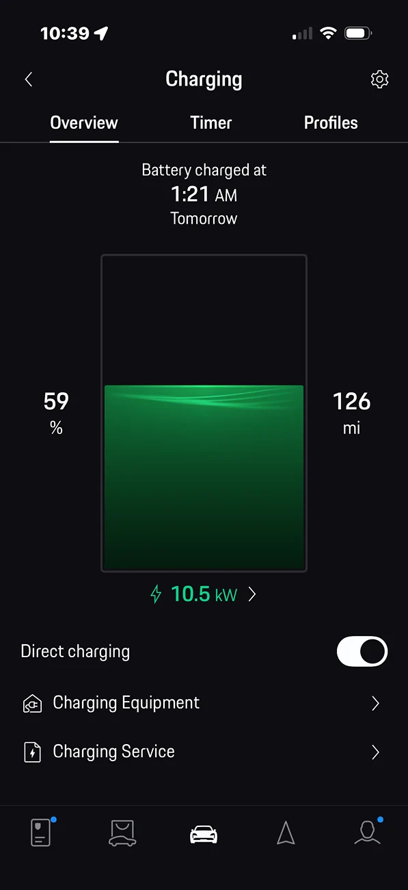

please note the 2nd picture in post #1 of this thread…showing a North American Taycan charging at more than 9.6 kW…
https://www.taycanforum.com/forum/t...-charger-48-amps-not-max-9-6-kw-40-amps.1793/
it's well understood Porsche used to allow 11 kW Taycan to charge at 11 kW with 60/48 amp EVSE's - it's only recently been changed to limit it to 9.6 kw in North America for no published reason from Porsche
the 10.4 kW shown is the amount of power reaching the battery due to charging loss - if you look at the raw power being delivered by the EVSE it was 11 kW as reported by multiple EVSE's including the Porsche Wall Charger sold in North America
there is no question Taycan's used to be able to charge at 11 kW in North America…
This is the info I've been looking for. I don't have enough history with my car, but reading here that NA cars do 11kW and my '22 is down at 9kW has been bugging the crap out of me for the few months that I've owned the car. Your post confirms something has changed (before I got the car), and no one really knows why it changed. Damn.
