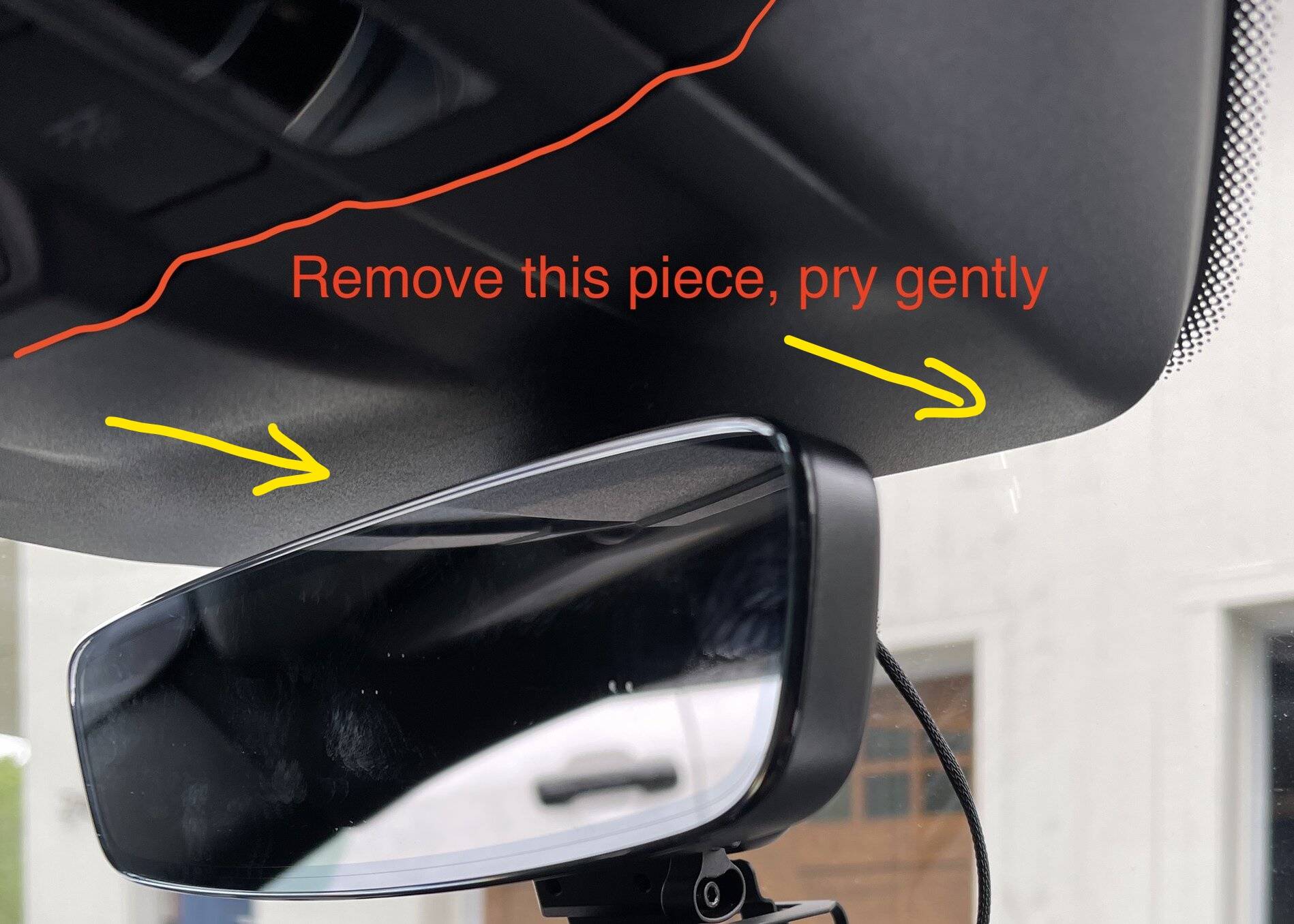

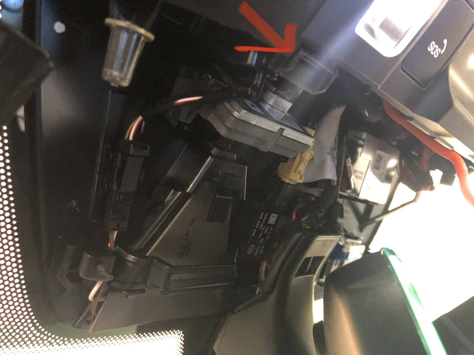

I used this thread to wire in my Uniden R7. It worked great! The only thing I will add is that to remove the first trim piece, I pried down just a little, then pushed it forward towards the front of the car. That is how it unclips. I edited the pick as follows:
Porsche Taycan MirrorTap / Blendmount install for Uniden R7, with pics! step 1_LI
Thanks again!

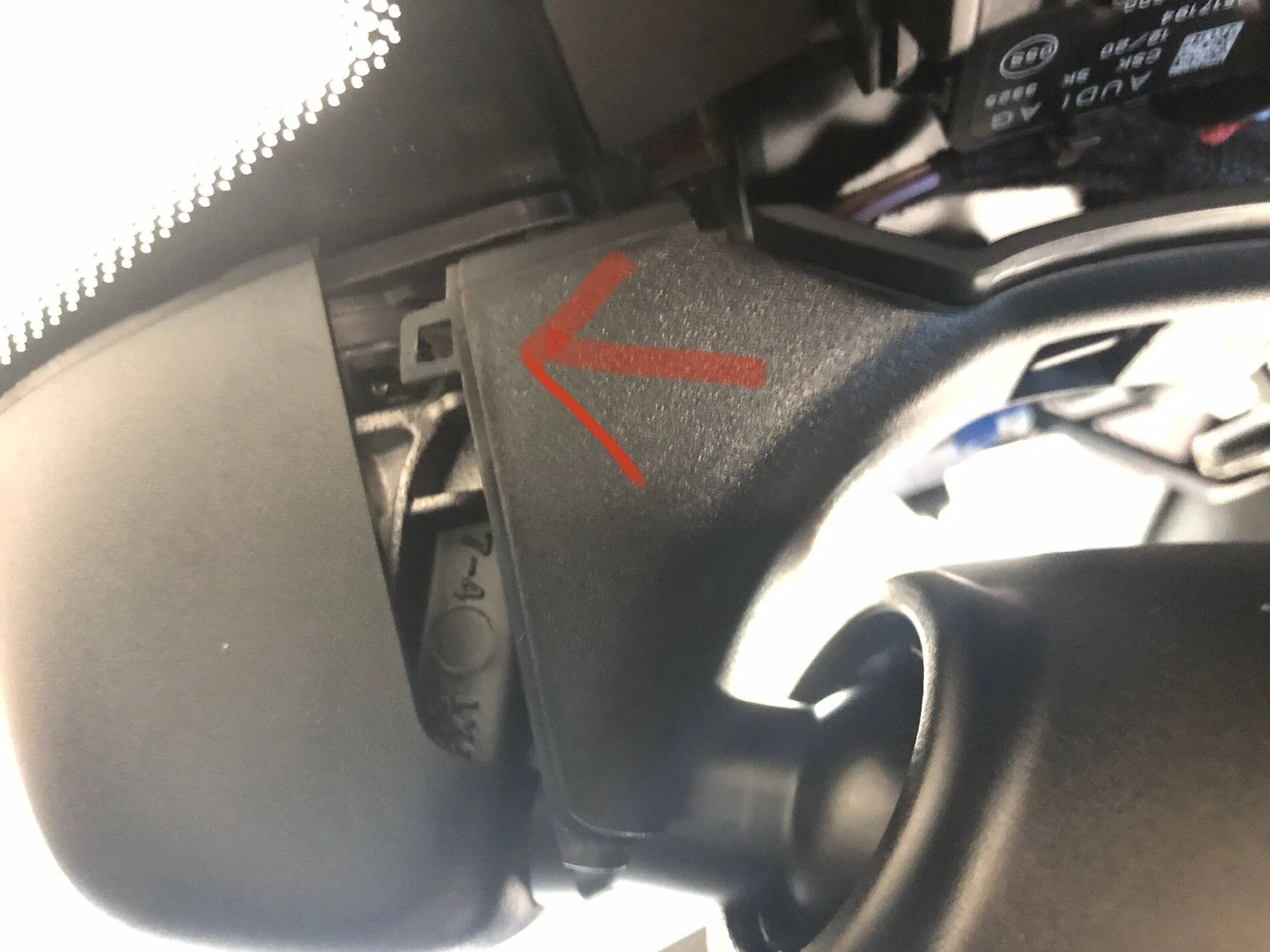

A few notes and photos from the install today to supplement the excellent info so far. Also used a MirrorTap MT-1015 for a Valentine One (gen 1) on the driver's side.
I used two credit cards to open the first panel. As DerekS mentioned, slide the trim remover tools (or credit cards) directly upwards along the two peripheral ends of the horizontal trim border (his red line in his post #21) and you will hear a click. Then push upwards and forward, and the large trim piece will unlock. Note that this will hang by a rubber cord which can be removed.
Porsche Taycan MirrorTap / Blendmount install for Uniden R7, with pics! IMG_6101.JPG
This photo shows the driver's side latch which gets disengaged if you push up with a credit card.
Porsche Taycan MirrorTap / Blendmount install for Uniden R7, with pics! IMG_6103
As for removing trim piece #2, absolutely agree with the O.P. to push in the two sides near the glass to remove the piece. Here is a picture of the two latches you are trying to disengage. The most annoying part after this is the red cord which then suspends this trim piece.
Porsche Taycan MirrorTap / Blendmount install for Uniden R7, with pics! IMG_6102

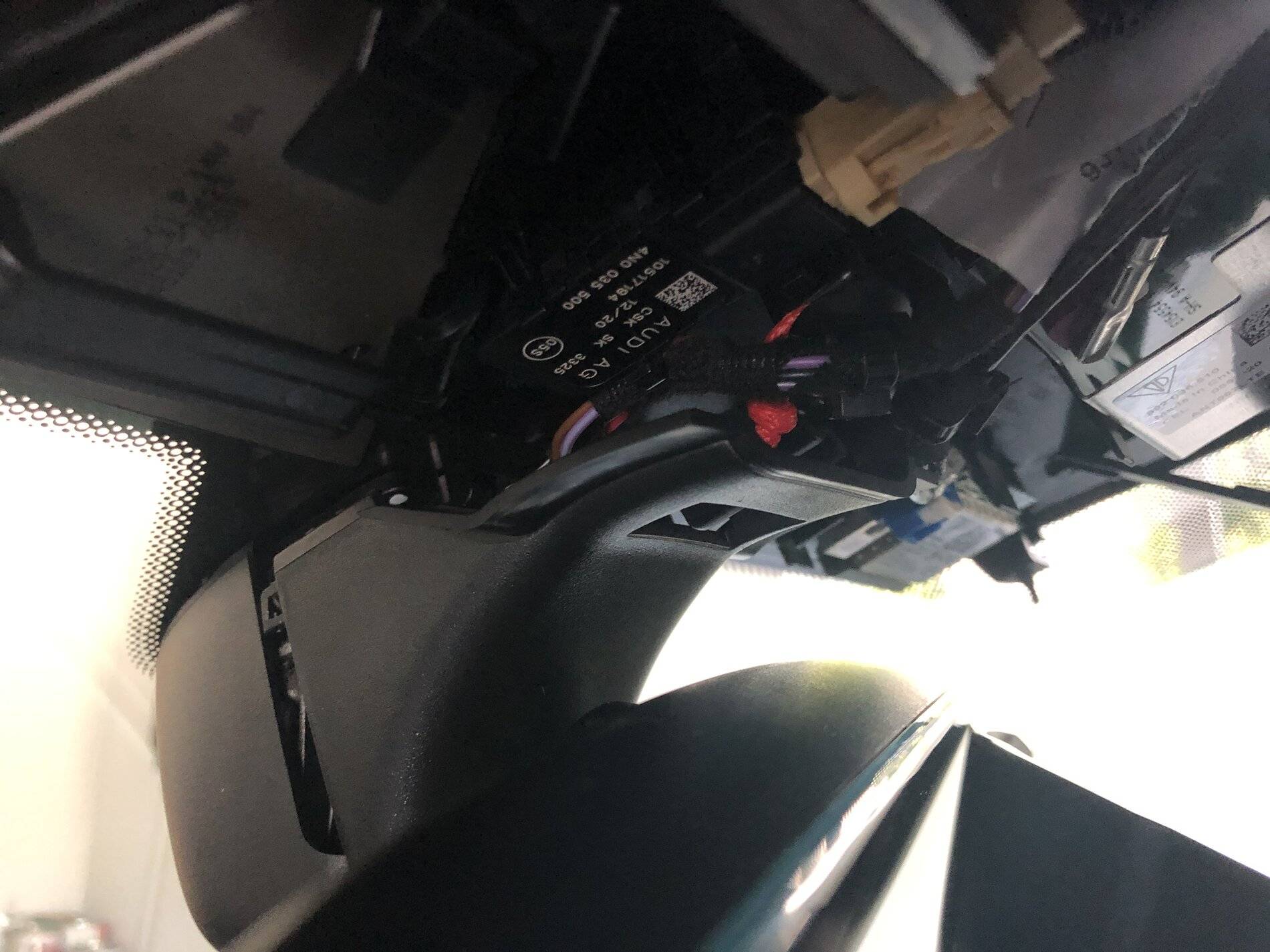

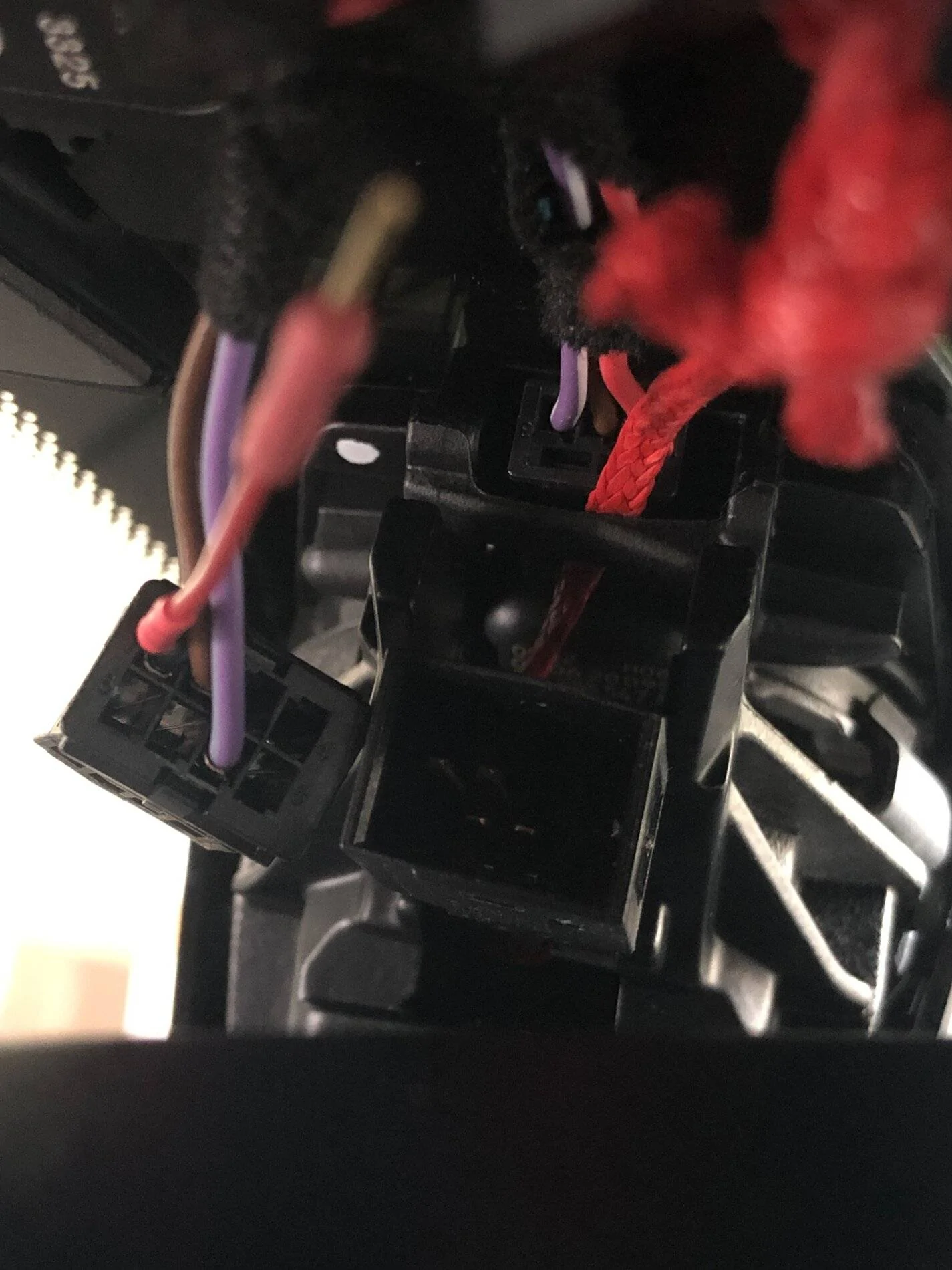

Final pic showing the 12V of the Mirror Tap going in. I used the very smallest tap provided. The next size up was a bit large. There's unfortunately very little room due to the mirror itself, so it's much easier to unclip the connector so you can easily rotate it and find the best angle to put in the 12V and Grd.
Porsche Taycan MirrorTap / Blendmount install for Uniden R7, with pics! IMG_6104.JPG
The only other tip is that I could not figure out how to thread the wire from the front headliner to where I was going to mount the V1 since it appears there is now a foam insert at that seam. I ended up just putting the wire out the side of trim panel #1 so it's pinching the wire a little.

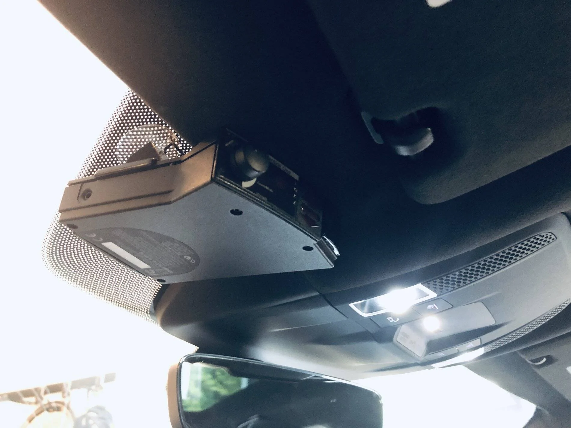

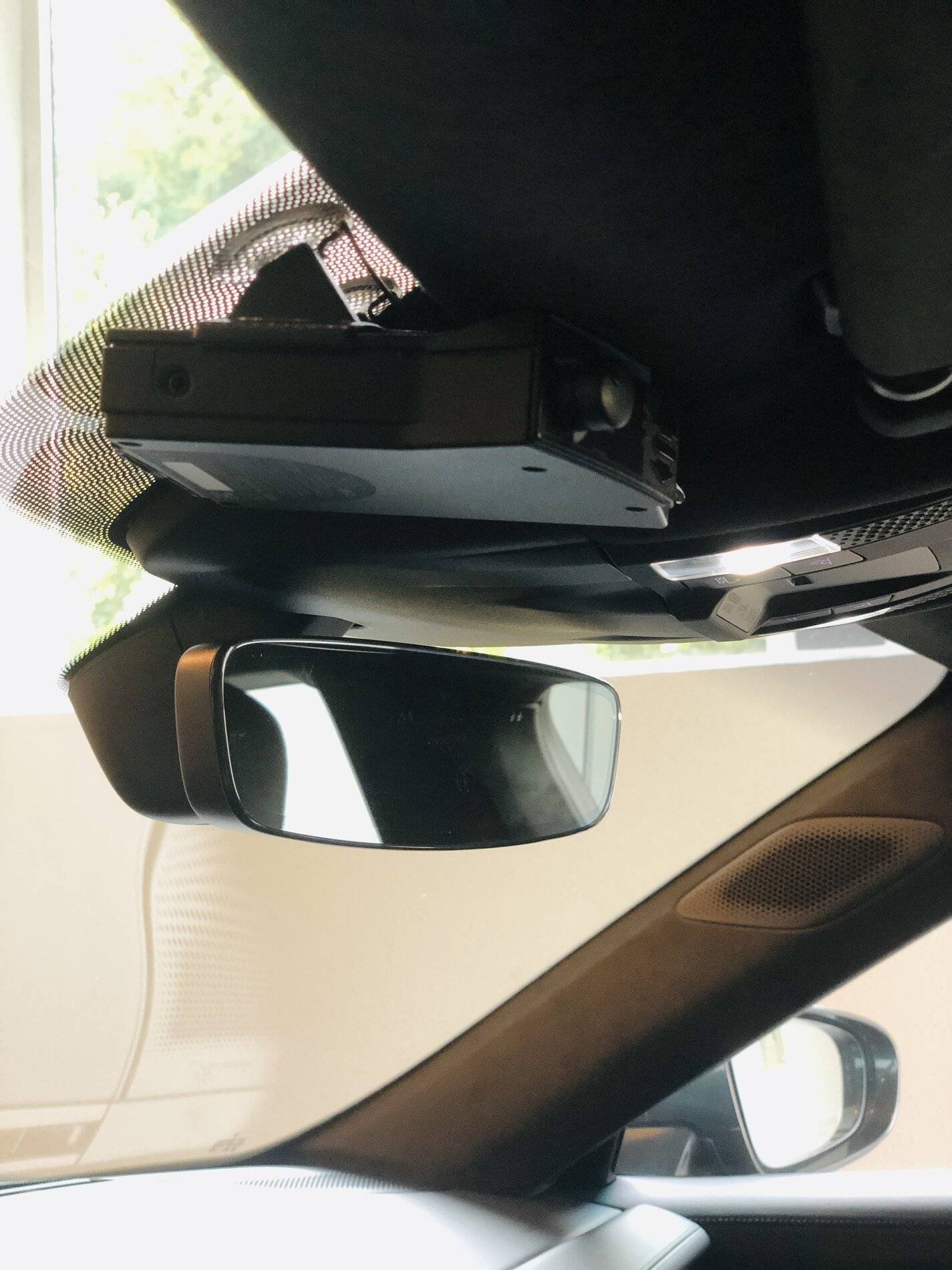

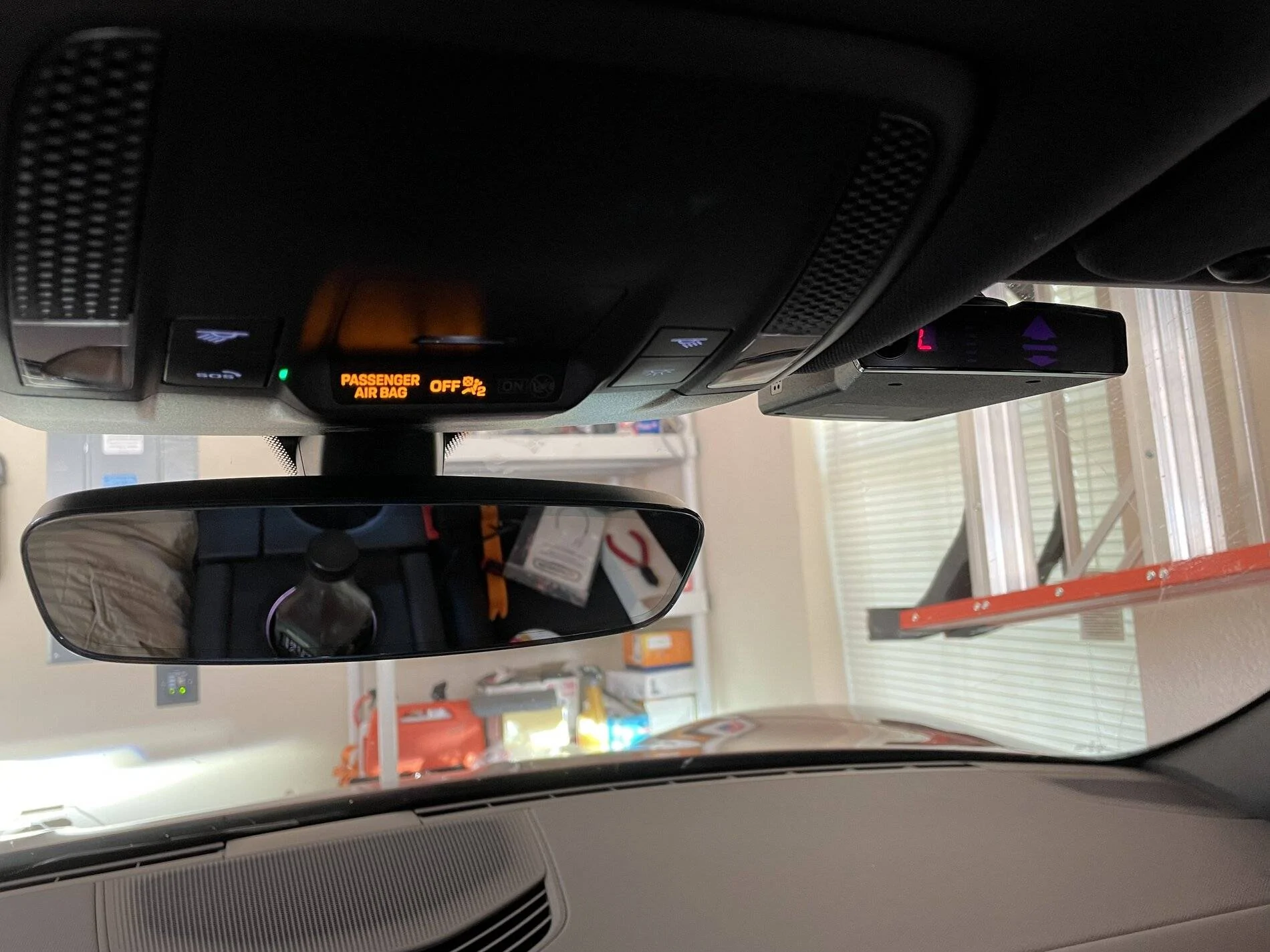

A few more post install.
Porsche Taycan MirrorTap / Blendmount install for Uniden R7, with pics! 5500883B-CBDB-4E76-89F5-9E42E9716DFE
Porsche Taycan MirrorTap / Blendmount install for Uniden R7, with pics! CCA8EF20-5601-490F-B3C7-C048B9307932
Thanks for the tips. Exactly where I was planning on mounting mine (as it is where it has always been in all my cars). Looks great.

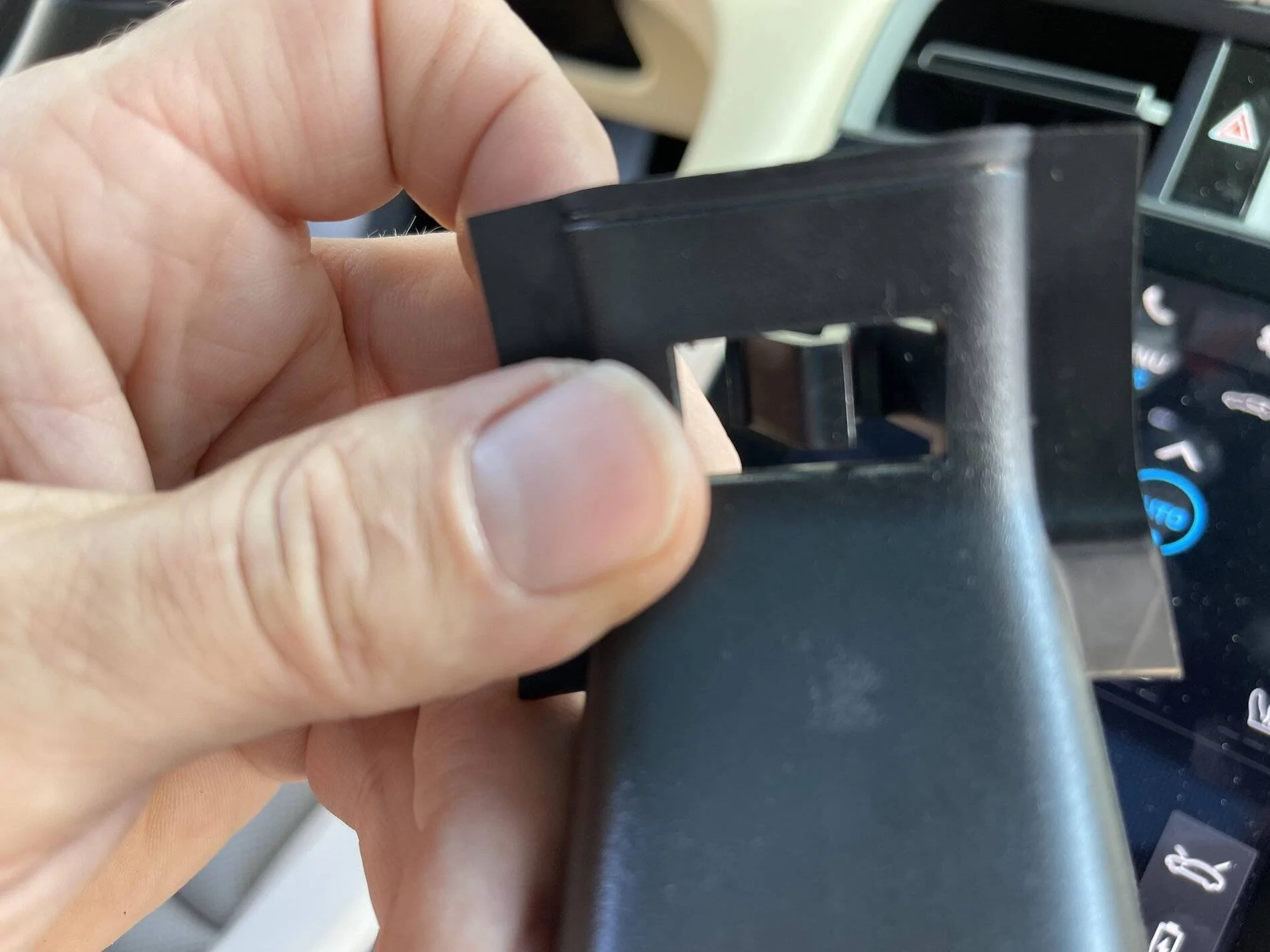

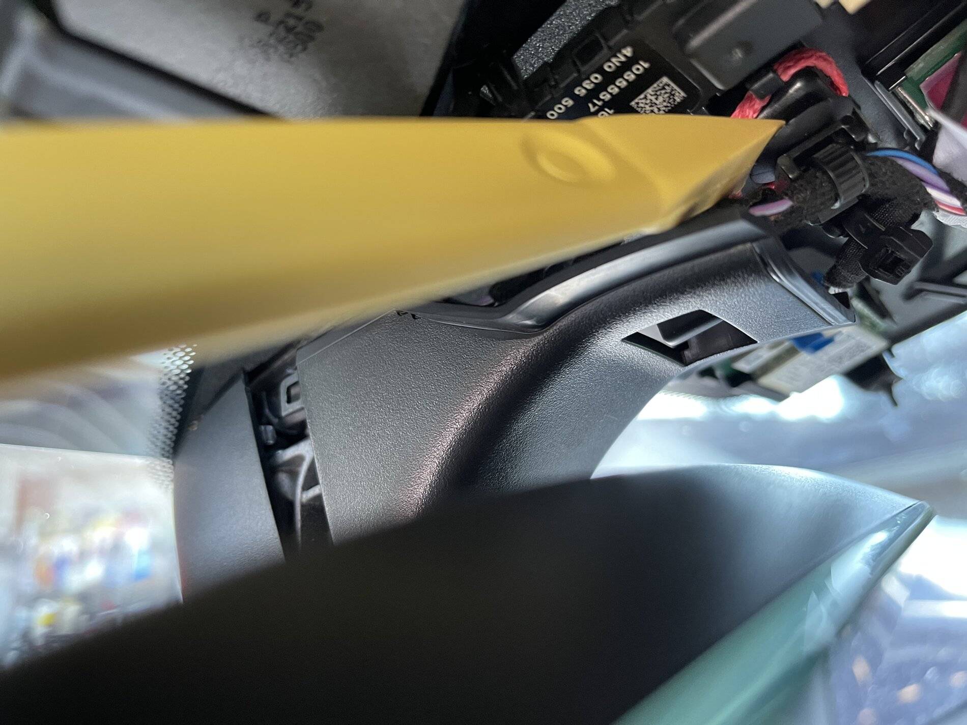

The red string is kicking my butt. Looks like it is around a post that a wire is thread thru a zip tie. Does that zip tie just snap in the post and you can pop it off? See where yellow tool tip is at. Do I pop that zip tie holder out?
Porsche Taycan MirrorTap / Blendmount install for Uniden R7, with pics! 65F01B5A-44B2-4473-BCA7-DB25E46E0E5A
PDACPA
PDA
Feb 21, 2020
959
394
Tampa, FL

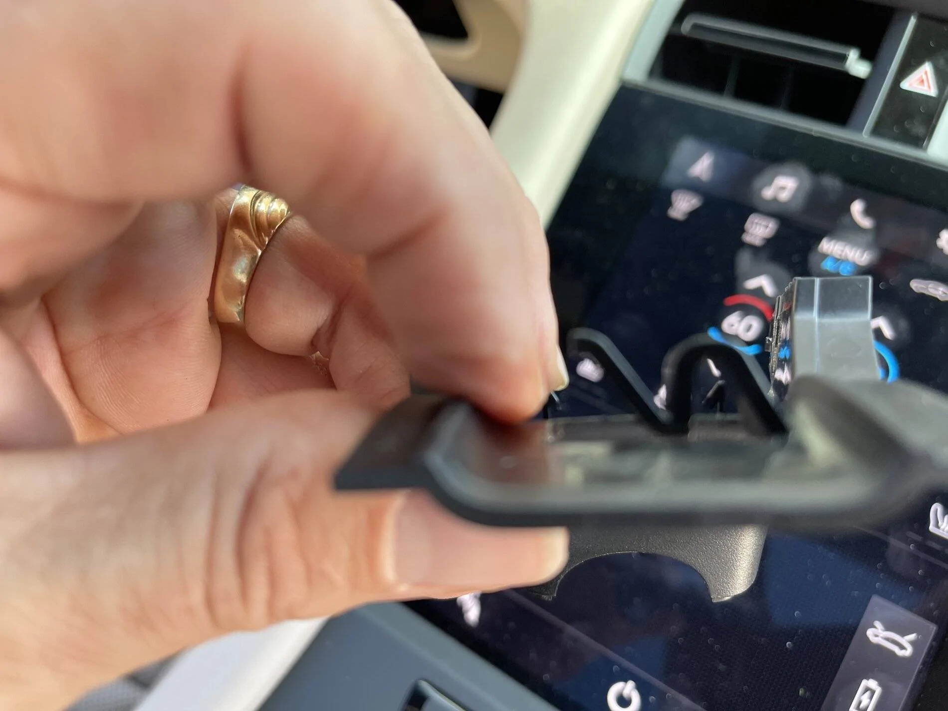

Answered my own question. The cover you are removing has a section you slide the red cord under. Do not pry the part in my previous pic. Not necessary.
Porsche Taycan MirrorTap / Blendmount install for Uniden R7, with pics! F12A4B8D-118A-43D1-BACB-D4BD39BDDC8D
Porsche Taycan MirrorTap / Blendmount install for Uniden R7, with pics! B6CF7DD8-FB23-4F08-A918-1DEA100E019E
