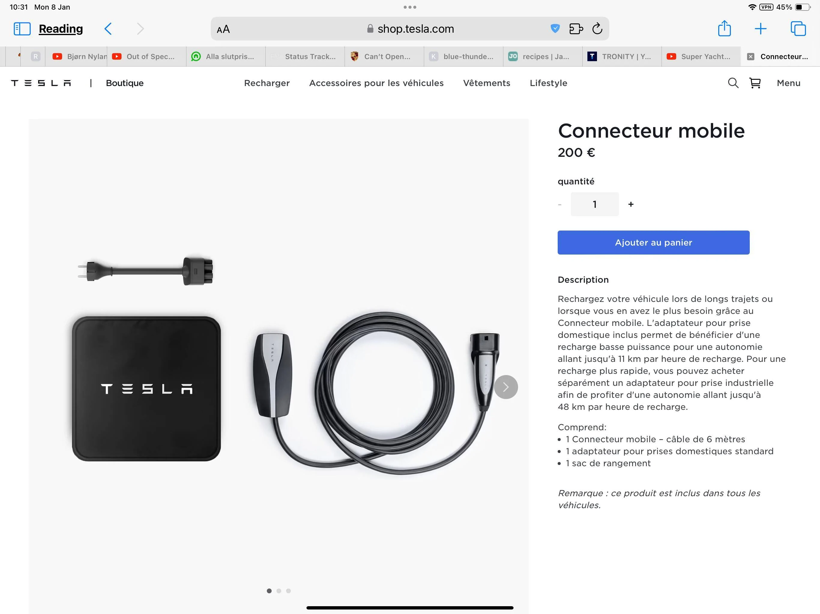

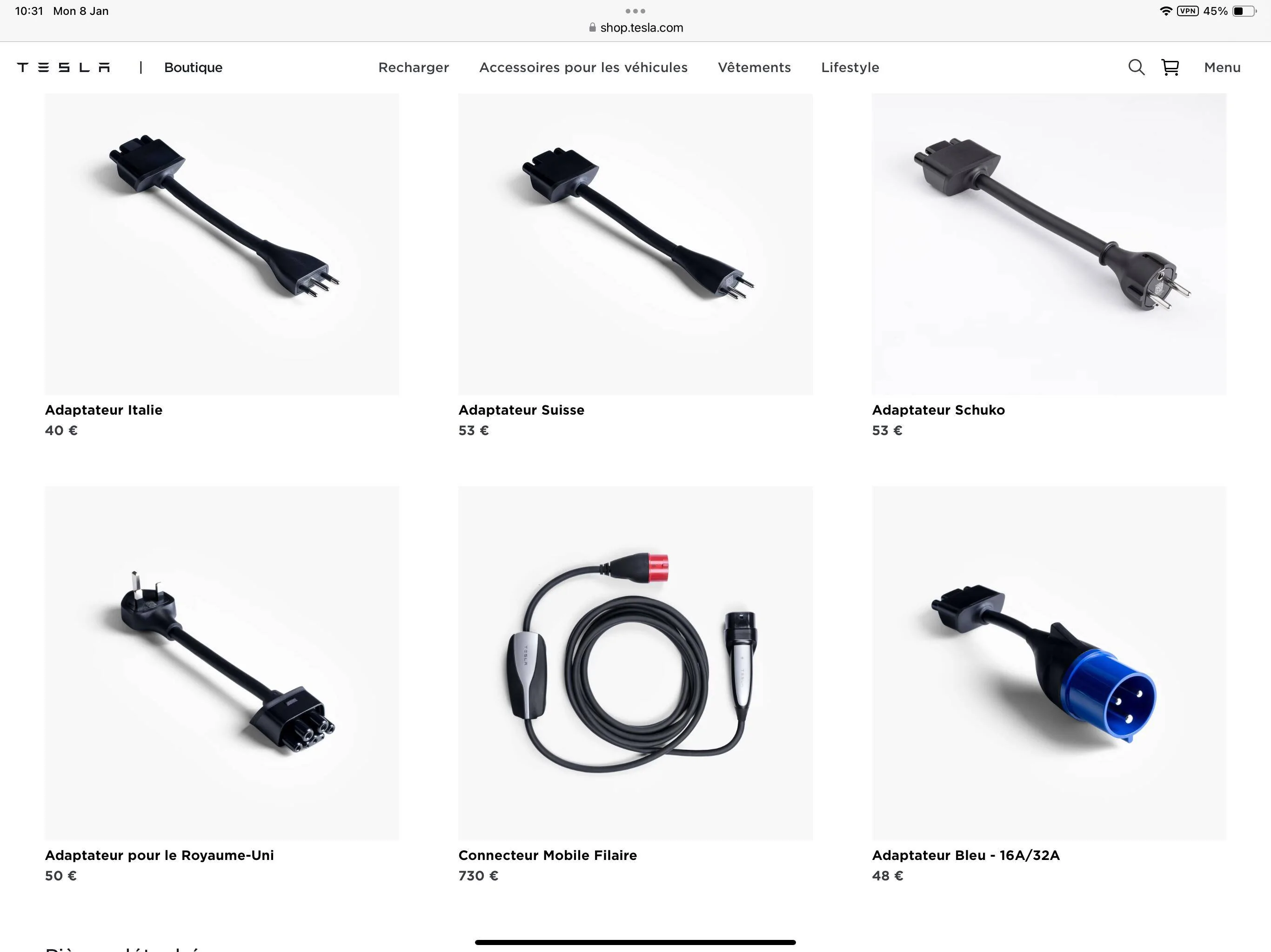

The best value for money unit for us with CCS2 is the Tesla UMC. And then you buy a few extra plugs and you are set for many countries. Works great but is only single phase. Emergency use.
Porsche Taycan Mobile Charger Suggestions IMG_1894
Porsche Taycan Mobile Charger Suggestions IMG_1895
