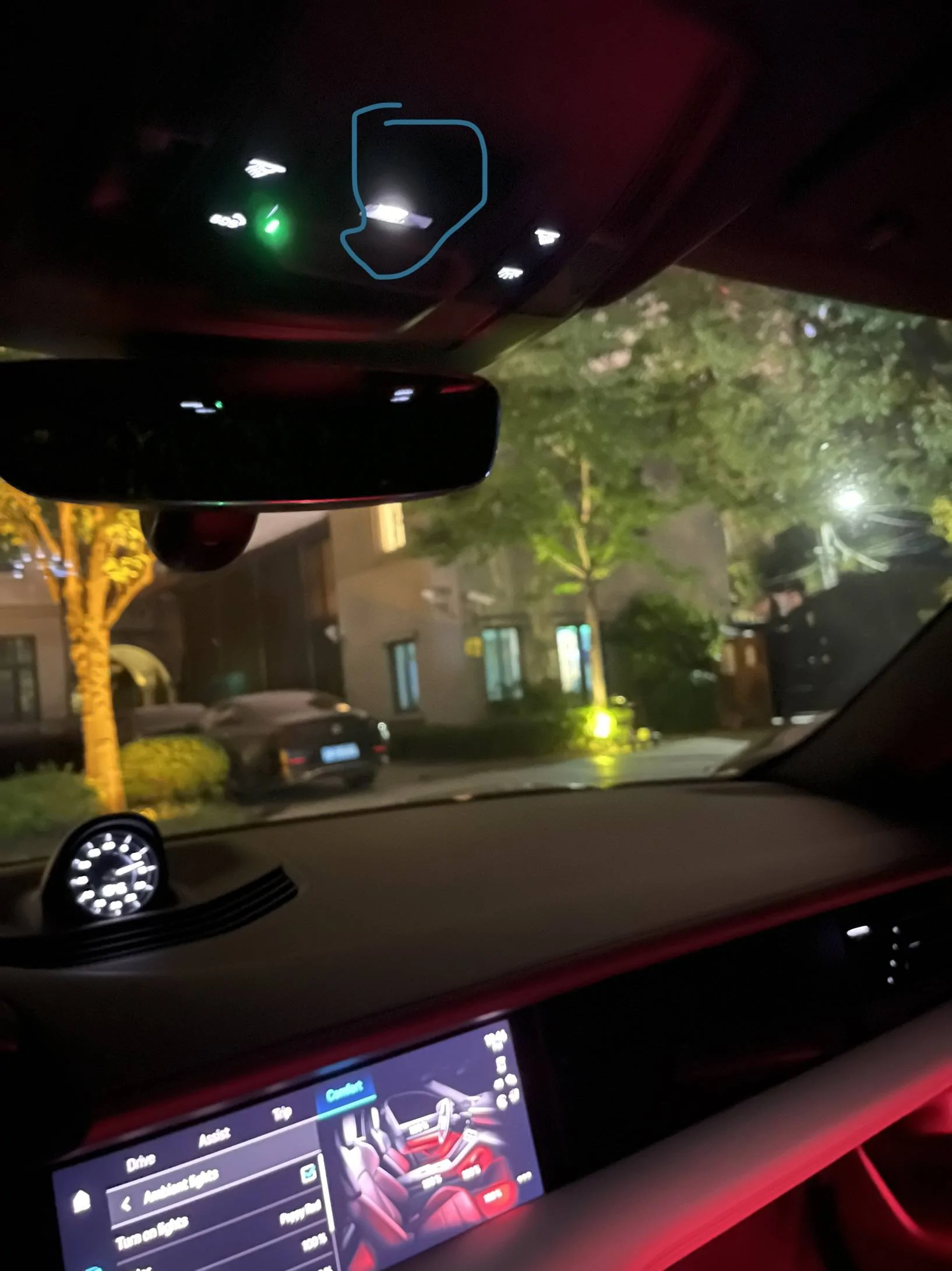

This light is getting the led blackout sticker treatment.
I have my ambient lights set to 100%.
Counterintuitive, I know, but I’ll explain in a bit.

Settings > Car > Light and Visibility > Interior lighting.
That's an additional interior light setting under the Settings app, besides the ambient light setting in the Car app. That setting controls all ambient lighting (including the hidden LED at the top) AND sets the baseline brightness for the displays. At 100% it makes all the displays too bright at night even if you set them to -5.
Set that setting to 5% and that cabin top light will be pretty much off, and your displays will no longer blind you at night when when set to +/-0.
Set it to 0% and the top light will be off completely @npx @DCYL725
