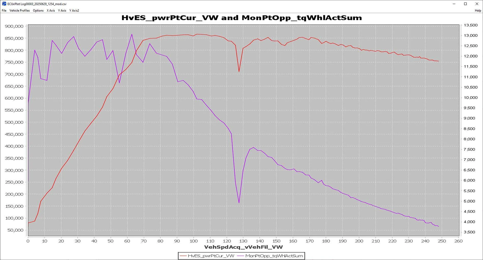

I always set the shift speed optimal. The optimal shiftpoint is generally where the produced power before and after the shift is the same.
Porsche Taycan Part 3: The Quest for the Perfect Tune 1751556636416-ij
E.g. you can see here where the shift is. If you move it earlier, then after the shift the power will drop.
If you move it later then the power will start going down and then after the shift it will go back up.
But like this it's bang on, because the wheel torque basically continues right where it left off and the power is flat through the shift.
This is a Turbo GT log...
On the GTS of course due to different gear ratios and different torque on the motors the shiftpoint is in a completely different place. All this is empirically tested what the best shift point is for each combination.
That said, tuning these is a piece of cake (at least for me, but i've been doing this for two decades) compared to tuning ICE. It's doing all the other stuff like finding an exploit, cloning the ECU, remote flashing, reverse engineering the launch logic etc that is the hard part.

This is the shift point you produced?
That's the stock one on Turbo GT in launch mode. I have to adjust all the other ones though, because they're set from factory for the lower power limits.
For the GTS etc I'd rather not post the shiftpoint graphs. Let any competition figure that stuff out on their own.

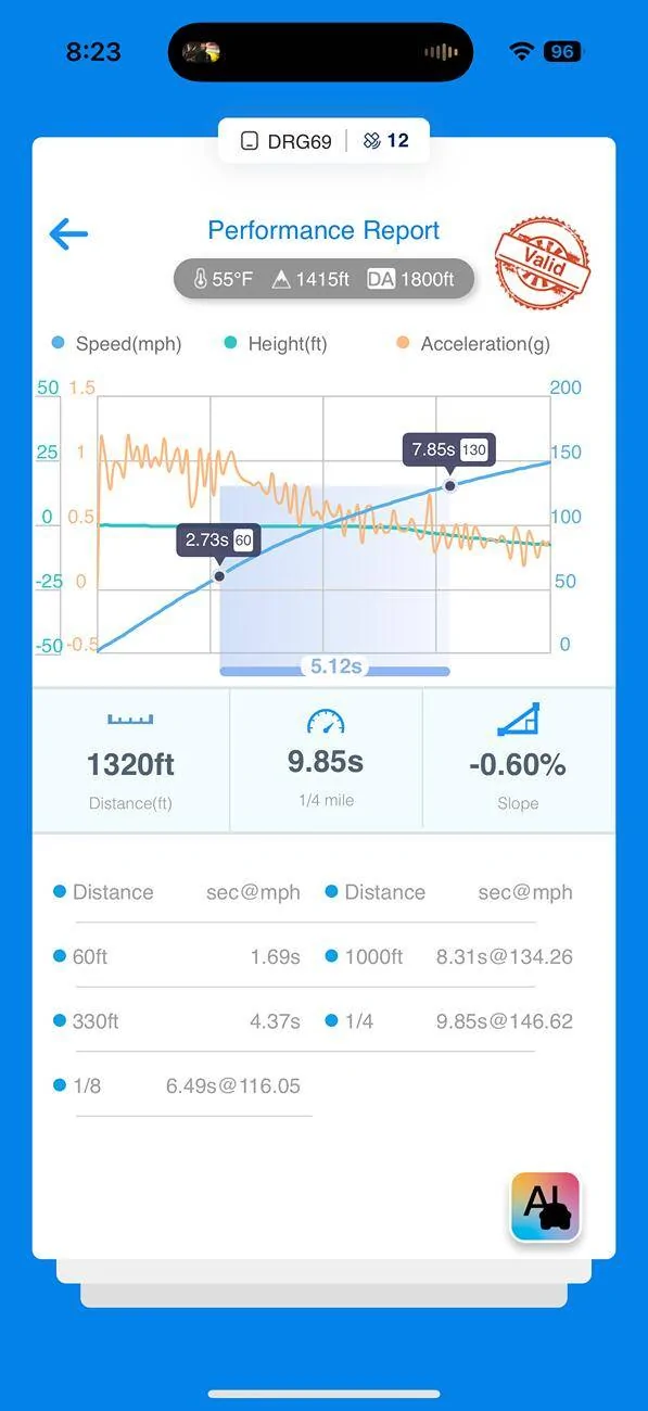

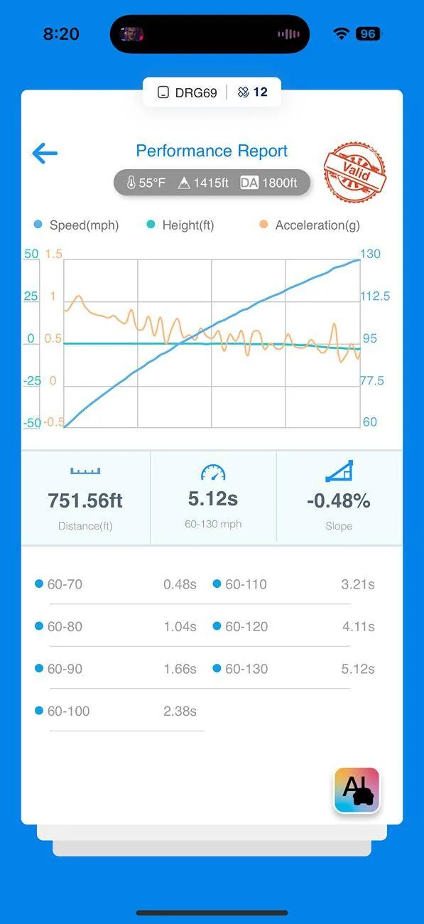

Huge 60-130 improvement on a roll. How does that compare to your Plaid?
Well, the Plaid is my daily driven tyre and dog hauling car so I’ve only done one Dragy test with it since I’ve owned it as I was curious to see how much power was lost due to battery degradation, a hot topic of discussion on the Plaid FB groups lately. With 58K miles on the clock, battery at 98% and battery temperature “peak performance ready”, it ran [email protected] MPH with very crappy and bald tyres. It spun a lot off the line but I don’t believe that affected the 60-130 MPH time of 5.12 seconds. This test was done on the same exact stretch of road where I do my Turbo GT tests.
So, the GT is way faster, but we’re comparing a new car to one with 58K miles… I sincerely hope the Turbo GT doesn’t lose that much power due to mileage and battery degradation. ? Maybe Dmitri can chime in on this one if he knows?
I believe it does affect it. Not by a whole bunch but by a small enough amount. My 60-130 times fluctuate from 4.8-5.2, depending on traction (I am always on the ragged edge due to being a RWD).
Electric doesn't spin much since it is easily mitigated by much more effective traction/torque control management. But it shows in slower times.
I bet your car is 2-3 tenths faster as is with better rubber
