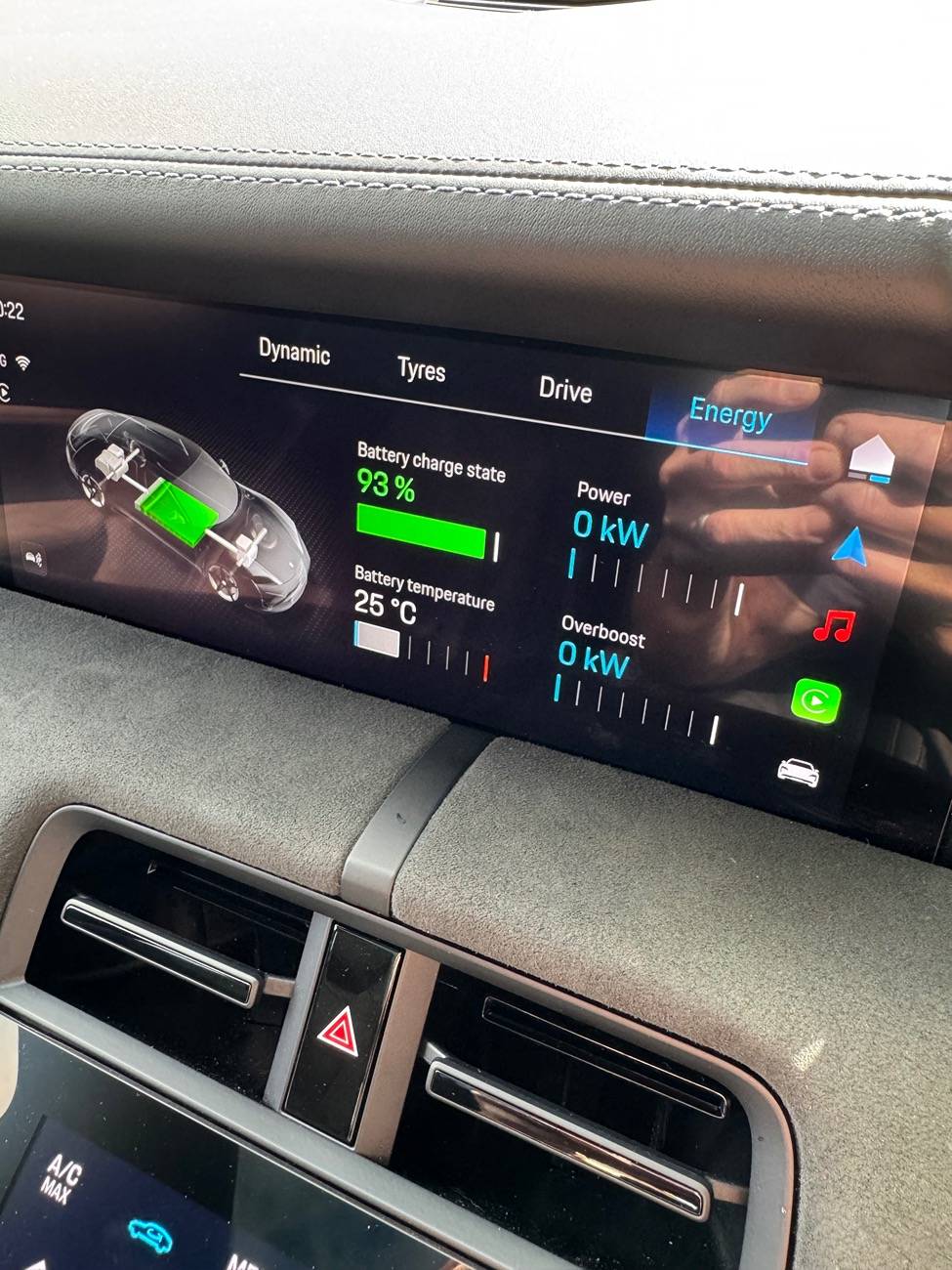

Quick question, will this screen reflect the new higher power levels once the controller is installed? Also something else I’ve noticed, if the push to pass is activated at low speeds (probably the same at all speeds) the suspension becomes rock solid, like much harder than even sports plus. No idea why Porsche did this, i pulled the push to pass lever on the steering wheel by mistake earlier at like 10mph on a bumpy road and the car became nearly undrivable.
It should because the data for that comes from the ASG.
I guess they send out the same request as during launch control. Push to pass is supposed to be a "maximum attack" mode, so it is not surprising they do more than just up the power.
I need to get myself a J1.2 test car for a bit so I can mess with all this stuff, so far I did not have much time beyond doing the development to make it flash in the car and the power tuning, plus porting over the firmware mods that I did for the J1.1.
