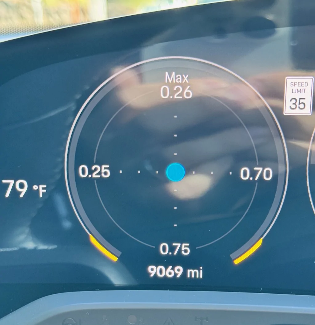

I just did a brief drive with the updated tune, with regen. Attached is the G-meter being freshly reset, the deceleration number of 0.26 G at the top is purely from the regen (no brake pedal applied). It’s much stronger yet smoother than my LR RWD Model 3. It slows the car down to nearly a rest (~2 mph) at which point the car is propelling itself forward (Porsche’s simulation of an automatic torque converter).
Great job @prj on realizing the ability to flash the unit. It’s done in a similar fashion as the original software and using the E-Net cable, MapEV authorizing the unlock on his end with my VIN and flashing being a quick process. The update process was Tesla-esque, though a bit more involved (turning ignition on, pressing button on the PC, turning ignition off, pressing another button on PC, etc) with the car making funny sounds with the ESS and the windows rolling down slightly and headlights adjusting several times. Slightly scary but very cool.
Porsche Taycan Part 3: The Quest for the Perfect Tune regen-g-meter
