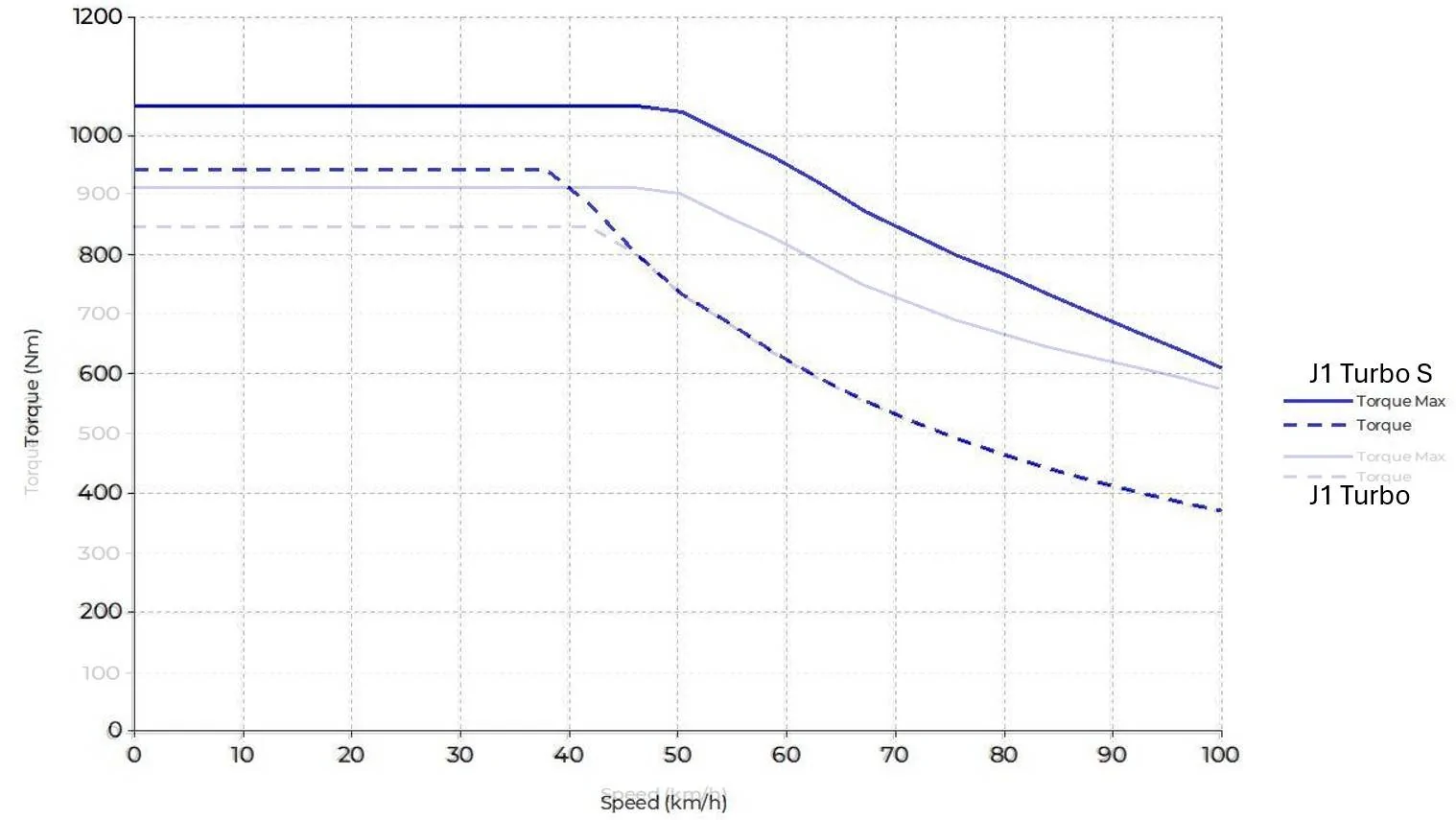

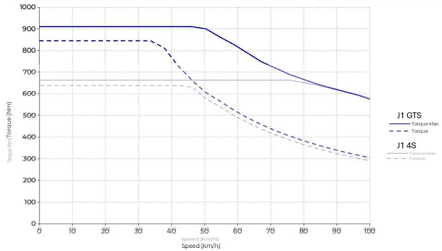

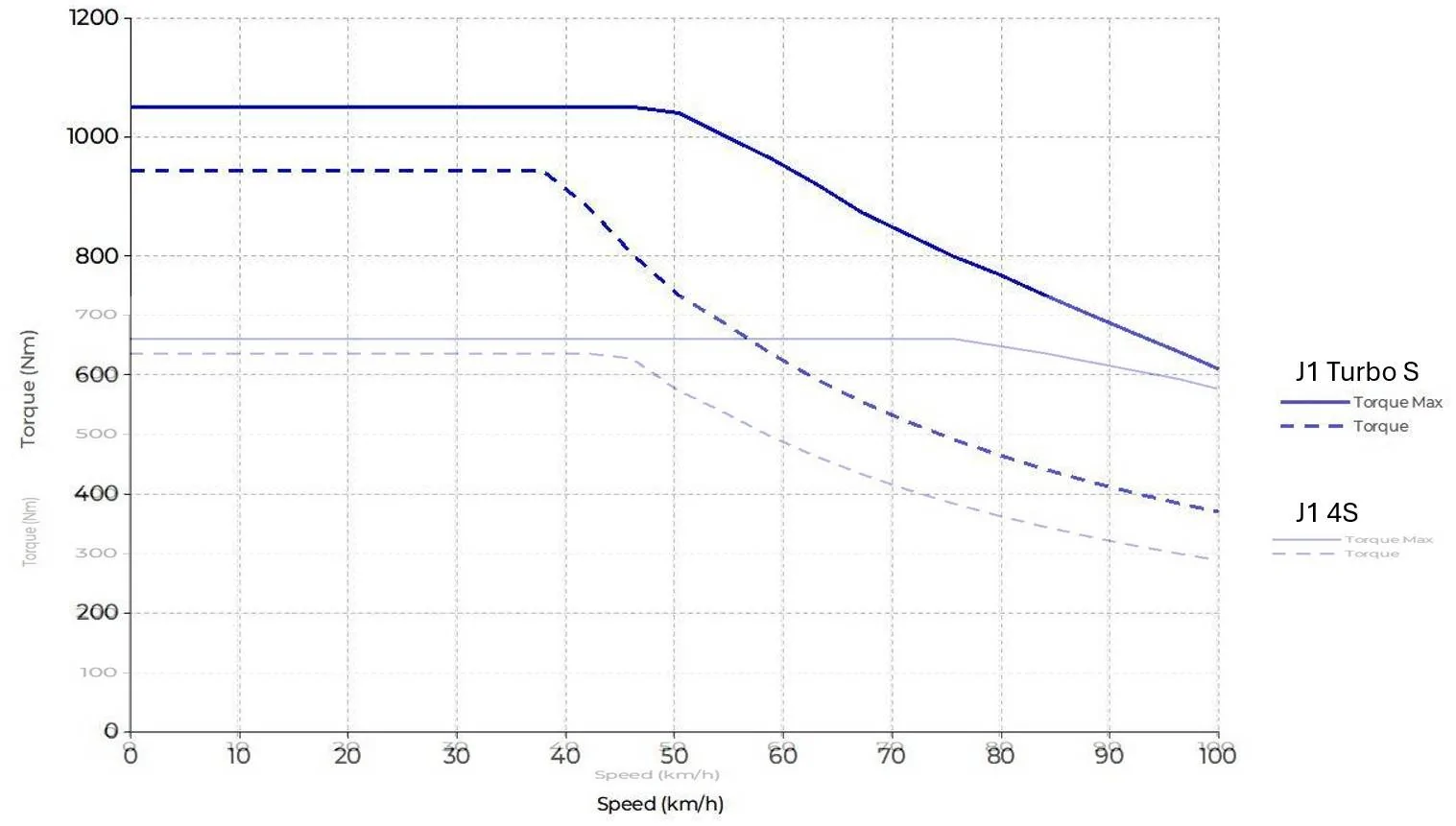

I took the very interesting graphs posted here and super-imposed:
- J1 GTS vs 4S
- J1 Turbo S vs Turbo.
As per OP (@prj)'s explanations, the dotted lines are stock torque, the solid lines max torque available from the inverters. It is quite striking to see in these graphs how there is NO difference (stock) beyond 50kph
Porsche Taycan Part 3: The Quest for the Perfect Tune Taycan-J1-GTS-4S-Torqu
Porsche Taycan Part 3: The Quest for the Perfect Tune Taycan-J1-Turbo-TurboS-Torqu
So 4S to Turbo S ? Massive difference at low speeds, but at 100kph, you only have less than 100 Nm in difference. And with this tune, 100kph and above, you essentially have a Turbo S out of your 4S.
Porsche Taycan Part 3: The Quest for the Perfect Tune Taycan-J1-4S-TurboS-Torqu
If one has limited interest in very low speed acceleration, this puts things in perspective.
Still something puzzles me: why would Porsche leave so much torque on the table in a Turbo S ? is the bottom line that they did not dare in J1 and decided to make that slack (partially, except J1.2 4S) available with push-to-pass in J1.2 ?

Minor fix in your Graphs above & website. Taycan 4 stock maximum torque is only 500nm (not 640nm).
You want the raw values out of the software file? Because that's where it's from. It's 640Nm, no matter what is advertised.
Nothing to fix - how do you think I got these numbers? It's copy-paste straight out of the firmware.
Same like on the Turbo S it's advertised as 761 PS, but my stock Turbo S is making 800 at 100% SoC. Or that the Turbo S/Turbo/RS e-tron GT torque is reported as 850Nm outside of launch control, but actually it's 950 Nm on the Turbo S, 910 on the Turbo and 850 on the RS e-tron GT.
The public horsepower numbers check out, but the torque is wrong on most of the cars. Most likely a marketing move to get you to buy the next model up.
You see from the homologation perspective the only thing that really matters is the continuous power number (which is a small number). The peak power or torque isn't even registered anywhere, so they can be very creative with what they report.
There is no torque left on the table. 950Nm is outside of launch mode. The extra 100Nm is "overboost" available for 2.5 seconds from the moment the launch bit is set on flexray.
In launch the Turbo S runs flat out from factory.
These graphs are outside of launch mode. The standard torque limiters from the software.
Not to be argumentative here but are many people reporting that Taycan 4 is very noticably slower vs a Taycan 4s, even 0-30, 0-50. Isn’t it possible 4 may have the same Invcon limits with 4s, but maybe also torque request is limited by ASG to 500nm? (using the terms we learned from you bere ?) Stock Taycan 4 seems to be uniquely limited compared to other models, and maybe they did this only for this trim? Anyways i don’t own a 4 but read this in so many places so just highlighting.
The stock graph is copy-pasted torque limit out of the ASG (!!!).
Yes, it is much slower, because already from 20mph the torque is faded out.
Have a look at the overlay:
Porsche Taycan Part 3: The Quest for the Perfect Tune 1745672847637-s0
Don't read feels. Trust the actual values out of the stock software.
Here.... go crazy ;)
Maybe this was obvious to some others, but noticed one thing going through this file. Motor Torque difference between 4s/4 vs RWD looks massive (640 vs 340, almost 2x at low RPMs). However if you think about the wheel torque only on 1st gear, difference goes down to less than 1.5X (and less as RPM increases) between 4/4s and RWD. RWD's entire motor torque benefits from the 2X gear multiplication while only ~half of 4/4s torque has the lower gear benefit (front motor has a ratio similar to 2nd gear on rear axle). So it is not easy to perfectly compare Torque/HP between RWD and 4 wheel drive versions. Certainly 4wd versions would still have more wheel torque at low RPMs, however feels like wheel torque of a Tuned RWD could surpass an untuned 4S (in non LC mode), between 80-130 kmh/s, even though 4s would have a higher combined MOTOR torque/HP at that speed.
It is a very odd phenomenon driven by the single/2-speed gear combo set-up.

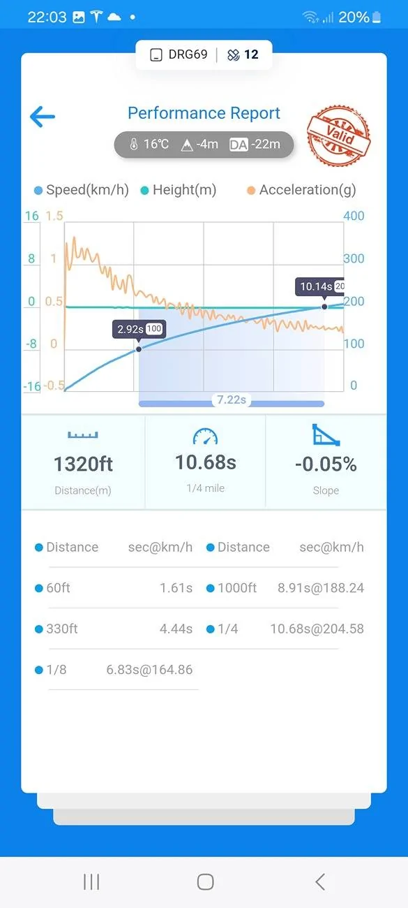

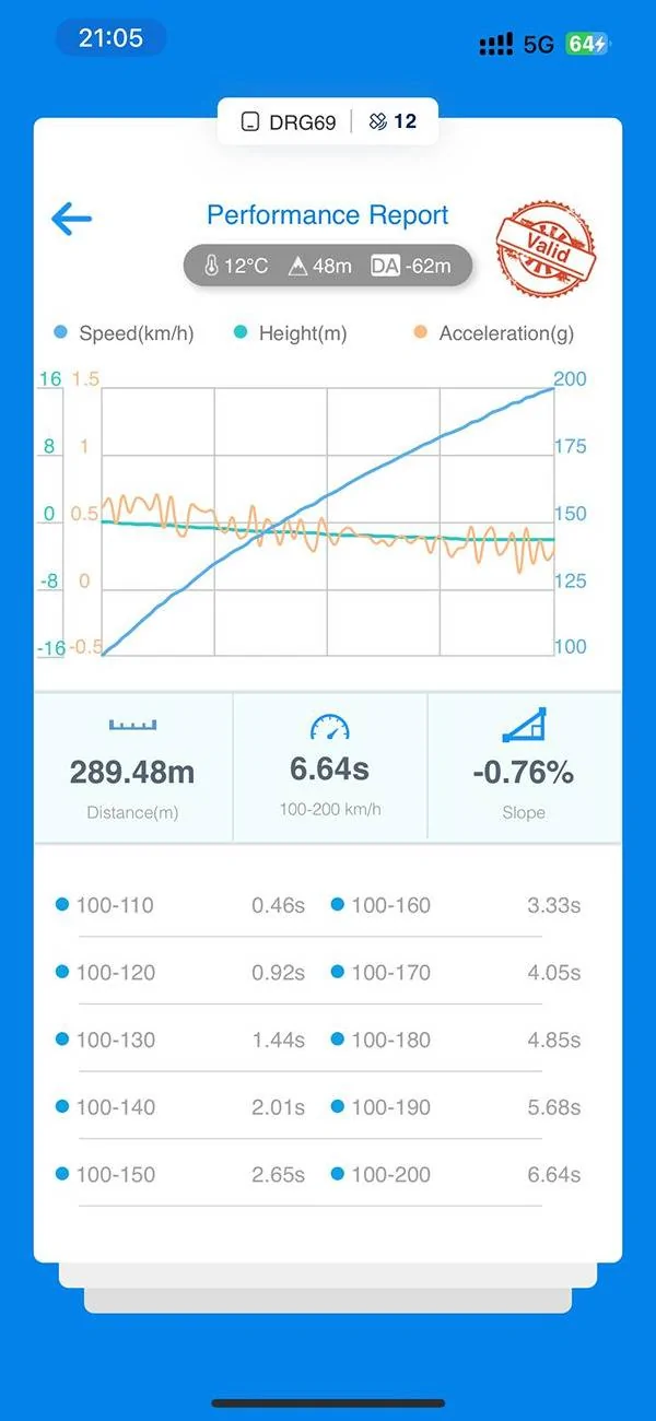

The times look too high. What was SoC?
Here's e-tron GT 100-200 after tuning (not RS!):
Run 1: 87%
Run 2: 81%
LC enabled. Battery temp around 25C
Sport plus LC
Bad time. Curious to see your result as we have the same type of car (22 CT TS). Your tuned, mine stock.
