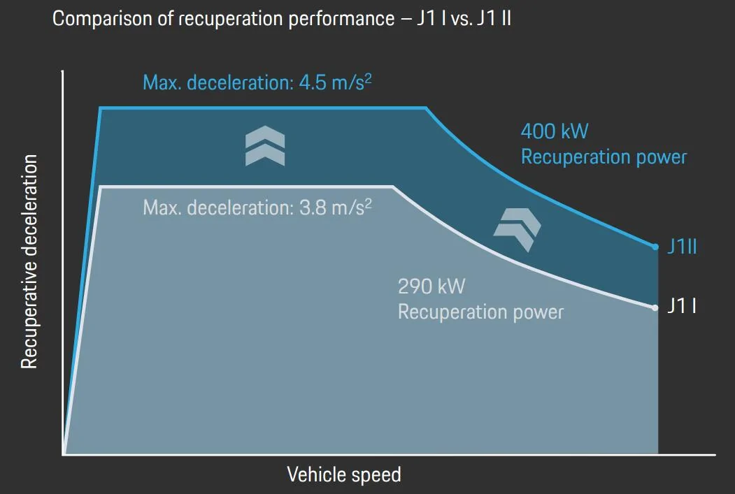

Additionally, because the antisurge damper is calibrated for a tiny amount of regen torque (~50Nm), then when you do sudden on/off throttle transitions it's very uncomfortable, as the engine braking comes in very fast. Couple that together with the fact that you have ~1cm of pedal to control the whole regen area, and it's not great.
Have to re-calibrate a lot of logic there (pedal mapping, torque filtering), rather than slap a % increase on the map to have a good result.
That said, adding e.g. 30-40% works alright, but IMO 30% is barely noticeable... I mean you're going from like 50Nm on powertrain to 65-70Nm, of course it's not really noticeable.
50 Nm sounds unintuitive for a system designed to max at 0.4g of deceleration J1 ?
Or Do we have to multiply by 4 because it is torque per wheel ?
I assume it's 50 before you press the pedal; and once you press the pedal it increases the amount of regen.
I am talking about the miniscule regen torque when you turn the regeneration mode to ON on the steering wheel, and then release the accelerator pedal without pressing the brake, as that is what all the faff is about.
The brake regen is anyway limited by what the battery can accept and the motors provide. And of course it's over ten times higher.
