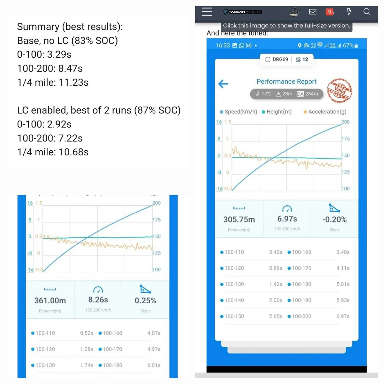

Yes, I am just back from doing that.
The test was done with 85% SoC. Same road, same direction. Slope a tiny bit different because with stock it takes 60 meters more to reach the 200km/h.
Tests done in Sport Plus in both cases, flooring the car at 70kph.
Here is the stock:
And here the tuned:
With 100% SoC it can run 6.8x (I got that before, but I wanted to show the difference in exactly the same conditions back to back). Or if I go a bit downhill... but that's cheating.
Keep in mind, my car is by far the heaviest one - it is a Turbo S CT with absolutely every option ticked, even the rear seat entertainment. This also shows in the stock time though.

The tuned turbo has the same 100-200 as the turbo s? Correct?
i have seen some guys with the tuned etron gt rs(equal to turbo) to have 5.9 seconds 100-200kph! How is that possible?
prj
prj
Jan 14, 2025
1,778
2,369
Estonia
www.mapev.net
Taycan CT 4 - 2026
Yes.
I am not surprised, because one E-tron GT (not RS) that I tuned did a 6.6s. And that makes 730 PS.
I think the first part of the "trick" is that the CT is very heavy.
My car empty weight is 2493 kg according to the papers.
But an e-tron GT RS I checked was 2370 kg.
The second part is that the CT is significantly less aerodynamic than the Sedan. Especially the variant with the Offroad Package like mine is.
And the final part is to go as much downhill as Dragy will let you. So slope closer to -1%. Especially if you pick a road where at start it's significantly downhill, and then at the end it's uphill (because at high speed the aerodynamic drag is more important), and then average is 1%.
After tuning I think the e-trons are the fastest because they are also the lightest. And when using every trick I can believe 5.9s 100-200.
But this is not because the Taycan makes less power or something :)
That's why I showed also before and after time on the same exact spot at the same exact day.
