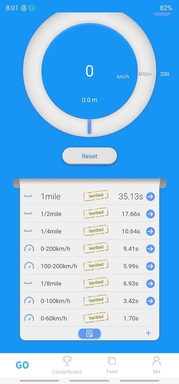

Rik_CT4s
Rik
Aug 6, 2022
394
263
Netherlands
Yes, I am just back from doing that.
The test was done with 85% SoC. Same road, same direction. Slope a tiny bit different because with stock it takes 60 meters more to reach the 200km/h.
Tests done in Sport Plus in both cases, flooring the car at 70kph.
Here is the stock:
And here the tuned:
With 100% SoC it can run 6.8x (I got that before, but I wanted to show the difference in exactly the same conditions back to back). Or if I go a bit downhill... but that's cheating.
Keep in mind, my car is by far the heaviest one - it is a Turbo S CT with absolutely every option ticked, even the rear seat entertainment. This also shows in the stock time though.
In sum for the Turbo S CT (MY22). @prj ran @ 85% SOC, and my run @ between 80-85% SOC. We drive exactly the same car type. Also fully loaded here, except entertainmaint in the back that PRJ has. I drove it on 22 inch Vossen.
I guess the most interesting is to compare no launch no tune (as most have) versus the tuned status (no launch, but with the launch patch, and tuned). This will show the most realistic day-to-day situation. Correct me if I am wrong.
When LC no tune is used, the difference with the tuned version is much smaller.
Benefits would be sprints without LC
100-200kmu is unfortunately not impressive, but that is the limitation of the battery/inverters, not because of the tune.
