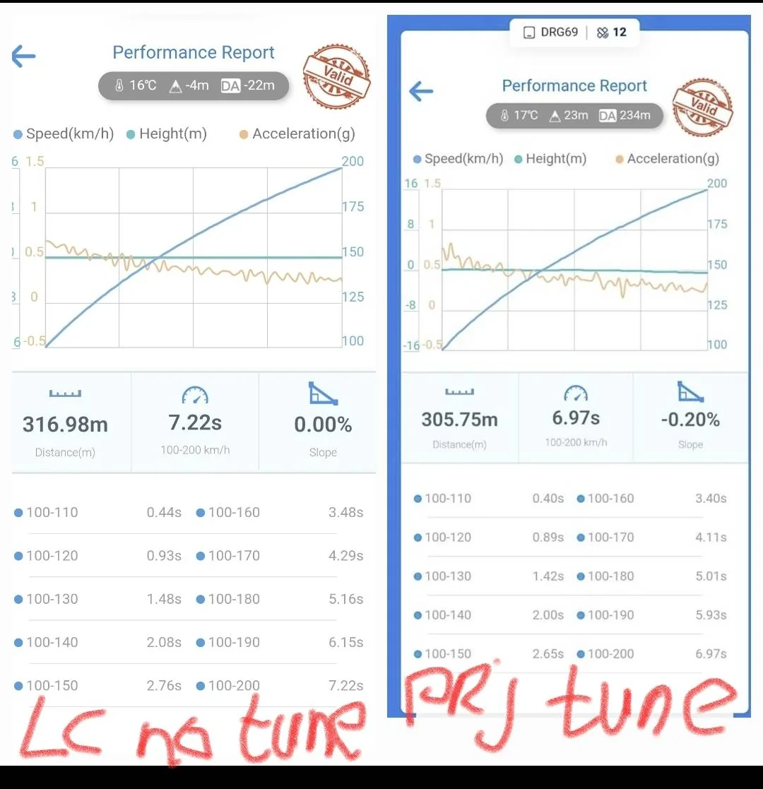

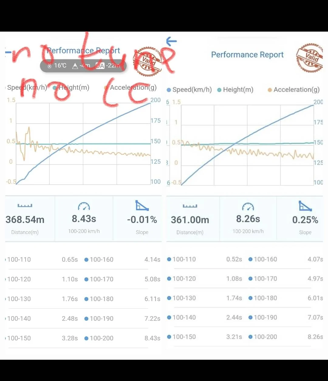

LC no tune/my tune should be pretty similar.
The Turbo S can't be any faster in LC than it is from factory because it just runs battery/inverter limit all the time already stock.
TBH LC is useless 99% of the time. You're not gonna stop your car, then go into LC and launch it when you want more power while you're already moving.

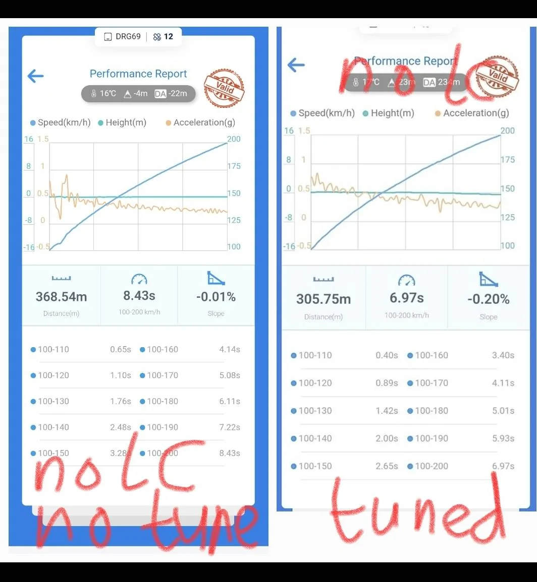

Fully agreed.
Any chance to improve the tune after say 160kmu....thereafter it is dramatic....up to about 160kmu it is quite impressive but then the party trick ends suddenly :(
Or it this just limited by the hardware.

Fully agreed.
For the final time, it's running hardware limit. Probably said it 100 times now :D
If you don't like it get an e-tron, they seem to be more slippery. Of course it's possible to flash the BMS and get 1000hp. Side effects may include a hot tingling sensation in your feet from the battery fire.

out of curiosity, you see the shift from 1st to 2nd gear (acceleration and speed "bump") in the no LC/ no tune, but never in the other runs.
why ?
Well, I still had my tune on it, just the torque limiter was changed to the standard one, shift maps still optimized. And stock the shift point also depends on which mode you are in. In mine it is set to the optimal speed in all modes, and that's below 100km/h for the Turbo S.

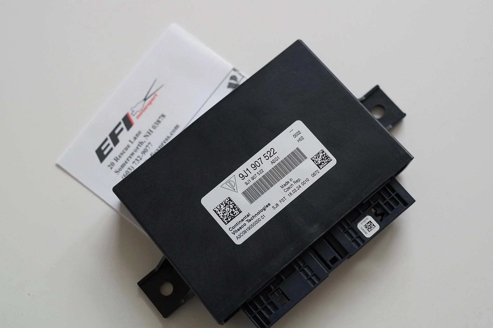

I received my package containing the tuned ASG for my Taycan 4 CT today. After confirming receipt of my vehicle data, @prj shipped quickly through the US distributor and it arrived in 1 week. I'm excited to install it in my car but it will be serviced at the dealership until the end of the month.

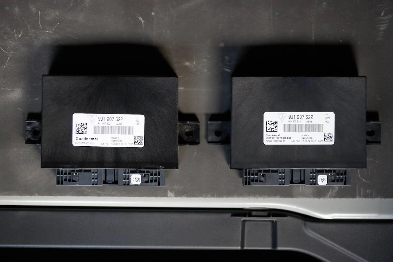

(My service appointment was pushed back so...) tune installed!
Porsche Taycan Part 3: The Quest for the Perfect Tune 1
(left) original ASG
(right) MapEV tuned ASG

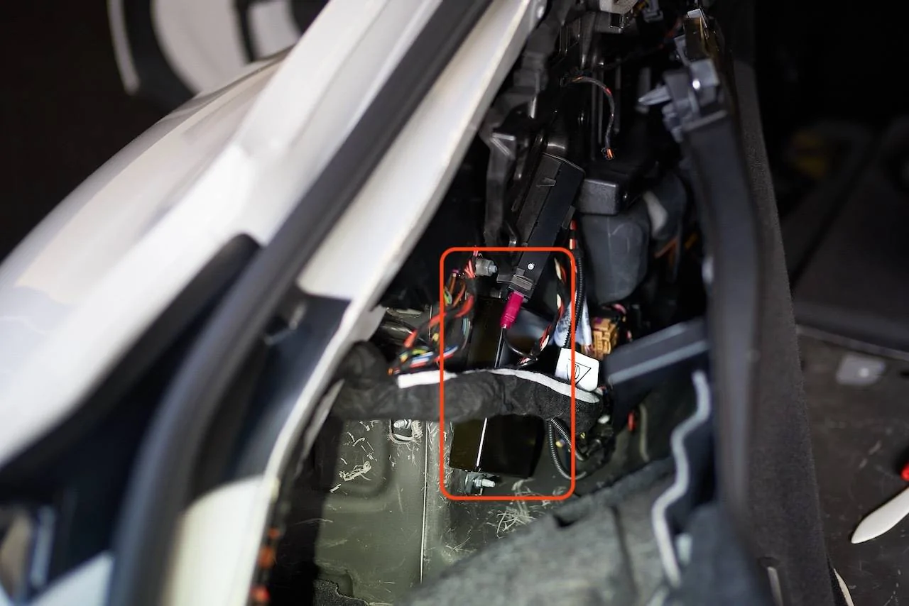

I watched the ASG removal video posted by @prj in the OP a couple times and went for it. I highly recommend watching the video for those installing the tune- it's spot on. Don't skip a step as you'll need all the room you're going to get to access the unit and avoid damaging clips and panels. I would also recommend:
- you must have the M8 triple square socket (seems uncommon in the US, has to be special-ordered on Home Depot; I got it next day from Amazon); I attempted using a close-fitting torx bit and it would have ruined the thread if I applied more force.
- a flashlight (to inspect for stuck clips)
- pliers (to remove 2 stubborn metal clips in the speaker cover that using 2 flat screwdrivers could not extract)
- a damp rag (see below)
Porsche Taycan Part 3: The Quest for the Perfect Tune 3

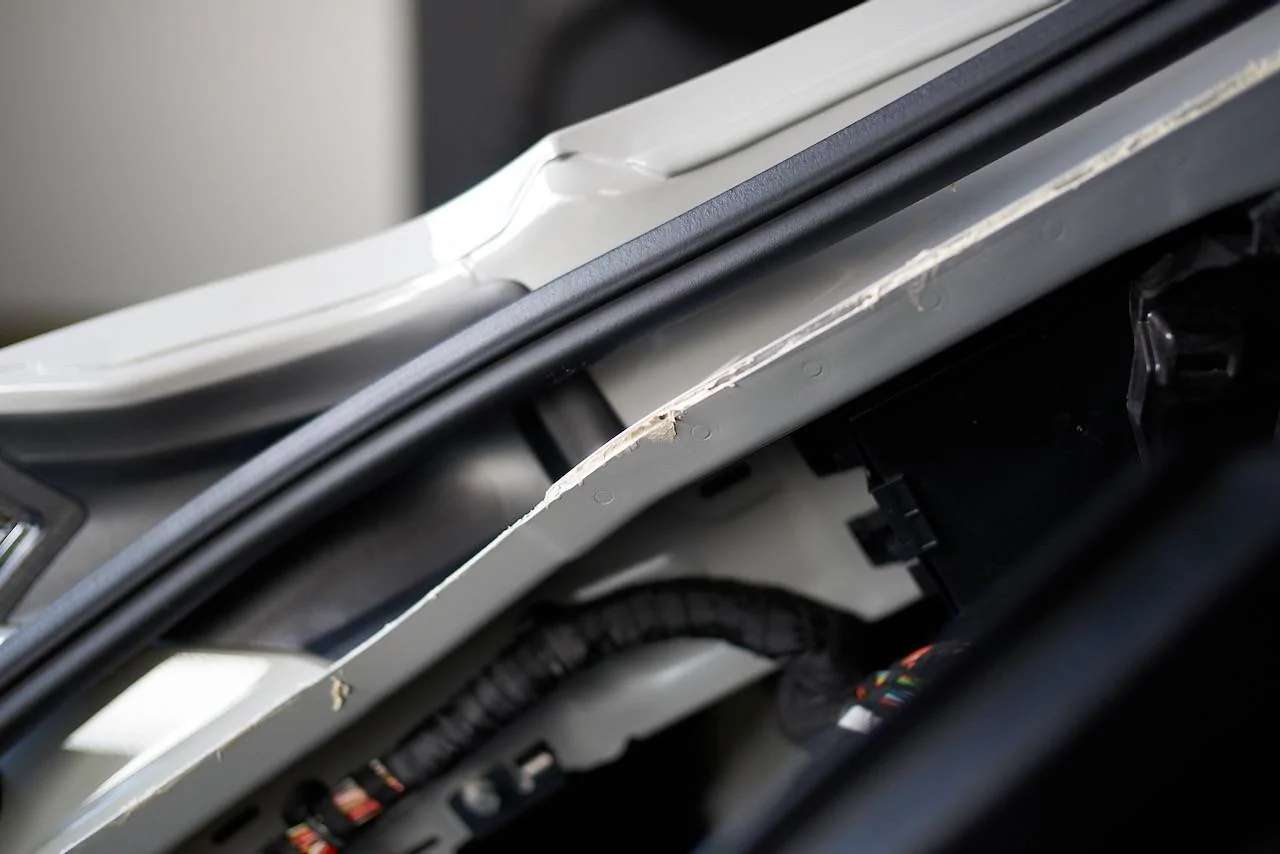

as you pull the rubber weather seal, try to avoid contact with the sticky paste, and don't transfer it to your roof liner or cleanup will be a chore. My Cross Turismo is Chalk and it was not obvious to me that I was touching it with my arms and had to return to the kitchen faucet a few times to soap/rub it off.
Porsche Taycan Part 3: The Quest for the Perfect Tune 4
The red-bordered box is the ASG. The bolts are very lightly tightened.
Apart from 1 or 2 slightly-bent plastic clips, no damage to trim. After some wiping down, the panels and trim look untouched and good-as-new. All the connectors used by Porsche that I encountered are durable; it was surprising coming from my old Tesla which had numerous plastic connectors that would easily break and need replacement prior to reinstallation.

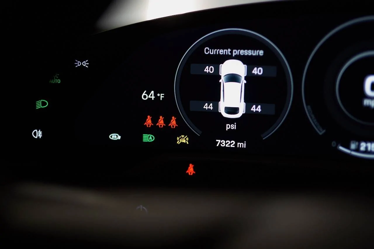

@prj mentioned this to me by email:

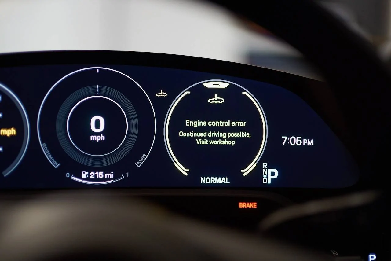

"please keep in mind that the first time you turn on the ignition with the new module, you will receive a yellow warning message on the dashboard. This is completely normal, as the ASG is brand new, and needs to learn the VIN of the car. As soon as you turn off and turn the ignition on again the ASG will learn the VIN, the error will disappear and will never appear again. After that just clear the fault codes using MapEV Diag."
and like the first boot animation you get on a new PS5- I had my camera ready the moment the car was turned on.
Porsche Taycan Part 3: The Quest for the Perfect Tune 2
waited a few seconds, used the power off button; waited a few seconds, turned on the car and warning message is gone.

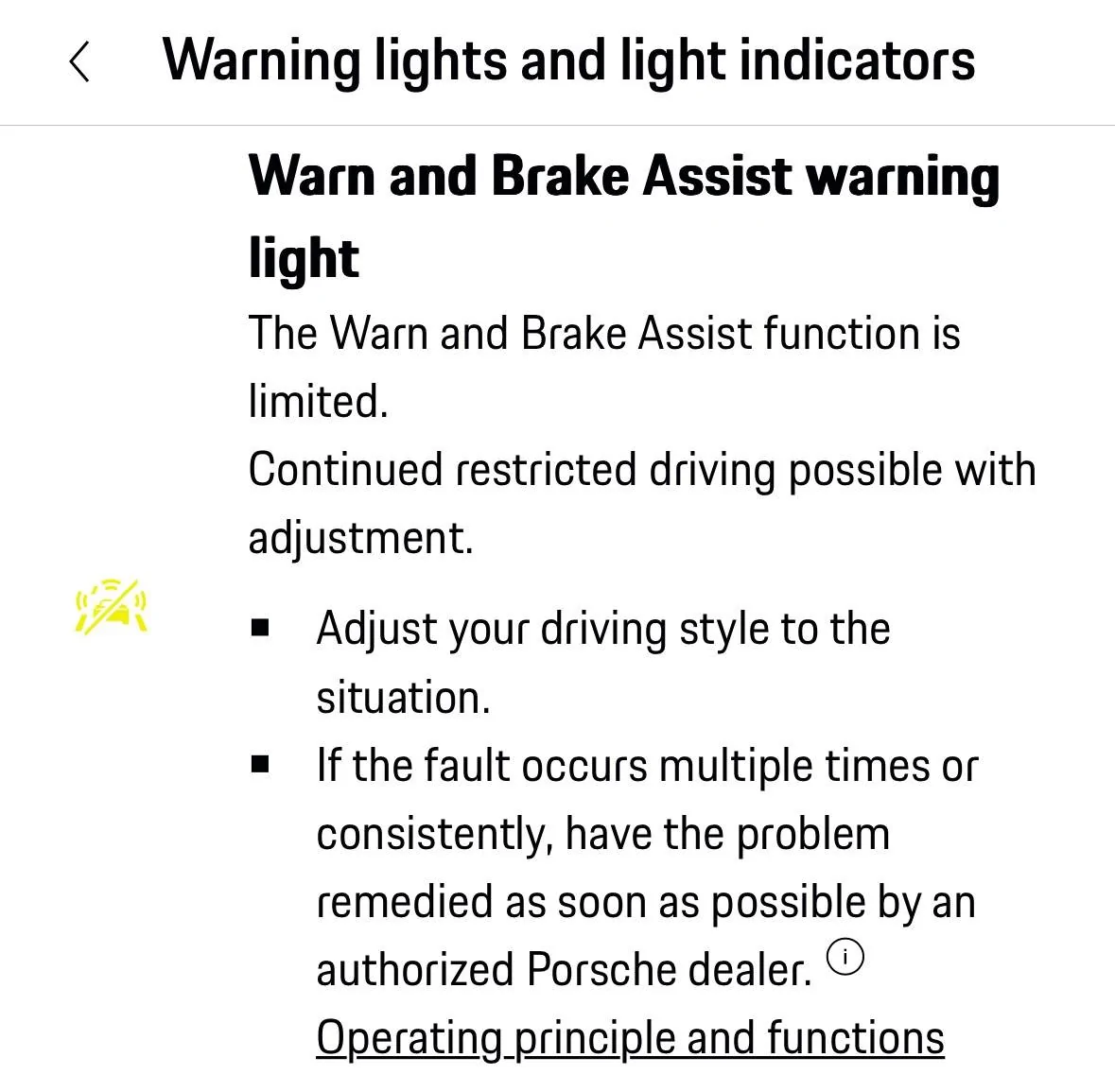

@prj I think this yellow indicator is new after the tune (but not sure, I'm only into a few weeks of Taycan ownership). When starting the car each time, the "Warn and Brake Assist warning light" appears for a few seconds, then I never see it again for the rest of the drive.
If I am not mistaken that always happens.

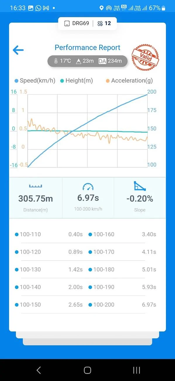

I have a dragy on order and hope to post those results soon.
We did get a 6.6s 100-200 on an e-tron GT, which has the same power after tuning, but it's much more aerodynamic than the Taycan, especially than a Cross Turismo with Offroad Package, so I would not expect those numbers. Probably 7.3-7.4 or so is what it will do.

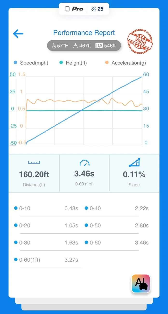

dragy 0-60 mph result on my 2022 Taycan 4 CT with MapEV tune (on 21” all-seasons, 61% battery SOC), using Sport Plus, no launch control
