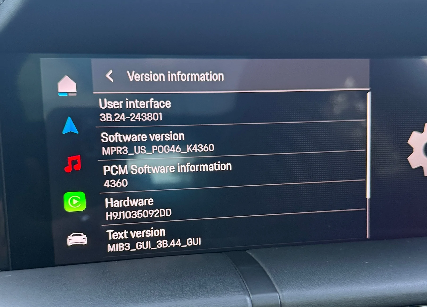

I had an issue with my 25 Taycan where it lost connectivity to the app for over 10-12 days. Two finger reboot, app relogin, fuse resets, etc didn’t help. Took it to the dealer for latest software update and apparently it fixed the issue for few hours.
App connectivity lost as of around 9pm est today. Also the 2 finger reboot no longer works with the latest software :(
Coming from model S, I really miss Tesla’s software and the app, nothing comes even close.
I guess I will have to take the car back to the dealer for such a minor issue that really should be addressed remotely.
